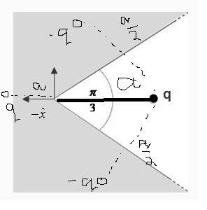

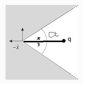

Hi,
I'm trying to use image charges to find the force that apply on the following particle (on the attachment) , but it seems that I do something wrong -
[itex]F=2q^2/(2a^2)-2cos(60)q^2/a^2[/itex]
The gray section have 0 potential, so I've tried to put image charges like it is in the second attachment file.
Can someone help me?
Thanks,
Adam
Graphics can help. But you must descript all the letters significance.¡¡¡ We are physics, not engineerings
Sorry...
The upper and the lower charges are negative while the two middles are positive.
