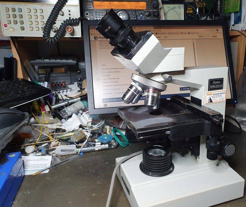

1600x is probably a stretch for any microscope unless it's a professional and costly one
Most of the average ones up to ~ $500 wouldn't have useable magnification over around 400x
1000x + would require excellent optics that wouldn't come cheap
Even the professional one I own (approx $2500) doesn't perform well much over around 1000x
MODELUnilux-12
MAGNIFICATION RANGE (STANDARD)40x-1,000x
DUST COVER (CONTRASTS)Standard
OCCULARS
Type (CONFIGURATION)Binocular, inclined
Eyepieces (OCCULARS)10x, widefield
Interpupillary distance adj, mm (OCCULARS)54to 74
