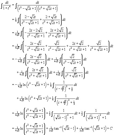

There was a long thread on this a while back. Can't find it though. Another strange one I've found (similar to one posted above) is:
[tex]\int\frac{1}{1+x^4}\,dx[/tex]
You have to use that fact that x4+1=(x2+1)2-2x2. And then use the difference of two squares. It gets messy.

Yes, that fact indeed. Read attached gif, see what is meant.
