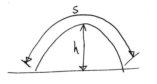

The original poster seeks to determine the angle required to launch a projectile such that its maximum height equals the length of its arc. The context involves projectile motion, specifically from ground level using a pea shooter or slingshot.
- Exploratory, Assumption checking
- Participants discuss the nature of projectile motion and the equations governing it, including the elimination of time to express height in terms of distance. There are inquiries about the relationship between angles and the conditions under which height might equal arc length.
Some participants have provided insights into the parabolic trajectory of the projectile and the equations of motion involved. However, there is a recognition that the original question may contain assumptions that lead to contradictions, particularly regarding the relationship between height and arc length.
There is uncertainty about the interpretation of "length of arc" and whether it refers to the actual path length of the projectile. Participants are questioning the validity of the original poster's premise and the source of the question.
