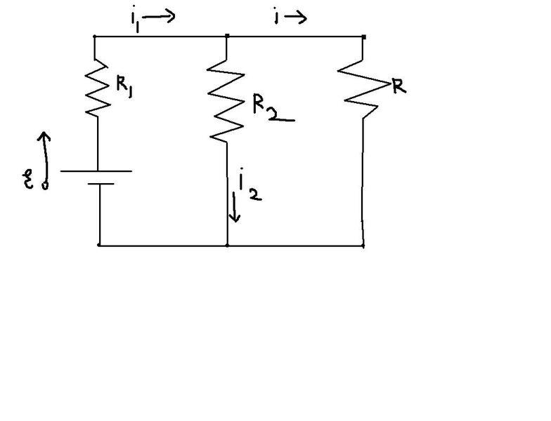

In the circuit, E, R1 and R2 have constant values. However R has a variable value. FInd an epxression for R that results in the max power dissipation in that resistor.
so do i do this
[tex]i_{1} = i + i_{2}[/tex]
[tex]E - i_{1} R_{1} - i_{2} R_{2} = 0[/tex]
[tex]E - i_{1} R_{1} - iR = 0[/tex]
[tex]i_{2} R_{2} - iR = 0[/tex]
not too sure about the last one...
and the power dissipation in that resitor is given by [tex]P = i^2 R[/tex] But to find the max power dissipation do i plug that expression for i back into the above expression and then differentiate OR sub i into this
[tex]\frac{dP}{dR} = 2iR + i^2[/tex]
i used a sample value for i and got different values for the derivative. Which is correct?
Please help!

You should use your Thevenin equivalent and Norton equivalent for this one - unless they're making you do this using differentiation and limits at least once just to make sure you truly appreciate Thevenin and Norton equivalents.
