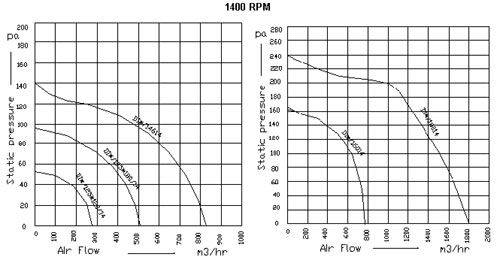

Hi ameeno97,
There could be some confusion here. I believe I understand what you're trying to say but I don't think my understanding is the same as Russ might have.
To help clear this up, let's talk about a very simple system. We have a blower of some sort taking air in from atmosphere, pushing it through a pipe, there's a damper somewhere on the pipe, perhaps some other stuff which we'll neglect for now, and then the pipe opens back to atmosphere. So the air pulled in by the blower from atmosphere is returned to atmosphere, but it travels through a pipe and through a valve or damper.
Let's also assume for any given case, we allow the system to come to equilibrium such that the flow through this system is at a steady state. In this case, the continuity equation applies.
If we use this model we find that for any given damper setting, the mass flow rate through any part of the system is constant. In other words, using your example of a valve, at both point 1 and point 2, the mass flow rate is the same. If that valve in the picture you have represents a damper instead, it's the same thing. The flow at point 1 and point 2 is the same for any given flow rate. Remember, we're talking about a system that has come to equilibrium so the flow doesn't change at any point in the system.
Now let's say we have this blower running and you start closing the valve or damper. The valve or damper restricts flow, so the pressure drop across this restriction increases. So as you close the valve/damper, the pressure difference between points 1 and 2 increases.When you do this, the flow through your blower will (generally) decrease. Blowers (centrifugal machines, squirrel cage blowers and similar) are not positive displacement. They are rotodynamic machines, so there will be a 'flow curve' that applies. That flow curve looks something like the below picture. Note that it has a flow rate on the X axis and pressure on the Y axis. In other words, as the blower is forced to increase the pressure (dP across the blower), the flow rate it produces will drop. So as you pinch down on your valve or damper, the static pressure in the line increases and the flow that the blower can create decreases.
Again, once you come to equilibrium, once the flow is steady state, the continuity equation applies and the flow rate past any point in your piping is constant (assuming there's only one pipe, it doesn't split, there is no stored mass anywhere, etc...).
Anyway, I think that's what you're getting at. If not, perhaps you could be a bit more specific.
