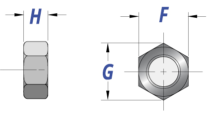

Find a nut that fits and look up id thread specs

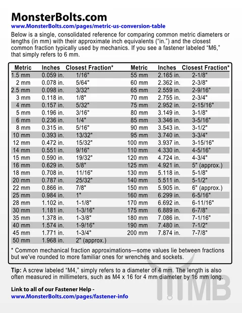

There are few metric or imperial shaft sizes, so there are few bearing inside diameters. The outside diameters depend on bearing construction, so are more variable. The housing is machined to fit the bearing OD.
For example, without vernier callipers, it is hard to tell the difference between metric 45 mm shaft and a 1.75" shaft, or a 50 mm shaft and a 2" shaft.
0.75" is 19.05 mm, but 19 mm is not a metric standard, it would be 20mm.
Bearings have been standardised. If there is a bearing on the shaft, read the part number, then look that up in the data provided by any manufacturer. Just to make it interesting, some bearings have a metric shaft, but with an imperial OD.
