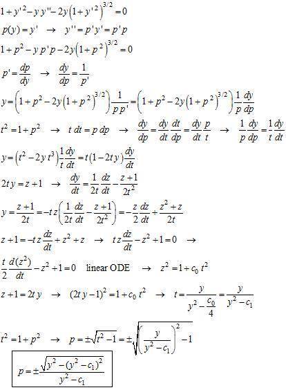

Hi,
I derived the equation:
[tex]1+(y')^2-y y''-2y\left(1+(y')^2\right)^{3/2}=0[/tex]
Letting [itex]y'=p[/itex] and [itex]y''=p\frac{dp}{dy}[/itex], I obtain:
[tex]\frac{dp}{dy}=\frac{1+p^2-2y(1+p^2)^{3/2}}{yp}[/tex]
I believe it's tractable in p because Mathematica gives a relatively simple answer:
[tex]p=\begin{cases}\frac{i \sqrt{-y^2+y^4-4 y^2 C[1]+4 C[1]^2}}{y^2-2 C[1]}\\<br /> \\<br /> -\frac{i \sqrt{-y^2+y^4-4 y^2 C[1]+4 C[1]^2}}{y^2-2 C[1]}<br /> \end{cases}[/tex]
I don't see how to get to that answer and I was wondering if someone here could help me with this.
Thanks,
Jack

Try the substitution
$$ w = \frac{\sqrt{1+p^2}}{y}.$$
You should find that
$$ \frac{dw}{dy} = -2y w^2,$$
which is separable.

Hi !
A laborious method below :
  • Handwritten-style step-by-step derivation solving a nonlinear second-order ODE with substitutions p(y)=y' and t^2=1+p^2, ending with the boxed result p = ±sqrt(y^2-(y^2-c1)^2)/(y^2-c1).

You guys are just shear art in here. [itex]\frac{dw}{dy}=-2w^2y[/itex] was tough for me to go through but I got it. Still working through Jacquelin's. I'm sure it's correct though. :)
