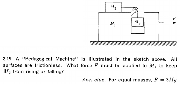

I'm trying to solve this problem from Kleppner and Kolenkow:
But I seem to be missing something because my answer doesn't match the clue. I have worked out the entire problem but I want to focus on the physical content so I'll just show my force equations below. I think the mistake is with one of them because I've checked my algebra in the rest of the problem several times.
##F=ma##
I chose coordinates ##x## pointing to the right and ##y## pointing upward, stationary relative to all of the masses.
Mass 2 - vertical forces
We have an upward normal force of ##N_2## and a downward weight of ##M_2 g##. This mass does not accelerate vertically, so ##N_2 = M_2 g##.

The only horizontal force on ##M_2## is the tension in the rope. I call it ##T##. It is pointing to the right and satisfies ##T = M_2 \ddot x_2##.
Mass 3 - vertical forces
This mass is acted upon by the same tension ##T## in the upward direction, and weight ##M_3 g## in the downward direction. Thus, ##T - M_3 g = M_3 \ddot y_3##.
Mass 3 - horizontal forces
I assume mass 3 is touching the walls of the slot in which it is situated, so there are normal forces from each wall. I denote these by ##N_3## pointing rightward and ##N_4## pointing leftward. Thus, ##N_3 - N_4 = M_3 \ddot x_3##.

Mass 1 is acted upon by downward weight ##M_1 g##, and upward by the normal force exerted by the floor, ##N_1##. It is also acted upon by the downward normal force ##N_2## due to the weight of mass 2. Thus, ##N_1 - N_2 - M_1 g = 0##, where the right hand side is zero because mass 1 is not moving vertically.
Mass 2 - horizontal forces
Mass 1 is acted upon horizontally by the applied force ##F## in the rightward direction. It is also acted upon by the same normal forces as mass 3, but in the opposite directions, so ##N_3## points leftward and ##N_4## points rightward. Thus, ##F + N_4 - N_3 = M_1 \ddot x_1##.
Constraints
Note that mass 3 is constrained horizontally so that it moves in lockstep with mass 1, so ##\ddot x_3 = \ddot x_1##.
Also, the rope connecting masses 2 and 3 causes them to move in lockstep. The horizontal motion of mass 2 relative to mass 1 must match the vertical motion of mass 3. Thus, ##\ddot x_2 - \ddot x_1 = -\ddot y_3##.

As I mentioned, if I work out the problem to completion, my answer does not match that of the clue. Moreover, I think the error is conceptual, not algebraic. For suppose I combine the Mass 3 Horizontal equation with the Mass 2 Horizontal equation:
$$N_3 - N_4 = M_3 \ddot x_3$$
$$F + N_4 - N_3 = M_1 \ddot x_1$$
Add these together to obtain
$$F = M_1 \ddot x_1 + M_3 \ddot x_3$$
As noted above, we have the constraint ##\ddot x_1 = \ddot x_3##, so this reduces to
$$F = (M_1 + M_3) \ddot x_1$$
This seems wrong, because the total mass in the system is ##M_1 + M_2 + M_3## and surely ##F## must push all three of these in order to accelerate mass 1. So I think this should be ##F = (M_1 + M_2 + M_3) \ddot x_1##. But I can't see the where my error is.
Oh, wait a minute. I didn't take into account the forces on the pulley, which is attached to ##M_1##. Thus ##M_1## has an additional horizontal force, ##T##, acting leftward, and an additional vertical force, ##T##, acting downward. The fact that I didn't have "equal and opposite" forces somewhere in the system to balance the ##T## forces I had already identified should have raised a red flag. I'll rework this and post a revised set of equations, might have to wait for tonight because work calls. :-p
What you are doing will get there in the end, but the "trick" with this sort of problem is to spot questions that have easy answers, for example
From the kinematics of the machine, if M3 does not move vertically, how does M1 move relative to M2?
If M3 does not move vertically, what is the tension T in the string?
Knowing the tension T, what is the acceleration of M2 relative to the ground?
It's not necessary to consider the movement of M1 in the problem. When I first did a version of this problem, I used only M2 and M3 ;).

OK, after adding the missing forces, the answer came out right, and I also got the expected ##F = (M_1 + M_2 + M_3) \ddot x_1## when ##\ddot y_3 = 0##. The general equations with ##\ddot y_3## not necessarily equal to zero were pretty heinous and unenlightening.
