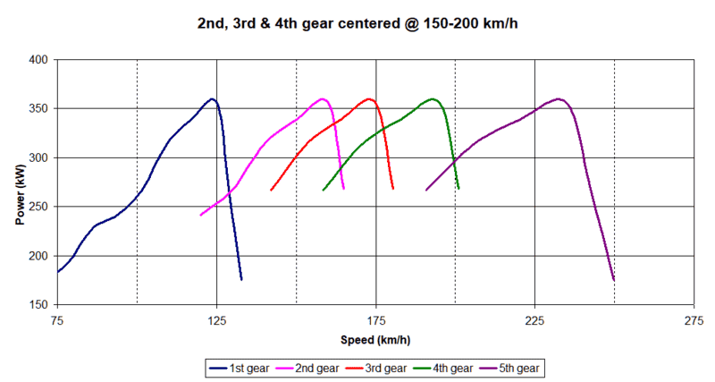

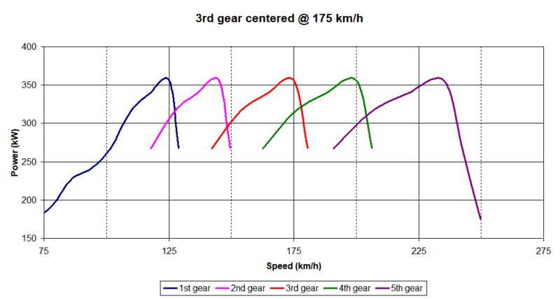

      Huh. That graph makes me wonder why 5th gear even exists. There's almost no time in which you'd want to be in 5th.

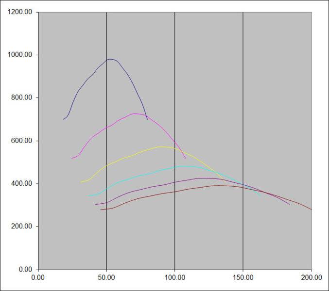

      Torque versus rpm versus gear for a 2001 Hayabusa (I own one of these). Peak torque in 1st gear translates into about 1.2 g acceleration. Y axis is torque in lb-ft, X axis is speed in mph, the crossing points of the lines are the ideal shift points.

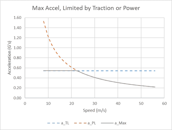

      I do still like plotting the acceleration capability vs. speed, including the case where only power limits it. That makes it evident that, even ignoring aerodynamic drag, the capability to accelerate diminishes with increasing speed.That is why I prefer ##ma = frac{P}{v}## rather than ##ma = frac{T}{r}##. With the torque equation, it leaves the impression that you can get any level of acceleration, at any speed. With the power equation, you clearly see that the acceleration will decrease as the speed increases.
      Log in to Reply
    9. Randy Beikmann
      Randy Beikmann says:
      November 25, 2018 at 8:13 pm
      Jack, the example you showed here gave valuable insight to the user of your website, especially since it was applied to a specific situation. You used the concept of "power flow" through the driveline to simplify the problem of choosing gear ratios, using a systematic way to do it instead of trial and error. The plots showed how changing the grouping of gear ratios could more closely approximate a "constant power" relationship across a certain range of vehicle speeds.
      I don't believe the article in "Insights" did justice to the way you explained things here. Now I better understand what you were after.
      I do believe, though, that comparing alternate methods is very valuable in gaining insight. If things had started off with you teaching him how to do it by following the power through the driveline (rather than torque and force), he never would have appreciated the way it made things easier for this purpose. Initial frustration is a good motivator.
      For some other purposes, I do still like plotting the acceleration capability vs. speed, including the case where only power limits it. That makes it evident that, even ignoring aerodynamic drag, the capability to accelerate diminishes with increasing speed. Also, if you need the performance envelope of a vehicle on a road course to do simulations, you can express it in terms of longitudinal and lateral accelerations (or forces), but not power since it does not enter into lateral acceleration.
      The performance envelope might come in handy for your user's problem of matching gearing to a road course. Besides "smoothing" the power delivery in a specific speed range, he might also want to make sure he doesn't have to shift while accelerating out of a critical corner.

      Since power varies with RPM, you want to coincide the RPM where you get the maximum power with the speed where you spend the most time accelerating. Say you know you spend a lot of time accelerating between 150 and 200 km/h, then you should have one gear ratio that gives you peak power RPM when you are at 175 km/h. If you spend most of your time in that speed range, you may also want to set the lower and higher gear ratios closer to that ideal ratio. This will increase your average power in that speed range (closer to peak power).
      This is what is shown in the next figures. It is actually based on the numbers from your attached file.
      Wherever the lines crosses, these are your ideal shift points. You can see how the average power (between shift points) in the 150-200 km/h range is greater in the second figure, compared to the first figure. Of course, this is only an example, and the power lost at 130 and 200 km/h might be unacceptable. In such case, you either have to set a smaller overall speed range by bringing closer the 1st & 5th gear ratios (i.e. less power at low speed and a lower top speed possible) or you can add gear ratios to fill the voids (i.e. a 7-speed gearbox is required). Note that as you increase the number of gear ratios within a given speed range, you set the average power closer to the peak power (but shifting may cause some losses and/or get more complicated).
      It is all about compromises.The answer I got back was:
      This is great, thank you so much! You gave me a lot of insight into the topic and I hadn't thought of it that way.Nobody thinks of it that way when they are new at this. Too many even refuse to do otherwise as they get experience. Why? Because they focus on «acceleration means torque».

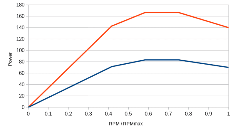

      Let me show you the problem at hand. If you discuss with a «torque» person and ask him which of 2 engines you have can produce the largest acceleration knowing that you have the exact same transmission in both cases, you can only change the differential gear ratio. He will say ¨Acceleration depends on wheel torque, so show me the torque of the engines¨:
      View attachment 234504 ​
      After seeing that, he will suggest the blue engine. Not asking you anymore questions. But you say ¨Some people look only at the engine power, what do think about that?¨:
      View attachment 234505 ​

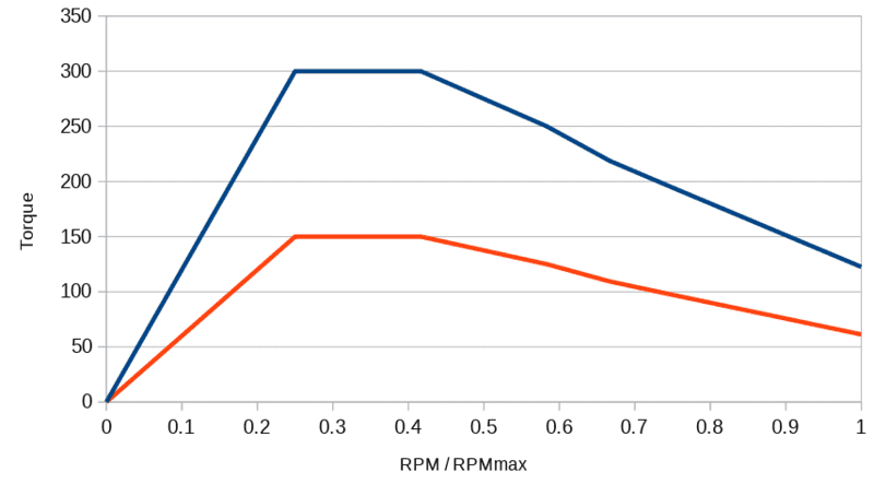

      He will answer back ¨It doesn´t matter, only torque creates acceleration¨. So you tell him ¨But they insist, they compare the power curves over the RPM/RPM[SUB]max[/SUB] ratio¨:
      View attachment 234506 ​

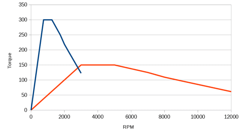

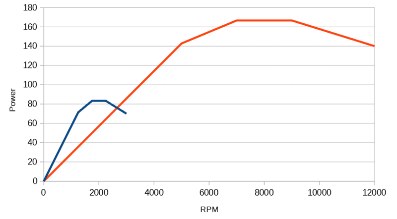

      He will answer ¨It doesn´t prove anything. See the torque curves with that same condition¨:
      View attachment 234507 ​
      ¨There, those scientists don´t know anything about real life. It´s only theory.¨ And he will add ¨Besides, go on PF and you´ll see that scientists don´t all agree on that: some say that only torque matters, just like me.¨
      This is the implication of not choosing carefully your words about the subject. If you think I am creating something out of nothing, see this thread where the OP cannot stop opposing engine builders with scientists. Even his nickname is Moretorque for pete´s sake. You can find hundreds of discussions like this over the net and these discussions were going on before the net existed.

      Here is a plot of what I was describing. The max power could produce the dashed orange line, and the available traction could produce the dashed blue line. In actuality, acceleration is limited to the lesser of the two (the gray solid line).
      Log in to Reply

      This is something I've thought through quite a bit over the years. What I realized is that you have to look at it from the standpoint of what limits the acceleration, and it depends on conditions. There are three common limitations: 1) Traction, 2) Power, and 3) Wheelstand.
      Here's the key: The vehicle can accelerate no quicker than the least of these three acceleration rates. Note that the second depends strongly on speed. So how large is each possible acceleration level? (I'm not going to worry about wheelstand here, by the way.)
      Traction-Limited Acceleration Level: Here, all you need to know is the maximum available traction force, and the vehicle mass (barring aero drag, road grade, etc.). So the traction-limited acceleration level is straight from Newton's second law: a_TL=Fmax/m.
      Power-Limited Acceleration Level: Here you are assuming that all the available power is going into acceleration (ignoring for now whether there is enough traction to do so). Since F=ma, and Pmax=Fv, then Pmax=mav. The power-limited acceleration level would be just a_PL=Pmax/(mv).
      Now let's take an example. Let's say the car's mass m is 1500 kg (3300 lb), the maximum traction Fmax is 8000 N (1800 lbf), and the maximum power Pmax is 180 kW (241 HP) at the tire/pavement interface.
      If you evaluated acceleration at 10 m/s (32.8 ft/s), the power-limited acceleration would be about 1.223 G’s, which there isn’t enough traction to accomplish (the tires spin first). The available traction would limit you to a_TL=0.544 G’s. So the maximum possible rate at 10 m/s is 0.544 G’s.
      If you evaluated acceleration at 30 m/s (98.4 ft/s), the power-limited acceleration would be about 0.408 G’s, which is lower than the traction limited acceleration, still 0.544 G’s. So the maximum possible at 30 m/s is 0.408 G’s.
      There is a critical speed in between those, where the traction-limited and power-limited acceleration are equal. This is where Pmax=Fmax*v_Crit, producing v_Crit=Pmax/Fmax. In our example, this critical speed is 22.5 m/s (73.815 ft/s).
      So for this vehicle, the maximum acceleration below 22.5 m/s is a_TL=0.544 G’s. Above that, the maximum is a_PL=(180000 watts)/((1500 kg)*v), so the maximum possible acceleration decreases hyperbolically with speed.
      What’s the takeaway? At low speed, very large traction forces would be needed to convey max power, so acceleration is limited by available traction. At high speeds, accelerating at the traction limit would require very large amounts of power, so acceleration is limited by power. The speed Pmax/Fmax divides the two regions.
