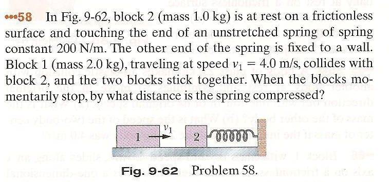

Textbook diagram Fig. 9-62: block 1 moving right at speed v1 toward block 2, which touches an unstretched spring fixed to a wall on the right. Problem 58 text is printed above.

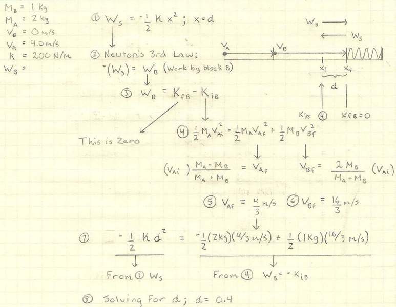

Here is the work that I've done. This is an even problem in my book so the answer is not given. The professor did gave the answer to this problem as .33m. The most recent answer I got is .4m which means block b is moving too fast in my solution. The mass is constant and I thought that I used the correct equations to calculate the Vf for both blocks (Eq. 5&6). Where have I gone wrong?
Handwritten physics work on graph paper: givens M_B = 1 kg, M_A = 2 kg, V_B = 0 m/s, V_A = 4.0 m/s, k = 200 N/m; spring work, Newton's 3rd law, and momentum-based velocity equations leading to d = 0.4.

what was your value for the initial speed of the combined blocks (i don't see it in your work)?
Thank you. Please clarify what you mean by "combined blocks"?
the question says "the two blocks stick together" …
that's the combined blocks …
what was your value for their initial speed (just before the spring starts compressing)?
I realize my mistake. I completely missed that part about the blocks sticking together after the collision. That would make this a "completely Inelastic Collision" meaning that I should have used this formula below (not sure if it will show) as the initial velocity. In equation 7, I changed the formula on the right to -1/2MV^2 and used the mass of both blocks for M and plugged in my new V-value, then solved for d. I got 0.33m.
