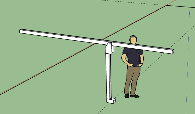

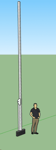

I want to build a tilting wireless internet structure that is 24 feet high, with a fulcrum at 6ft. The idea is when I want to work on the device (which is 24 ft in the air), I can just unlatch the mast and tilt the structure down and work on it. I would like to have the pivot (or fulcum) at six feet high, with the remaining 18 ft at the top.
See two pictures below. One with the base up, another in horizontal position. The drawing attached is only a 15 ft version, I'm building a 24ft version which will increase the weight of the counter balance.
Question:
How much *counter weight* would I need on the short end to make the tilting operation easy on me so I don't want to use a winch, which other designs do.. I'd like it to be hand operated for simplicity. Question is how much counter weight would I need to keep the tilt operation under my control. I'm kinda fat so maybe I won't need too much counter weight.
The weight: 130lbs of Square tubing.
The support base is .125 thick, 3.5"x3.5"x24 ft long Square tubing. This tubing weighs 5.39 lbs per ft. So 24ft x 5.39 = 129.36lbs. So let's call it 130lbs. Technically there will be a small antenna on the top, about 5-10 lbs. But for now let's ignore the weight of the equipment at the top.
The pivot point or fulcrum: = 6ft from ground.
The top of the Square tubing 24ft. So there is 18feet from the fulcrum.
Thanks.
-R

Back of the envelope calculation.
1/4 of the weight of the pole(130/4 = 32.5 pounds) is to the right of the fulcrum.
3/4 of the weight of the pole(3/4x 130 = 97.5 pounds) is to the left of the fulcrum.
The CW moment around the fulcrum caused by the pole is approximated by summing the products of each foot of length by the weight of each foot of the pole on the right side.
Thus: (6!)(5.4) = 113 ft lbs. (6! = 1+2+3+4+5+6 = 21)
The CCW moment around the fulcrum caused by the pole is approximated by summing the products of each foot of length by the weight of each foot of the pole on the left side.
Thus: (18!)(5.4) = 926 ft lbs. (18! = sum of the digits 1 through 18 = 171).
From the above you need to add a CW moment equal to the difference between the two moments.
926 – 113 = 813 ft lbs.
If you add a weight who’s center of gravity is at the 5 foot mark, it will need to weigh
813/5 = 163 lbs. Because (163)5 = 813 ft lbs.
At the 4 foot mark it will need to be 813/4 = 203. Because (203)4 = 813 ft lbs.
Note: if you weigh at least 200 pounds you could use your own body weigh to lower the pole.

I think I have the formula working in excel, but values are preliminary for now.
Changes:
Post changed from .120 steel to .250 inch steel.
Length of pole: 24ft
Weight of pole: 252lbs (10.5 lbs per ft.)
Fulcrum: 6ft
Excel Calculations (Values probably rounded by excel)
171 CCW Moment 1795.5
21 CW Moment 220.5
1575 Ft Lbs (CCW-CW) Moments difference
Counter Balance Position: 6ft
Counter Balance Needed: 262.5lbs

The calculations are correct but the force for lowering the pole is not your problem. With the imbalance on the upper section, preventing the pole from running away and the top end crashing to the ground as the pole is swung toward the horizontal position; and, being able to raise it from that position are the issues that need to be addressed with your counterbalance.
The amount of moment is also a function of the horizontal distance of your weights from the poles vertical position as it rotates about the pivot and this applies to both the top and bottom sections of the pole. A fully counterbalanced horizontal pole will require you to provide all of the force of the moment of the upper section in its vertical position; but this can be offset by using a pulling rope long enough to increase the your distance from the pole at the start of the lowering.

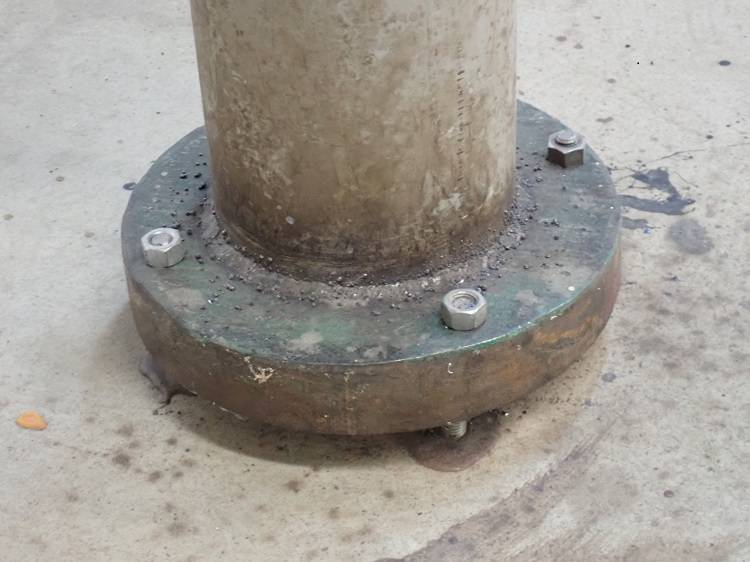

I'm a novice welder so, arc welding 1/2 steel to 1/4 inch steel much easier for me.
I also am a novice welder, but I was able to weld a 1/16" wall thickness tube to a 1.5" thick disk:
It's not a pretty weld, but then I'm not a very good welder. The secret is to preheat the thick piece. It's the mount for my machinist vise.
I like the idea of 1/2" plate and a 1" pin for the pivot and bracket. A little overbuilt, but only a small amount of extra steel. Your offset bracket will hold it vertical, and slightly undersizing the counterweight will hold it horizontal. You still need to pin it when in the vertical position.
