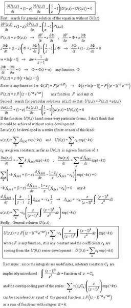

Hello !
A method to analytically solve the EDP is presented in the joint page.
Of course, the general solution includes arbitrary constants that should be determined if further conditions related with U(0,t) would be specified.
  • Handwritten-style derivation of the general solution of a first-order PDE by characteristics, with equations for dU/dt and sums over eigenfunctions in exp(-kt) form.

@JJacquelin
Thank you very much for taking the time to do all the steps. Your method seems to lead to a solution. The only issue here is that [tex]U(0,t)[/tex] is unknown and I don't have the [tex]c_{k}[/tex] values in the series development. The only way that I currently know to tackle this is the use of Rouché's Theorem at some point in the solution (in the Laplace domain) to get [tex]U(0,s)[/tex] (hence [tex]U(0,t)[/tex]).
Apart from the concern with regard to [tex]U(0,t)[/tex], your method is perfect. In your opinion, there's no way that Method of Characteristics can be used here to derive a solution?
Thank you again to both of you! :)
Hello again,
sorry for the late answer due to vacation.
As you say :
The only issue here is that U(0,t) is unknown and I don't have the ck values in the series development.
OK, U(0,t) is a kind of bondary condition and if the bondary conditions are not known, or incomplete, any method will failed to reach the solution.
But, as far as I can understand, some conditions or specifications are given so that U(0,t) might be derived. So, one could say that U(0,t) is "not explicitly known" instead of "not known", which isn't the same.
The question is : are the given conditions or particular specifications sufficient ?
The answer is Yes or No, depending of the way the boundary conditions or particular specifications are specified. From a previous thread :
U(0,t) arises due to a boundary condition, but it is unknown and should be derived by solving the PDE itself (details are irrelevant).
My opinion is that details are very relevant, in fact the key point.

@masnet,
once again in solving PDE, the major difficulty is not to find the general solution, but to fit the general solution to the boundary conditions : The general solution includes parameters and arbitray functions. The main difficulty is to determine the unknown functions and parameters to be compatible with the boundary conditions which are directly or indirectly given.
The key aspect is how the boundary conditions are settled, especially when they aren't explicitly given, but derive from other conditions (which is the present case). The mathematical developments may be rather easy or very arduous depending on the method used, depending on whether the chosen method have or doesn't have some affinities with the kind of given specifications for the boundary conditions.
As far as I can understand, there are discret specifications ( n varying fom 0 to N-1). So, it isn't a surprise that induction method involves less difficulties than other methods.
Nevertheless, it seems probable that other processes would lead to the same result, but possibly by dint of much efforts.
I will not highlight the method I proposed in the previous message, because I have some doubts in case of discret specifications. But, if you intend to push this method ahead, I would suggest this :
Definitively forget the notation U(0,t) and remplace it by Sigma(Ck*exp(-k*t) )
It is the same to say "an unknown function" or a "series with unknown coefficients"
In fact, Sigma(Ck*exp(-k*t) ) is a bit better that "unknown function" because among the infinity of "unknown functions" it limits the possibilities to a smaller familly of unknown fuctions.
Then, after putting Sigma(Ck*exp(-k*t) ) in the PDE , write the relationships derived from the specifications which settle the boundary conditions. This will lead to a system of equations where the unknowns are C1, C2, C3, ... (as many as the number of equations)
Theorically, solving the system will lead to the solution 'expessed as a series with the computed coefficients)
But, the process is likely to become too complicated. This would mean that the method is not convenient in the present case and must be abandoned, even if it is theoretically correct.
Hoping that will help you.
