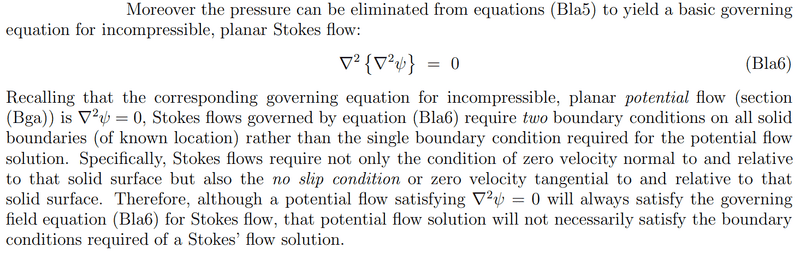

OK, my apologies, I confused your use of the fluid stream function ##\psi## with the potential function ##\phi##.
So as I now understand it, you're interested in the 2D vorticity vector ##\vec{\omega}\equiv\omega\left(r,\theta,A\right)\hat{e}_{z}\equiv\nabla\times\vec{v}=-\nabla^{2}\psi\,\hat{e}_{z}\,##, where ##\omega\left(r,\theta,A\right)\equiv-\frac{A\,\cos2\theta}{r^{2}}##. Since it's easy to verify that ##\nabla^{2}\omega\left(r,\theta,A\right)=0##, your stream function ##\psi(r, \theta)=\left( \frac{c_1}{r^2}+c_2r^2-\frac{A}{4}\right)\cos2\theta## actually satisfies the homogeneous 4th-order biharmonic equation ##\nabla^{4}\psi=0##. This puts you squarely into the realm of Stokes flow, which requires two boundary conditions on each surface (http://brennen.caltech.edu/FLUIDBOOK/basicfluiddynamics/Stokesflow/equationsofstokesflow.pdf):

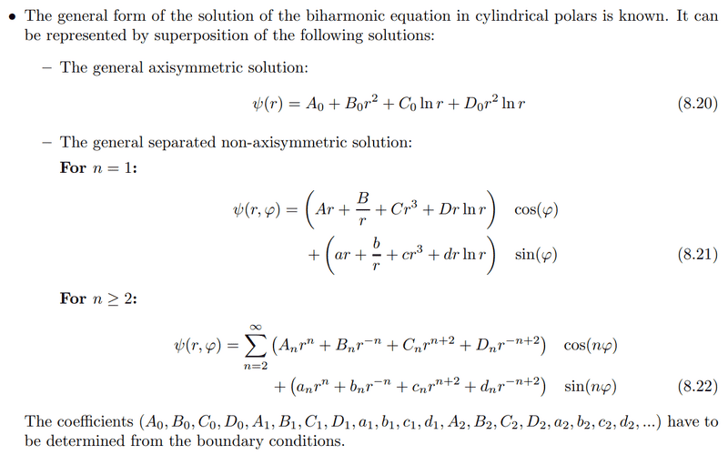

Because of this, satisfying your boundary conditions is possible, but it unfortunately requires a substantially more complicated stream function than the one shown above (http://brennen.caltech.edu/fluidbook/basicfluiddynamics/Stokesflow/planarflow.pdf):

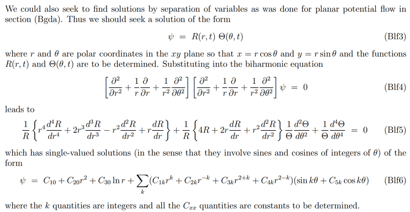

Another useful reference to these equations is https://personalpages.manchester.ac...il/Lectures/Fluids/Material_2016/Chapter8.pdf:

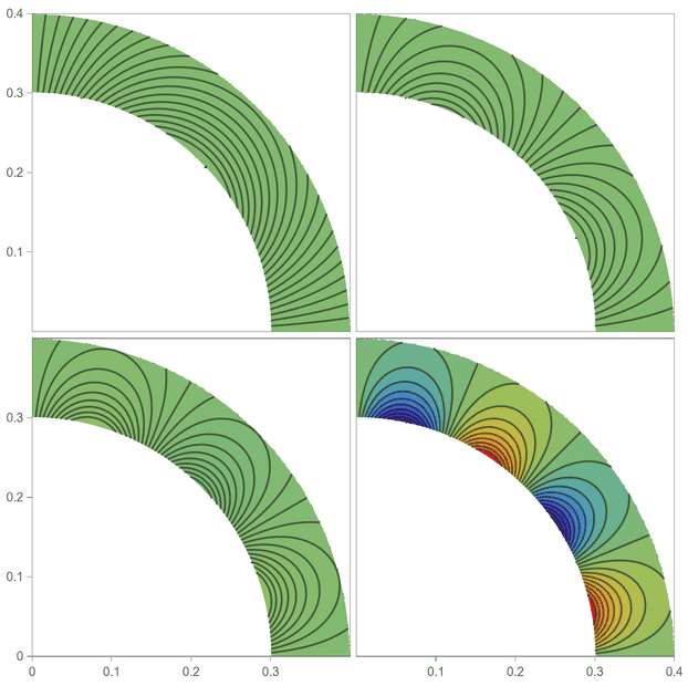

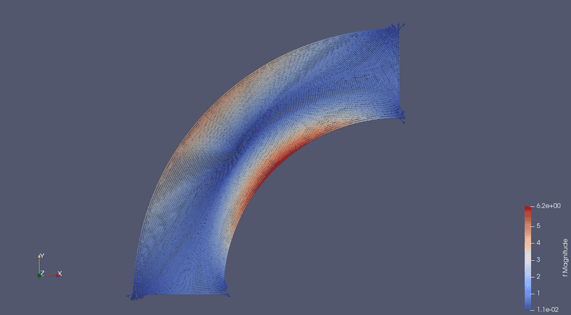

Before I display the numerical results, I wanted to mention that a similar problem is much simpler to solve. If you replace the ##\cos(2\theta)## by ##\sin(2\theta)##, then ##\psi(r, \theta)=\psi_0 \left[ 1-\left(\frac{1}{r_i^2+r_o^2} \right) \left( r^2+\frac{r_i^2r_o^2}{r^2} \right) \right]\sin(2\theta)##, it satisfies the same boundary condition as in my problem. In fact, it turns out that this change of problem still corresponds to another physical problem, so it's not just a mathematical curiosity. I can then compare my numerical result to this exact solution. There is a slight difference in that my numerical problem treats a slightly more complicated problem and the analytical solution is a solution to a slightly simplified problem.
Here's a picture of ##\vec J## for this similar problem. Coloring is based on the magnitude of ##\vec J##, the arrows only indicate the direction of ##\vec J##. Not sure if you can see it, but ##\vec J## has a single vortex, the current density swirls around it. It's not clear to me whether ##\vec J## vanishes there, it seems to occur right at the center to me, so we would have to retrieve ##\vec J## from the analytical formula and check if ##\theta =\pi/4##, ##r=(r_o+r_i)/2## makes ##\vec J=\vec 0##.

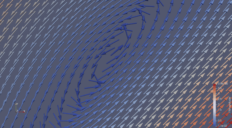

And here's a zoom on the center, to see the vortex more closely.
And here's a plot of several constant streamlines, taken from the analytical solution.
To me, visually at least, they seem to be in good agreement with the current density computed numerically.

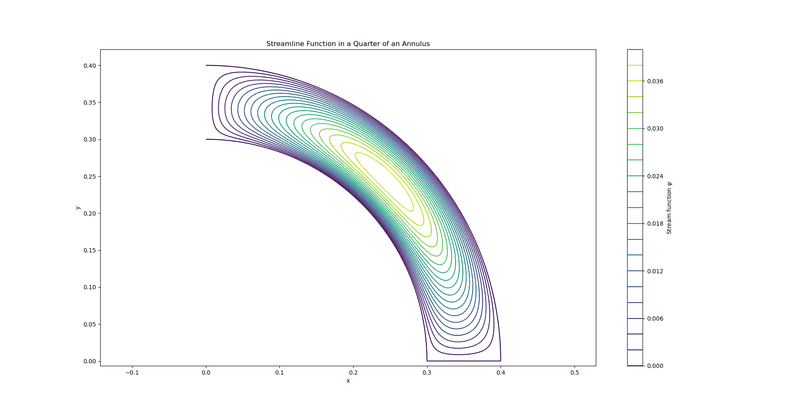

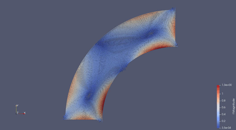

Finally, here is my numerical result of the original problem, the one I am still looking for its analytical solution:
I am not sure if you can see it, but I see at least 2 vortices. At the bottom, a vortex with a clockwise swirl. At the top, counter clockwise swirl, which is inline with the curl changing sign about ##\pi/4##, where it vanishes (and ##\vec J## seems to be following an inward straight line there, which makes sense). To me, it looks like the swirls do not occur exactly at ##\theta = \pi/8##, they seem to be closer to the bottom and top edges than to the center. The magnitude of ##\vec J## seems to decrease as ##r## increases. Not sure if we can get much more from this.

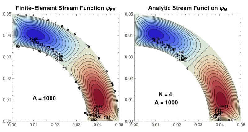

Thanks for posting all the detailed info. After seeing the streamlines from your analytical solution, a light bulb lit up! Of course I haven't seen your derivations, but I simply cannot reconcile your desired equation ##\nabla ^2 \psi(r, \theta)\propto \cos(2\theta)/r^2## with your required boundary conditions. So let me offer a different analysis of your problem.

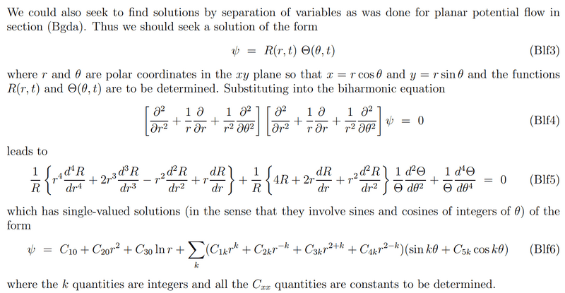

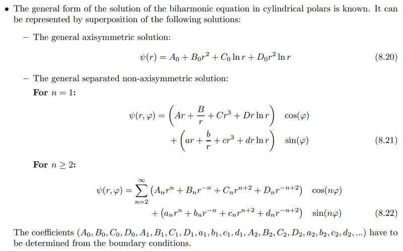

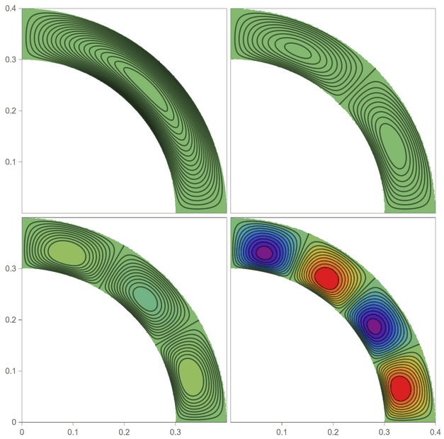

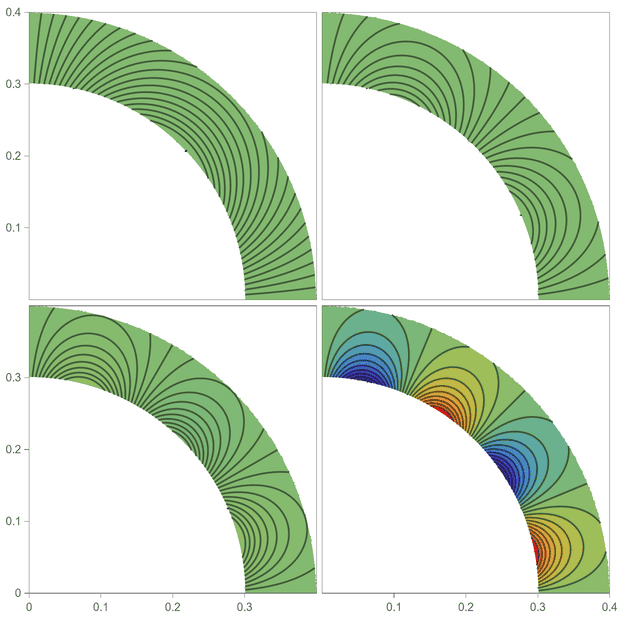

Consider the general series-solution of ##\nabla^{4}\psi=0## exhibited in the references shown previously in my post #7. In terms of the polar angle ##\theta##, that solution is a Fourier series involving ##\text{cos}(m\theta),\text{sin}(m\theta)##, where ##m=0,1,2,\ldots\,##. But as you've already realized, it's not possible to match your BCs using cosines, so I zero-out all the terms with ##\text{cos}(m\theta)##, and drop as well those with ##\text{sin}(m\theta)## whenever ##m## is an odd-integer. That leaves me with the specific series solution:$$\psi\left(r,\theta\right)=\sum_{n=1}^{\infty}\left(a_{n}r^{2n}+b_{n}r^{-2n}+c_{n}r^{2n+2}+d_{n}r^{2-2n}\right)\sin\left(2n\theta\right)\equiv\sum_{n=1}^{\infty}\psi_{n}\left(r,\theta\right)\tag{1}$$By construction, each term ##\psi_{n}## in this series is a solution of ##\nabla^{4}\psi_n=0## and also manifestly satisfies your condition ##\psi_n\left(r,0\right)=\psi_n\left(r,\frac{\pi}{2}\right)=0##. Moreover, 2 of the 4 arbitrary constants in each term can be chosen so that ##\psi_n\left(r_{i},\theta\right)=\psi_n\left(r_{o},\theta\right)=0##, thereby resulting in:
\begin{align}
\psi_{n}\left(r,\theta\right) & =\left\{ \left[\frac{\left(c_{n}r_{i}^{4n}r_{o}^{4n}\left(r_{i}^{2}-r_{o}^{2}\right)+d_{n}\left(r_{o}^{4n}r_{i}^{2}-r_{i}^{4n}r_{o}^{2}\right)\right)}{r_{i}^{4n}-r_{o}^{4n}}\right]r^{-2n}\right.\nonumber \\
&\quad \left.-\left[\frac{\left(c_{n}\left(r_{i}^{4n+2}-r_{o}^{4n+2}\right)+d_n\left(r_{i}^{2}-r_{o}^{2}\right)\right)}{r_{i}^{4n}-r_{o}^{4n}}\right]r^{2n}+c_{n}r^{2n+2}+d_{n}r^{2-2n}\right\} \sin\left(2n\theta\right) \nonumber\tag{2}
\end{align}
The set of all these ##\psi_n## are the "normal modes" for your problem because they can be superposed with the weightings ##c_n,d_n## to form the most general stream function ##\psi## that vanishes everywhere along the boundary of your annulus.
I turn next to the vorticity ##\omega\left(r,\theta\right)\equiv\sum_{n=1}^{\infty}\omega_{n}\left(r,\theta\right)##, where:$$\omega_{n}\left(r,\theta\right)\equiv-\nabla^{2}\psi_{n}\left(r,\theta\right)=-4\left[\left(2n+1\right)c_{n}r^{2n}-\left(2n-1\right)d_{n}r^{-2n}\right]\sin\left(2n\theta\right)\tag{3}$$From this it's clear that the constants ##c_n,d_n## can be adjusted to set specified boundary values for ##\omega_n## on the inner and outer cylinder walls. Alternatively, these constants can be tied to the tangential velocities ##v_{\Vert}=\frac{\partial \psi}{\partial r}## of the fluid on those same walls. Picking these values requires a knowledge of the physics you're trying to model (which I lack), so I leave selecting ##c_n,d_n## to you.

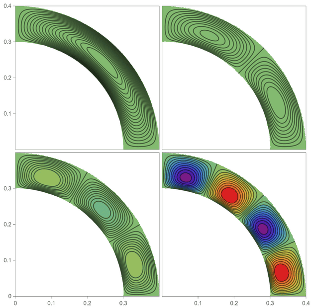

That said, it's easy to use Mathematica to evaluate and plot the stream-function normal-modes ##\psi_n## from eq.(2) if I choose arbitrary values for ##c_n,d_n##. For example, the values ##r_{i}=0.3,r_{o}=0.4,c_{n}=1,d_{n}=1,n=1,2,3,4## produce:
Clearly ##n## determines the number of distinct vortexes and, as you observed, each vortex is adjacent to another that rotates in the opposite direction. The similarity of your graphs to my ##n=1,2## plots above suggests to me that your CFD code is computing something akin to ##\nabla ^2 \psi_n(r, \theta)\propto \sin(2n\theta)## rather than anything involving a cosine function.
And for completeness, I also show the vorticity normal-modes ##\omega_n## of eq.(3) for the same conditions:
\end{align}
Please let me know your thoughts.
