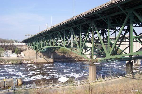

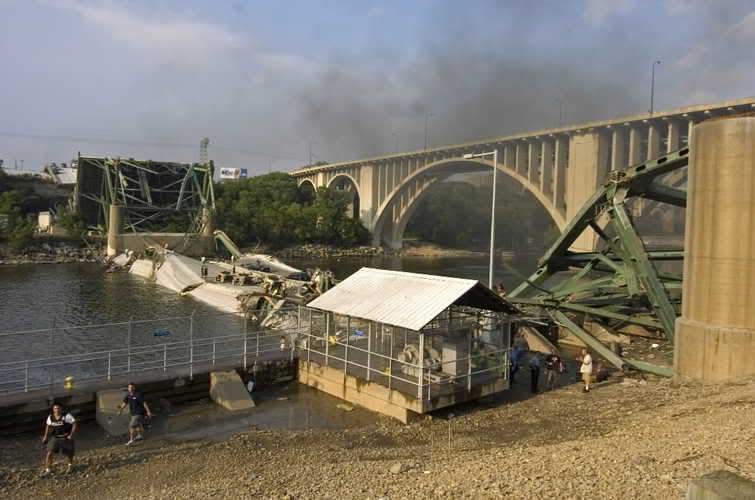

bbc: why?
BEFORE:
AFTER:
Who knows what caused it... the bridge was undergoing resurfacing and other 'minor' construction. Not sure what that means, but it might have had something to do with it. A failure of just one of those truss connections could cause the whole thing to come down.
They said it was bumper to bumper traffic just before the collapse, but it was mostly small cars. Bridges are designed to carry fully loaded tractor trailers bumper to bumper which is considered the worst case loading. I don't think this was the highest load the bridge had seen in it's 40 year lifetime. It must have been either some kind of material failure (corrosion, fatigue) or something happened with the construction that was going on.
Lower maintenance is a big reason that a lot of bridges like this are made of concrete now instead of steel (see adjacent bridge).
