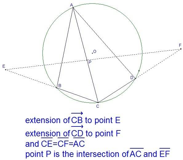

$ABCD$ is a Cyclic quadrilateral,given $BC=CD$
Prove:
$AC^2=AB\times AD+BC^2$

hint:
using the following diagram:
