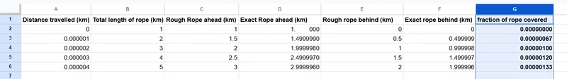

As a spreadsheet:
Screenshot of a spreadsheet with columns for distance travelled, total rope length, rough and exact rope ahead and behind, and fraction of rope covered, with small decimal values in the fraction column.
I guess I haven't proven that column G reaches one in a finite number iterations....

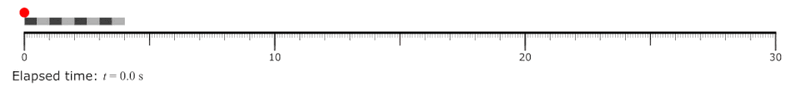

Here's the animation from the wiki page:
Timeline from 0 to 30 with tick marks, showing a red dot above a horizontal strip of grey segments near 0, with the label Elapsed time: t = 0.0 s.
The effect is vastly downgraded, as the rope's expansion is on the same order of magnitude as the ant's pace, but still...
You can notice from the animation that the ant absolutely moves at an increasing speed, while the rope end absolutely moves at a constant speed.
