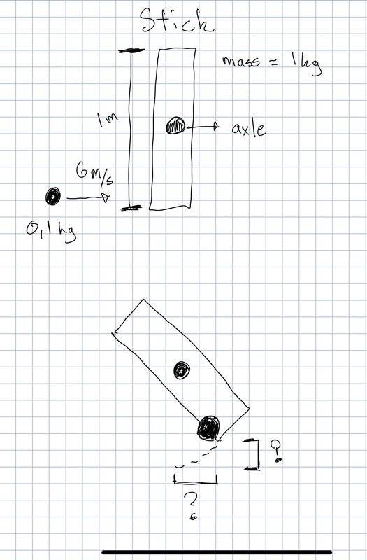

Exam
1/2Iw^2 = mgh
(1/2(1/12Ml^2+(1/2)^2Mw^2)/mg = h = 0.157
(Note: the stick weight is 0.4kg not 1.0kg)
Im not a native English speaker. So please excuse my bad english.
I had this on my exam, and Ím really unsure what the answer to this is. Ím suppose to calculate the height and angle of the swing Of this stick after a “stuck together” collition. But I’m really unsure if I should calculate a new masscenter or is it enough to just calculate the moment of inertia?
It confuses me. Since I think if I tilt the stick 30degrees before the crash, the gravity of the tip is the same? So it will stand still if I tilt it 30degrees? It feels unlogical, but I am not able to make a proper argument to explain my feeling. I would be great with either an answer or explanation what would be right/wrong to think...

Energy is not conserved during the collision (it's inelastic), but angular momentum about the axle is (why?). After the two have stuck together again, the energy of the ball/stick system from then on is conserved (why?).
Can you use that to make a start?

If you just tilted the stick, no attached mass, yes. The axle is at the stick's mass centre, so tilting the stick does not change its gravitational potential energy. The arms extending each side exert equal and opposite torques.

In my experience, finding the centre of mass of a composite system is rarely worthwhile. It is simpler to consider the contribution of each part (whether to torque or moment of inertia etc.) separately and add them up.

The weight of the stick is irrelevant, yes, but in the collision its mass is important.

Yes, that is what you must do.

The reason is that in the initial collision some energy is dissipated as heat and becomes thermal energy of the ball/stick system. The total energy is still conserved if you look hard enough, but kinetic energy is not and this approach isn't feasible. But the angular momentum of the ball-stick system about the axle is, since the reaction force at the axle produces no torque about the axle and the reaction forces between the ball and the stick are internal.

No, the stick has mass and length, so it has moment of inertia. I am saying that (for just after the collision) you can compute the moments of inertia of ball and stick about the axle separately and add them to get the moment of inertia of the combination.

Not entirely. You can ignore its weight, so you can ignore its gain in gravitational potential energy. But it will lose rotational KE, which you cannot ignore.

No he's saying you can't completely ignore it for the calculation. For the change in GPE, fine, you only need consider the height increase of the ball. But in order to calculate the initial KE ##= \frac{1}{2}I\omega^2##, the whole configuration is initially rotating so you must also add the moment of inertia of the stick.
