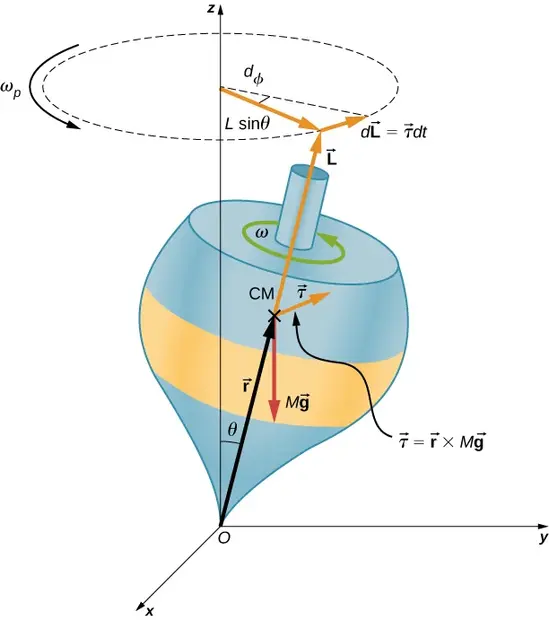

Below is my attempt to link her explanation to a force:
Diagram:
Explanation:
1. I draw my FBD. The dL represents the small change in L.
2. I combine dL and L to get L'. Experimentally, we know that the wheel will try to flatten itself at with the plane of rotation. In order for this to occur, a force, F must apply.
3. This is more evidence for the force. We know that the precession causes a z component of L. We don't start with any z component, and the torque due to gravity has no z component, so we must have some force in the x-y plane causing it.
Attempt at identifying force:
Based on my diagram I am 90% sure that there is a force, however I can not identify it. At first I thought the bearing of the wheel would give the force, but I don't know how it would know what direction the wheel is spinning. My next idea was that the wheel would become unstable when not rotating like it normally would, allowing external forces to push it in the direction of L'. Once the chaotic forces eventually pushed it toward L', it would stabilize. However, I don't like this solution either because it isn't very scientific sounding and would require some degree of luck.

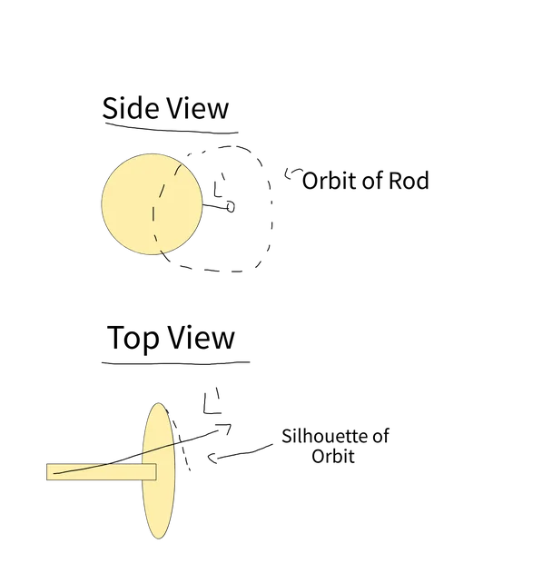

Here is my diagram, it doesn't let me edit my question anymore.

I understand why L changes, I just don't understand why the wheel attempts to be flush with the plane of rotation. In other words, why does the wheel rotate so that L' must be normal to it? The wheel could technically rotate at a slight angle right? Also I attached my diagram above to help explain my question. Essentially, if the gyro precesses, it must have some L in the z direction. This can only be caused by a force in the x-y plane because right hand rule will make the torque go in the z direction. That was essentially what I was asking.

The direction of the angular velocity would point at the next point in the precession. I understand that if the wheel rotated to the next point in precession, its angular velocity would be the predicted one. However there are many scenarios in which the wheel would have that angular velocity dictated by L'. Take my expected behavior for example:
Hand-drawn diagram of a spinning rod: side view shows a circle with a dashed orbit of the rod's tip, and top view shows a disk with a rod and a dashed silhouette of the orbit.
The orbit would be strange, but it would still have the same omega value. What in this scenario would make the wheel correct to become normal to L'?
Edit: I realize the silhouette should intersect with the rod and be wider, assume that it is.

What I don't understand is why the spindle of the top has to be aligned with L + dL. Take the first picture for example. Notice how the L vector is always through the spindle. What makes this true? What about physics makes it so that we can only rotate through that spindle?
Could you please explain "the spindle of the top" a little more in detail?
Which other way do you believe it could rotate and why?

By the spindle I meant the axis of the top that passes through the little beam at the top. I know the top could theoretically rotate around a crooked axis that is not through that beam. In my reply to kuruman I drew an example of this with the bicycle wheel rotating crooked.

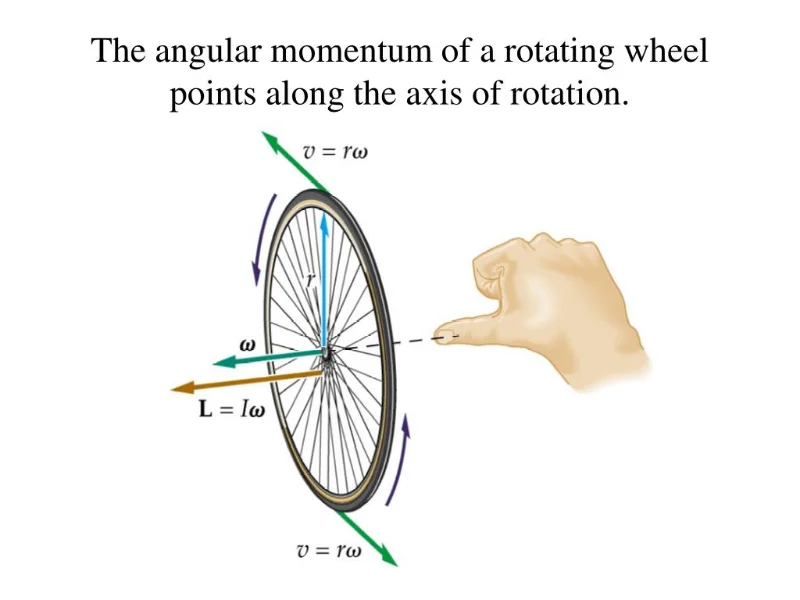

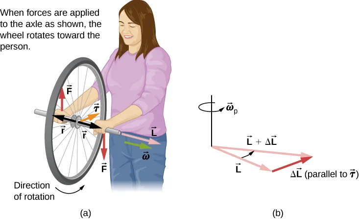

Diagram of a spinning bicycle-style wheel with a right-hand-rule hand pointing along the axis; arrows show angular velocity ω, angular momentum L = Iω along the axle, and rim velocity v = rω at the top and bottom.
Please study and understand the diagram on the right that uses the right hand rule to find the direction of the angular velocity vector ##\boldsymbol {\omega}## and hence the direction of the angular momentum vector ##\mathbf L.## In the absence of the torque generated by gravity, the wheel will spin with constant angular momentum ##\mathbf L## directed along its axis and perpendicular to the plane of the wheel.

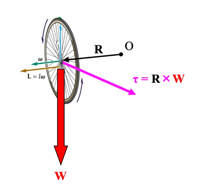

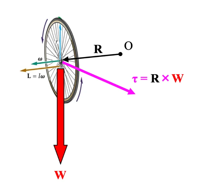

Diagram of a spinning bicycle wheel showing angular velocity ω, angular momentum L = Iω along the axle, weight W pointing down from the centre, position vector R from pivot O, and torque τ = R × W perpendicular to both.
Now consider the spinning wheel in the gravitational field of the Earth which exerts force ##\mathbf {W}## (the weight) at the center of mass of the wheel which is located at position ##\mathbf R## from the point of support. The torque about point O is ##\boldsymbol {\tau}=\mathbf R\times \mathbf W## in a direction that is in the plane of the wheel and perpendicular to both ##\mathbf R## and ##\mathbf W## as shown in the figure on the right.
The change in angular momentum ##\Delta \mathbf L## over time interval ##\Delta t## is ##\Delta \mathbf L=\boldsymbol {\tau}\Delta t.## This means that one has to add a small element of angular momentum ##\Delta \mathbf L## to the existing ##\mathbf L## in the same direction as the torque, i.e. perpendicular to ##\mathbf L##. Doing so, changes the common direction of the angular moment and the angular velocity along the spindle but not the magnitudes of ##\mathbf L## and ##\boldsymbol {\omega}.## This change of the common direction is illustrated in post #9 by @Lnewqban, see figure labeled (b).
To summarize, the force of gravity generates a torque about the point of support. This torque changes the direction of the angular momentum vector but not its magnitude.

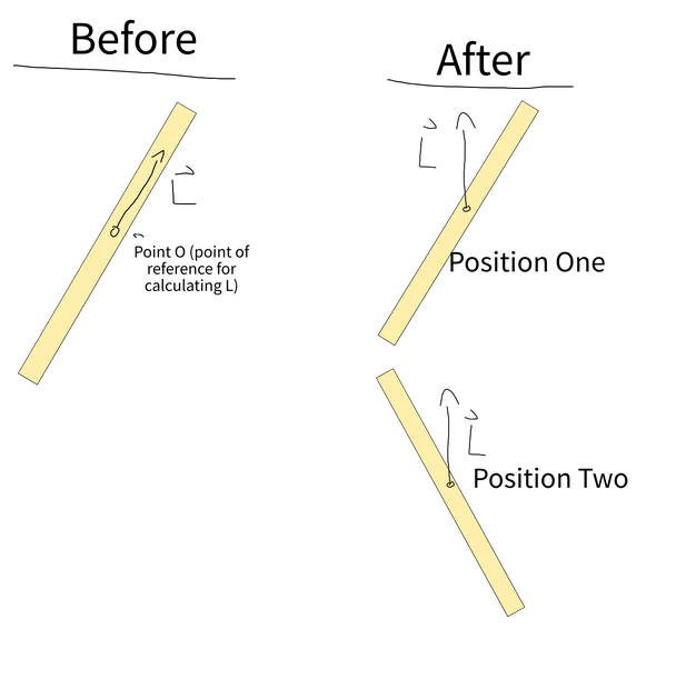

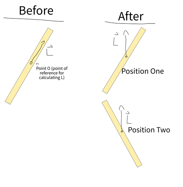

First let me clarify, I completely understand the concepts of angular momentum and that its time derivative is torque. I completely understand why the angular momentum vector must change direction. Both of these concepts were highlighted in my initial diagram, as L and the infintesimal dL, formed L'. I understand that the torque due to gravity will change the direction of L. What I am asking, is why the spindle has to point toward the angular momentum vector. Say you have a ruler which is rotating along itself (along the axis of its length). By the right hand rule it will have an angular momentum vector pointing along itself. However, if a torque was applied that changed the direction of L, the ruler would no longer rotate along itself. It would rotate like this (assume no external forces after the L has been changed):
Two-panel diagram: left panel labeled Before shows a rod with arrow along its length and Point O marked as reference for calculating L; right panel labeled After shows the rod at Position One and Position Two with the arrow redirected.
Notice how after the angular momentum is changed, the ruler does not change its orientation to become inline with L. In the case of the question, however, we know that the rod attached to the wheel will change its orientation to become aligned with L. In my previous question I showed how I expected the rod to rotate, which experimentally is wrong. This is because the rod would trace a separate circle, whos plane is tangential to the precessional rotation, and whos center follows the precessional orbit. This would show that the rod vibrates up and down as it precesses, which is not the case. So I guess a better question would be, what thing (could be a force or something else) causes the rod to shift its orientation to the new angular momentum vector? As another example of this assume a football that the QB puts a heavy spiral on. This ball would have a large angular momentum vector, correct? Lets say the wind exerts a torque on this ball, shifting the angular momentum vector slightly to the side. The ball will then begin to point in this direction correct? It will not assume some wobbly rotation. What causes this effect?
Could we compare your example to a bicycle wheel with its hub or bearings and natural axis of rotation not being perpendicular to the plane formed by the tire?
If so, nothing changes respect to the original experiment: the thing will still rotate around a verical axis.
