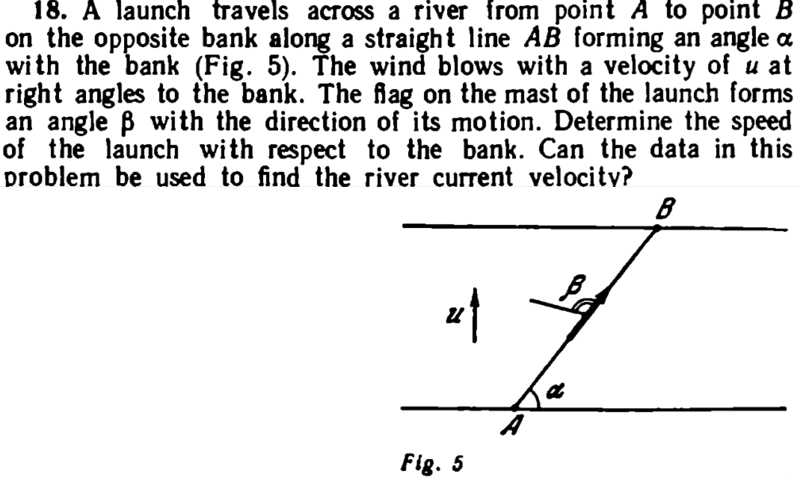

A launch travels across a river from point ##A## to point ##B## on the opposite bank along the straight line ##AB## forming an angle ##\alpha## with the bank (see figure below). The wind blows with a velocity ##u## at right angles to the bank. The flag on the mast of the launch forms an angle ##\beta## with the direction of its motion.
(a) Determine the speed of the launch with respect to the bank.
(b) Can the data in this problem be used to find the river current velocity?

Let me copy and paste the problem as it appeared in the text.

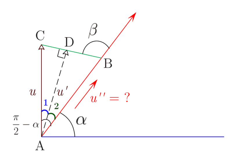

Geometry diagram of a boat's flag with vectors u, u', and u'' = ?, a red arrow along line AB at angle alpha, perpendicular segment AD and angles labelled 1 and 2, with beta at B.
I drew a sketch of the problem to the left. The launch moves along AB at an angle ##\alpha## to the horizontal and the flag is along BC at an angle ##\beta## to AB. The wind moves along AC with speed ##u##.
We are required to find the speed with which the launch moves along AB, say some ##u''=?##
To go there, we realise that the only the velocity of wind perpendicular to the flag of the launch would affect it. Let that speed be some ##u'## shown along AD. Of importance are the angles shown as 1 and 2. We also note that the sum of the two angles ##\angle 1+\angle 2 = \angle BAC = \dfrac{\pi}{2}-\alpha##, shown in the diagram.
Geometry diagram: triangle A, B, C with a line from A at angle alpha to the horizontal, a point D on BC with AD perpendicular to BC, labelled angles alpha+beta-pi/2, pi-beta, 1 and 2, sides u, u' and u''=?.
The approach is to go from ##\boldsymbol{u\rightarrow u' \rightarrow u''=?}##
[There's some tedious geometry here, so bear with me. I have marked angle values for help.]
We have ##\angle CBA = \pi - \beta\;\text{(shown)}##. In ##\small{\triangle ABC, \angle C= \pi-(\pi-\beta)-(\pi/2-\alpha) = \alpha+\beta-\pi/2\;\text{(shown)}}##.
Since ##AD\perp BC\Rightarrow \angle D=\pi/2##, we get the value of ##\angle 1 = \pi/2-\angle C##, ##\angle 1 = \pi/2-(\alpha+\beta-\pi/2)=\pi-(\alpha+\beta)##.
Let me annotate this angle : ##\color{blue}{\angle 1 = \pi-(\alpha+\beta)}##.
This would mean the speed ##u'=u\cos\angle 1=u\cos[\pi-(\alpha+\beta)]=-u\cos(\alpha+\beta) ##.
From the figure again, ##\angle 2=(\pi/2-\alpha)-\angle 1=\pi/2-\alpha-[\pi-(\alpha+\beta)]=-\pi/2+\beta##. Let me annonate this angle : ##\color{ForestGreen}{\angle 2 = -\pi/2+\beta}##.
Hence the speed along AB : ##u''=u'\cos\angle 2=-u\cos(\alpha+\beta)\cos(-\pi/2+\beta)\Rightarrow\boxed{u''=-u\cos(\alpha+\beta)\sin\beta}\quad{\color{red}{\Huge\times}}##

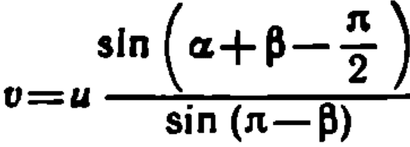

Doubt :
My answer doesn't match with the text.
I copy and paste its answer to the right.
Simplifying the text answer, ##\boxed{v=-u\dfrac{\cos(\alpha+\beta)}{\sin\beta}}\quad{\color{green}{\huge\checkmark}}##, which means I have only gone wrong in having ##\sin\beta## in the numerator. (I am assuming that, speed being a scalar, the negative sign is of little consequence.)
It is unclear to me what you even mean by this. The flag direction will be the wind direction relative to the ship. This is the wind velocity relative to the bank minus the ship velocity relative to the bank.
Of course I get the second part of your sentence using vector addition.
But it's the first part I don't follow.
The flag has a given direction, at an angle ##\beta## relative to the ship's motion. Are you saying the flag is free to reorient so as to be parallel to the wind relative to the ship?

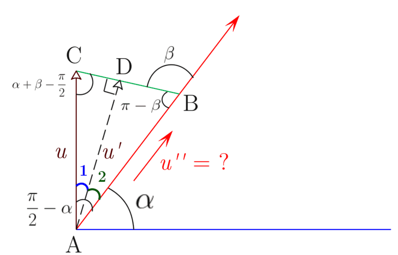

Vector diagram with vertex A at bottom left: segment AC of length u points up, dashed segment AD of length u' lies between, and red arrow from A labeled u'' = ? points up and right; green segment CB, angles alpha, beta, pi minus beta, and alpha plus beta minus pi/2 are marked.
Just an EDIT - I have found the mistake in my solution above in post #1. The speed ##u''\ne u'\cos\angle 2,## as I incorrectly wrote. But rather, from ##\triangle ABD##, ##u''=\dfrac{u'}{\cos\angle 2}\Rightarrow u''=\dfrac{-u\cos(\alpha+\beta)}{\cos(-\pi/2+\beta)}##, which simplifies to the correct answer :
##\boxed{u''=\dfrac{-u\cos(\alpha+\beta)}{\sin\beta}}##

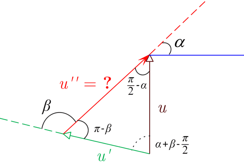

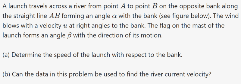

##\small{\texttt{EDIT - I have solved the problem in the more matured way using relative vectors.}}##
##\small{\texttt{I state the problem statement first and then go about solving it.}}##
Printed problem statement about a launch crossing a river from point A to point B at angle alpha to the bank, with wind velocity u at right angles and a flag at angle beta, asking for the launch speed and whether the river current can be found.
Problem statement :
Solution :
(b) is NO, obviously, because no data exists. However, that the boat is moving in a direction different from wind velocity vector ##\vec u## shows that water current is present. In that sense, the correct question to ask in (a) would be : Determine the speed of the boat with respect to the waster current.
Vector diagram of a boat's velocity relative to water: a vertical brown arrow labelled u, a red arrow labelled u'' = ? from the same vertex at angle pi/2 - alpha, a green arrow labelled u' along a dashed line, with angles alpha, beta and pi - beta marked.
I draw a sketch of the problem. We need to find the velocity of the boat relative to water, shown as ##\color{red}{u''=?}## and drawn with a red line (##\color{red}{\rule{10mm}{0.8pt}}##). This speed is at an angle of ##\alpha## to the horizontal, or at an angle ##\dfrac{\pi}{2}-\alpha\; {\text{(shown)}}## to the vertical. The wind moves with a velocity ##\color{brown}u## vertically up, shown with a brown line (##\color{brown}{\rule{10mm}{0.8pt}}##). The flag is shown with a green line (##\color{YellowGreen}{\rule{10mm}{0.8pt}}##). It is directed at an angle of ##\beta## to the velocity vector of the boat ##u''##. Hence the angle inside the triangle is ##\pi-\beta\;\text{(shown)}##.
##\small{\boxed{\texttt{Main concept}} : \texttt{Direction of flag = Direction of wind relative to motion}}##
Let the velocity of wind relative to motion be ##\color{YellowGreen}{u'}##. It is directed along the flag.
Let us focus on the triangle formed by the three vectors ##u, u', u''##. Two of the angles are known and shown. The third can be found by the angle sum property and is ##\alpha+\beta-\dfrac{\pi}{2}##. Let us focus on the sides ##u''## and ##u## and their opposite angles. Using the Sine Rule :
##\small{\dfrac{u''}{\sin(\alpha+\beta-\pi/2)}=\dfrac{u}{\sin(\pi-\beta)}}\Rightarrow\boxed{u''=-u\dfrac{\cos(\alpha+\beta)}{\sin\beta}}##
