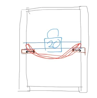

How do the principals of leverage apply to the stability of a bookshelf when the length of the shelf supports changes?
In this picture, I depicted a shelf that has two sides (black). On each side, there are holes for the shelf supports (red). They can be inserted into the holes and are supposed to hold a bookshelf (blue).
My question is the following: While the depth of the holes stays the same, does the length of the part of the shelf supports that stick out affect the stability of the construction?

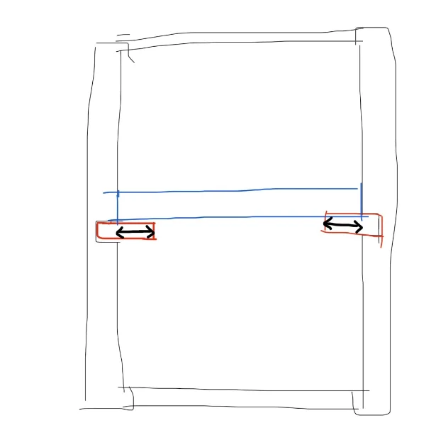

Hi, Thanks for the interesting info. However, I’m not sure if this answers my question. I want to know if the length of the pins (marked with a double arrow) affects their ability to hold the shelf. I think it doesn’t, but my friend said that if they are longer, leverage can cause them to break or cause damage to the holes in which they are put.
For the most part, the load will be applied as a shear force - which is not dependent on the length of the pin. However, as a practical matter, the edge of the shelf against the top of the pin will not align perfectly with the edge of the hole on the bottom of the pin - and that will tend to turn the pin. So, the pin needs to be long enough and extent far enough into the hole to keep that from happening. It would depend on the strength of the wall material (black in your drawing) and how snugly the pin fits into the hole, but as an approximation, if the pin extends into the hole by 3 times its diameter, you're probably all set. Further than that likely won't help or hurt.
In the other direction, the pin needs to extend out from the wall to the shelf far enough to give the shelf a secure perch. Assuming the pin itself is very strong, the shelf material and the load will determine this. Expect the bottom of the shelf to deform slightly to allow the load to be distributed over a small area in contact with the pin. Without this deformation, the contact area would be zero and the contact pressure would be infinite. Of course, those pins are often made with a flat surface that can be faced up to the bottom of the shelf to reduce this deformation.
As far as the distance that the pin extends inward (your main point, I believe), there are two cases:
1) if the pin extends more than a few diameters inward, either the extra distance will be unused (supporting no or very little of the load), or it will be supporting load (perhaps because the shelf is too narrow or the walls are flexing outward). If it is supporting load, the hole supporting that pin is at a mechanical disadvantage in supporting the load. In either case, the extra length is either unneeded or it may lower the life of the shelf.
2) in the extreme case, the pin extends inward all across the bottom of the shelf to the hole on the opposite side. It would still be best for the shelf to fit snugly between the walls. But, so long as that rod does not bend, this configuration would be better than long pins that do not connect.

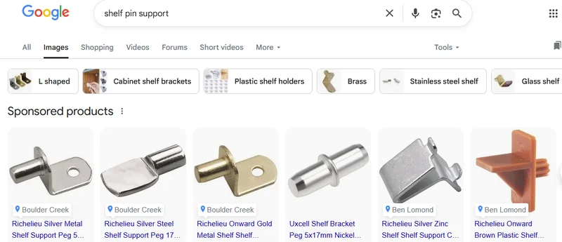

From looking at typical shelf support pins, it looks like the supporting part (usually flat) extends out about the same amount as the pin that goes into the sidewall. Making the supporting part longer would not have any advantage (as long as the shelf material is strong enough), and would just cost more money.

Your diagram is 'half way there if you want to exaggerate all the potential weak spots.. The angle of rotation of the pegs in the holes should be part of the diagram. The shelf itself has a hardened laminate surface which provides a lot of strength; if you examine an elderly cupboard there will be hardly any sign of distortion where the shelf rested on the peg / bracket. The first thing to 'go' in the system will be the shape of the hole - more and more elliptical with age and abuse, because the material in inside the wall is soft and, once the peg sags the edge of the hole takes more and more of the shear load. The assortment of brackets in @berkeman 's post #5 contains weak and strong examples. A vertical plate which is pushed to the wall (well fitting shelf width) provides high torque to prevent sagging. The torque is higher when any force is applied at a useful distance; the plate provides the 'distance'. It's a good brain exercise to draw a suitable diagram, identifying the actual loads and distances (=torques).
