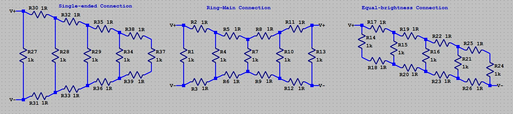

Where you have an end fed strip of many groups of LEDs, each group with a current limiting resistor, the voltage drop along the supply lines will result in some voltage variation along the strip. LEDs will be brighter at the feed end, dimmer at the open end.
One way to reduce that variation is to feed the strip from both ends. Connect the positive supply at one end, with the negative supply at the other end. That places the same series supply resistance in all LED current paths, so the voltage variation should not result in a current or brightness variation along the strip.
All LEDs will then be equally bright, the same brightness as the LED in the middle of the strip would be, if fed with both supplies from one end only.

The UK ring main is a quite different system, one that does NOT balance the voltage drops. The UK ring main supplies current from both ends of the ring through both conductors, that is with four connections at the distribution box. A break in either conductor can double the current in the broken wire, which then has only half the copper needed to meet the voltage droop specification. Overheating of the wires can take place without there being any warning to the occupants of the premises.
LEDs, or loads, on an intact UK ring main configuration would be brightest at the ends, with the dimmest LED being in the middle of the ring. The UK ring main configuration is actually used for most LED strips, because it provides more light, but it only halves the brightness variation, it does not cancel the variation completely.
One pair of conductors, in a ring, with only one conductor fed at each end, equalises the line resistance to all nodes on the ring. Unlike in the UK ring main, any break in either conductor will extinguish all nodes between the break and the open end of that conductor. For that reason, it is easier to diagnose the presence and position of a break, than it is in the UK ring main system, but it doubles the cost of the copper needed in the wires.

Could you clarify this a bit more, please? If you could refer to a diagram of the LED strip arrangement then It could be clear but I would assume that there's parallel connection for each LED unit onto the power leads. The ring main uses a Live ring and a neutral ring. Will a ring supply to a number of LEDs have two conductors, arranged in a ring (+v and 'Earth) or some other arrangement?. There are, of course, some differences in applications and power levels the ring main is designed to cope with the full current without getting hot and the LED system equalises the LED brightnesses but is there really any fundamental difference?

In these schematics, a LED with a series resistor is represented by a vertical 1k resistor. The resistance of the conductor is represented by a horizontal 1R resistor. The voltage on a node is proportional to the vertical on the schematic, so hopefully it will clearly illustrate the voltage droop for the different configurations.
Three resistor network schematics labelled Single-ended Connection, Ring-Main Connection and Equal-brightness Connection, each with 1k resistors as vertical branches and 1R resistors as horizontal conductor segments between V+ and V- rails.
Got it - thanks. The cost of copper in a ring main is very relevant (power dissipation costs you). Thin lighting wire is cheap so you can afford to ‘waste’ the extra current carrying capacity in the interest of even lighting.

You are too easily persuaded.
The voltage droop diagrams shown, are true only for one LED turned on at the time.
When all LEDs are on, the variation in the ring-main easily beats the variation in the single-ended, and comes close, but not equal to, the variation in the equal-brightness circuit.
I agree that, the ring-main is a clear win for the economy.

I was born yesterday! But, as with all Engineering, it all has to do with cost benefit and practicality. Low current conductors are cheap so you can throw just a little money at the LED circuit and keep the brightness variation as low as you need.
BTW how does the overall voltage reduction decrease by changing from the equal brightness system to the double ring system? The effective source resistance for a double ring would be lower than for the equal brightness system.
For only one LED on, that LED would be operating at the same voltage.
For all LEDs on, double end fed would have higher voltage than in the equal brightness system.
The analysis is complicated by the type of current regulation employed for the individual groups of LEDs.
