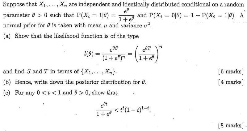

Hi all,
Typed problem statement in four parts (a) to (c) on conditional Bernoulli observations with a normal prior for theta, including formulas for P(X_i = 1 given theta), the likelihood function and the inequality exp(theta t)/(1+exp(theta)) < t^t(1-t)^(1-t).
In this question, I found that
[tex]\Pr(X_i|\theta)=\frac{\exp(\theta x_i)}{1+\exp(\theta)}[/tex]
and I carry on with the likelihood being [tex]\frac{\exp(\theta \sum x_i)}{(1+\exp(\theta))^n}[/tex]
and so [tex]s=\sum x_i = Tn[/tex]
I need some help with part (c).

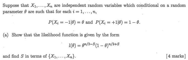

Typed problem statement: independent random variables X1 to Xn with P(Xi = -1 | theta) = theta and P(Xi = +1 | theta) = 1 - theta; part (a) asks to show the likelihood l(theta) = theta^(n/2 - S)(1 - theta)^(n/2 + S) and find S in terms of the Xi; [4 marks].
How do I start with this question then?
I couldn't get a general expression for [tex]\Pr(X_i|\theta)[/tex].
How do I generally deal with these "piecewise probability density function"?

Suppose that [itex]X_1,...,X_n[/itex] are independent and identically distributed conditional on a random parameter [itex]\theta > 0[/itex] such that
[tex]P(X_i = 1|\theta) = \frac{e^\theta}{1+e^\theta}[/tex] and [tex]P(X_i = 0| \theta) = 1 - P(X_i=1| \theta)[/tex].
A normal prior for [itex]\theta[/itex] is taken with mean [itex]\mu[/itex] and variance [itex]\sigma^2[/itex].
(a) Show that the liklihood function is of this type
[tex]l(\theta) = \frac{e^{\theta S}}{(1 + e^\theta)^n} = \big{(}\frac{e^{\theta T}}{1 + e^\theta}\big{)}^n[/tex] and find [itex]S[/itex] and [itex]T[/itex] in terms of [itex]\{X_1,X_2,...X_n\}[/itex].
(b) Hence, write down the posterior distribution for [itex]\theta[/itex].
(c) For any [itex]0 < t < 1[/itex] and [itex]\theta > 0[/itex], show that
[tex]\frac{e^{\theta t }}{1 + e^\theta} < t^t(1-t)^{1-t}[/tex] .
One thought that comes to mind is to use calculus to see if the function
[tex]f(\theta) = (\theta)^S ( 1 - \theta)^{n-S}[/tex] takes its maximum value when [tex]\theta = S/N[/tex]. If so, then [tex](f(\theta))^{1/n}[/tex] also takes its maximum value there.
for each [itex]i = 1,2,...n[/itex]
[tex]P(X_i = -1|\theta) = \theta}[/tex] and [tex]P(X_i = 1| \theta) = 1 - \theta[/tex].
(a) Show that the liklihood function is given by the form
[tex]l(\theta) = \theta^{n/2 - S} (1-\theta)^{n/2 + S}[/tex] and find [itex]S[/itex] in terms of [itex]\{X_1,X_2,...X_n\}[/itex].
let [itex]k [/tex] be the number of the [itex]X_i[/itex] that are +1 and let [itex]S = n/2 - k[/itex]<br /> <br /> Isn't "discrete" a better term than "piecewise"?[/itex]
