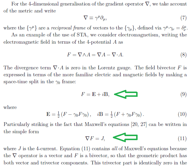

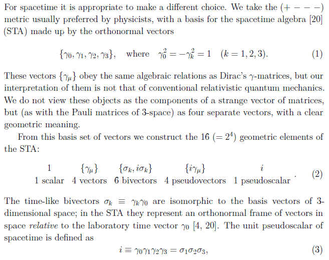

Histspec said:
Another six-vector representation of the EM field, which is still be used, is the Weber (or Riemann–Silberstein) vector.
A similar six-vector representation of the EM field is used in modern geometric algebra.
The ##i## in equation (9) represents the unit pseudo-scalar with ##i^2=-1##.
The equation (11)
$$\nabla F=J$$contains all of Maxwell's equations, including the inhomogeneous and homogeneous ones.
So this notation is more compact than the usual tensor notation.
