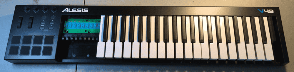

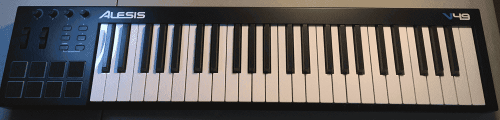

The idea is to remove all of the keys and rearrange them in a BWBWBWBWBW... pattern. For mine, I chose the note 'A' to be a white key.
There are only two shapes to be learned in order to play all twelve major scales on a 'balanced' keyboard:

An unmodified Alesis V49

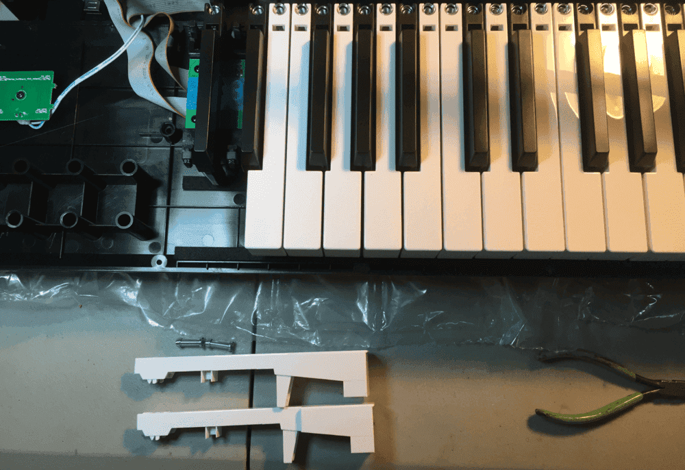

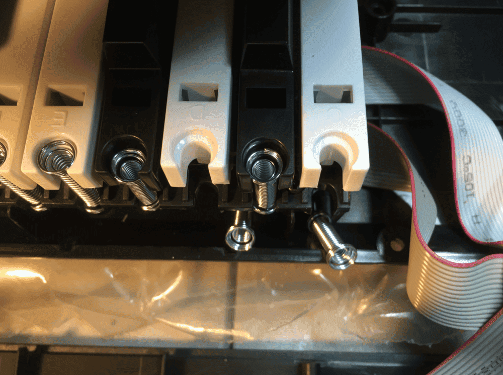

After opening the keyboard, the springs at the top of each key need to be lifted out using the needle-nose pliers.
To remove the keys, the small slotted screwdriver head should be inserted in the small rectangular hole (below the spring). There is a latch that needs to be released. Ya just got to look at it to see how to release them. It's no big dial if the clips break because the spring still will hold the key in properly.
Here's the completed 'balanced' keyboard.
