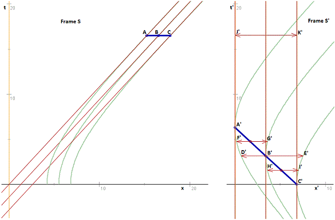

That paper would appear to be junk. It claims that the string length in Bell's rocket paradox has been incorrectly calculated in all previous treatments. This is unlikely, because Bell's paradox has the rockets moving with Born rigid acceleration, which has the property that the proper length of the string remains constant. The claim of the paper is tantamount to saying that Born rigid motion does not have the property of constant proper length. The paper also claims that the accepted bunch length of charged particles in an accelerator is not correct. This is also unlikely as accelerators are operated every day somewhere in the world and knowing the bunch length of accelerated particles is probably essential for the routine operation of these machines.
Right. In section 2, the paper says,
Let us consider, for instance, Bell’s well-known problem where two identical pointlike rockets simultaneously (by IRF clocks) begin to move in the same direction, one following the other, with constant and equal accelerations (in the astronauts’ reference frame). Suppose that these rockets are connected by a rubber (a thread) which does not affect their motion.
Now, if there is to be Born rigid acceleration along the lengths of both rockets, such that the thread does not break, then there must be a continuous acceleration gradient of the constant proper accelerations between the front of the first rocket and the back of the second rocket of 1/ aF - 1 / aB = d / c^2, where d is the proper length along the entire length of both rockets and the thread. Since these are proper accelerations, it is what the astronauts will actually measure with accelerometers, but this is not what was stated. Rather, the paper states that the rockets have equal accelerations. So if the acceleration profile of each rocket is the same, yet each rocket also contracts with Born rigid motion, then of course the thread must break.
Actually, if we just fire a thruster at the back of each ship that applies a constant proper acceleration at those two points and the rest of each ship contracts naturally according to Born rigid motion, then we could simply make d the distance between the thrusters at the back of the ships, or the length of the back ship plus the length of thread. So if the thruster at the back of the back ship applies 1 G of constant proper acceleration and the thruster at the back of the front ship (it doesn't even matter how long the front ship is) applies a constant proper acceleration of (1 G) / [1 + (1 G) d / c^2], then the thread will not break.
Oh, I just caught that the setup I quoted from the paper says that the rockets are point-like. So as not to confuse anybody, d would just be the length of the thread itself in both of my posts in that case, then. If the rockets have equal constant proper accelerations, then the thread will break. If the back rocket accelerates faster than the front rocket such that 1 / aF - 1 / aB = d / c^2, then the thread will contract with Born rigid motion at the same rate that the distance between the rockets decreases according to the initial rest frame, and the thread will not break.
O.K. I concede you have a point and I may have skimmed the paper too quickly. We are at least agreed that the string breaks in the equal acceleration case. In order not to break the string, the distance between the rockets needs to length contract, as per Born rigid motion, in the inertial reference frame. In the equal acceleration case the separation between the rockets remains constant so the string must be under increasing strain and eventually break.

O.K. this is what I get:
If the proper ruler distance in the accelerating or ICIRF is [tex]L = (x_1-x_2)[/tex] then the radar distance [tex]L_R[/tex] measured by an accelerating observer at [tex]x_1[/tex] with constant proper acceleration [tex]a = c^2/x_1[/tex] is:
[tex]L_{R} = L \, \frac{(c^2-aL/2)}{(c^2-aL)}[/tex]
It can be seen that when the acceleration is zero that [tex]L_{R} = L[/tex] and for very small L that [tex]L_{R} \approx L[/tex]
Does that seem reasonable?

Well, from the perspective of the initial rest frame, in order for the rocket to be contracting with Born rigid motion, then the front and back must have different proper accelerations, so that must be taken into account for the redshift and blueshift between them. I'm still not sure how the rocket observers should measure the distance between themselves while accelerating, though, but I have an idea based upon what you stated earlier. The redshift and blueshift observed between themselves can also be found from the rest frame, so I will work it out from the rest frame's perspective. Then I will work it out from the perspective of the rocket observers by treating what each measures for their proper accelerations as gravitational potentials instead, to find what the distance between them should be in terms of a gravitational redshift and blueshift using the equivalence principle. This may take a while. :smile:
EDIT - Oh, wait. In a gravitational field, the distance between them can still be anything, depending upon the mass involved, so I cannot go that route, but I can still find the Doppler shifts for now.

Finally! I tried half a dozen different ways that seemed to just refuse to reduce, but I finally hit upon a way to do it using the relative speeds. Okay, so we're finding the Doppler shift for light pulses emitted at regular intervals from the back of a ship to the front. The ship is initially stationary in the rest frame with a proper length of d. The back and front of the ship then simultaneously begin to accelerate with Born rigid motion, with constant proper accelerations of the back and front of aB and aF, with the relation 1 / aF - 1 / aB = d / c^2. According to the rest frame, the back emits a first pulse to the front at TB1 and a second pulse at TB2, when a clock at the back of the ship reads TB1' and TB2'. The pulses are received at the front of the ship at TF1 and TF2, when a clock at the front reads TF1' and TF2'. The Doppler shift is the ratio of the observed frequency of the pulses to the frequency at which they were emitted, so
D = f_obs / f_emit = [1 / (TF2' - TF1')] / [1 / (TB2' - TB1')] = (TB2' - TB1') / (TF2' - TF1')
Now, according to the rest frame, the first pulse of light will travel from the back to the front in the time TF1 - TB1, traversing the difference in distances that the front and back have traveled during those times according to the relativistic acceleration formula for distance, so we have
c (TF1 - TB1) = d_TF1 - d_TB1
= [d + (c^2 / aF) (sqrt(1 + (aF TF1 / c)^2) - 1)] - [(c^2 / aB) (sqrt(1 + aB TB1 / c)^2) - 1)]
TF1 - TB1 = d / c - c (1 / aF - 1 / aB) + (c / aF) sqrt(1 + (aF TF1 / c)^2) - (c / aB) sqrt(1 + aB TB1 / c)^2), where 1 / aF - 1 / aB = d / c^2, so
TF1 - TB1 = (c / aF) sqrt(1 + (aF TF1 / c)^2) - (c / aB) sqrt(1 + aB TB1 / c)^2)
The relativistic formula for the instantaneous speed at the back of the ship when the photon is emitted is
(vB1 / c) = (aB TB1 / c) / sqrt(1 + (aB TB1 / c)^2)
sqrt(1 + (aB TB1 / c)^2) = aB TB1 / vB1
(c / aB) sqrt(1 + (aB TB1 / c)^2) = TB1 c / vB1
and likewise for TF1, so for TF1 - TB1 that we found before, we now have
TF1 - TB1 = TF1 c / vF1 - TB1 c / vB1
TF1 ((c / aF) - 1) = TB1 ((c / aB) - 1)
The relativistic formula for speed can also be re-arranged further to give
(aB TB1 / c) = (vB1 / c) / sqrt(1 - (vB1 / c)^2)
TB1 = (vB1 / aB) / sqrt(1 - (vB1 / c)^2)
and likewise for TF1. Applying that to the previous equation gives
[(vF1 / aF) / sqrt(1 - (vF1 / c)^2)] ((c / aF) - 1) = [(vB1 / aB) / sqrt(1 - (vB1 / c)^2)] ((c / aB) - 1)
(vF1 / aF) (c / vF1) (1 - vF1 / c) / sqrt(1 - (vF1 / c)^2) = (vB1 / aB) (c / vB1) (1 - vB1 / c) / sqrt(1 - (vB1 / c)^2)
(c / aF) sqrt((1 - vF1 / c) / (1 + vF1 / c)) = (c / aB) sqrt((1 - vB1 / c) / (1 + vB1 / c))
Now we will apply the relativistic formula for proper time with
TB1' = (c / aB) ln[(1 + vB1 / c) / (1 - vB1 / c)] / 2
aB TB1' / c = ln[sqrt((1 + vB1 / c) / (1 - vB1 / c))]
e ^ (aB TB1' / c) = sqrt((1 + vB1 / c) / (1 - vB1 / c))
and likewise for TF1, so the equation now becomes
(c / aF) / (e ^ (aB TB1' / c)) = (c / aB) / (e ^ (aF TF1' / c))
(e ^ (aF TF1' / c)) / (e ^ (aB TB1' / c)) = aF / aB
aF TF1' / c - aB TB1' / c = ln(aF / aB)
and finding the same thing similarly for the second photon emitted from the back to the front also gives us
aF TF2' / c - aB TB2' / c = ln(aF / aB)
and subtracting these last two equations from each other, we get
(aF TF2' / c - aF TF1' / c) - (aB TB2' / c - aB TB2' / c) = 0
(aF / c) (TF2' - TF1') = (aB / c) (TB2' - TB1')
D = (TB2' - TB1') / (TF2' - TF1) = aF / aB
So the observer at the front of the ship will measure a constant redshift of the light coming from the back of the ship of D = aF / aB. Since 1 / aF - 1 / aB = d / c^2, that can also be stated as D = 1 - aF d / c^2 or 1 / (1 + aB d / c^2). If we consider the difference in accelerations between the front and back to be extremely small, then we can say that the acceleration is approximately a = aB = aF, giving an approximate redshift of D = 1 - a d / c^2 or D = 1 / (1 + a d / c^2). Knowing the redshift, we can also now find the Born horizon. If the back of the ship lies precisely upon the Born horizon as viewed from the front, then no pulses will reach the front and the redshift will be zero, whereas since D = aF / aB, then aB would have to be infinite at the limit. So we have
1 / aF - 1 / aB = d / c^2, 1 / aB = 0
1 / aF = d / c^2
d = c^2 / aF

My guess here was wrong. Now that I have analysed it carefully, the proper length of the string (as measured by a ruler) when it is accelerating is exactly the same as the proper length of the string when it reverts to inertial motion. In other words the length of the string measured in the ICIRF is the proper length of the string, whether it accelerating (with Born rigid motion) or moving inertially. The length of the string as measured by radar distances will however change when the rockets change from accelerating to inertial motion as will (obviously) the redshift between the clocks in the rocket reference frame.
Now that we have some independently derived "facts" for the Bell rocket case and Born rigid motion I will look at the paper again and try to come to a better informed opinion of it.

What I had calculated was ct where t is the time measured in the initial inertial RF where as I should have calculated cT where T is the proper time of the observer measuring the radar distance in the accelerating frame. The corrected equation should be:
[tex]ct = L_0 \, \frac{(c^2-aL_0/2)}{(c^2-aL_0)}[/tex]
[tex]\rightarrow \frac{c^2}{a} \sinh (aT/c) = L_0 \, \frac{(c^2-aL_0/2)}{(c^2-aL_0)}[/tex]
[tex]\rightarrow cT = \frac{c^2}{a}\sinh^{-1}\left( \frac{ac^2L_0-(aL_0)^2/2}{c^4-ac^2L_0} \right)[/tex]
This is the radar distance for the Born rigid case.
The ruler measurement of the proper distance for the equal acceleration case, as a function of velocity or time, is very simply deduced to be:
[tex]L(v) = \frac{L_0}{\sqrt{1-\beta^2}}[/tex]
[tex]L(t) = L_0 \sqrt{1+(at/c)^2}[/tex]
Now the paper gives the proper distance (Equation 23) as a function of time for the equal acceleration case as:
[tex]L(t) = \frac{c^2}{a} \LN \left( \cosh \left( \frac{aL_0}{c^2} \right) + \sinh \left( \frac{aL_0}{c^2} \right) \sqrt{1+\beta^2} \right)[/tex]
The paper does not make it very clear if they mean the radar or the ruler distance. However it can be noted that that it does not make sense to talk of radar distances as a function of velocity when the velocity is changing during the measurement, or as a function of time when the time when the radar signal was sent differs from the time when the radar signal was received, I will assume they mean the ruler distance. Later on the authors say "The use of the radar method for particles at finite distances and for continuum motions which are not rigid in Born’s sense leads to errors" implying the authors do not like radar measurements which backs up the conclusion I made above. Either way, the equation given by the authors does not agree with the equations I gave for either the ruler distance or the radar distance when compared numerically.
The equation I gave for radar distance is only strictly valid for Born acceleration, but can be used for the equal acceleration case when the average velocity of the rockets relative to the ICIRF is zero (and the rockets are monetarily aligned with the x-axis of the ICIRF) and compared with the paper's calculation for L(t) using [tex]\beta =0[/tex] and the predictions still differ significantly with the paper's calculation predicting that the radar length is equal to the ICIRF measured length which is plainly wrong.
Finally in the conclusion of the paper that authors state "Thus, during integration, the authors leave the physical space comoving with the medium" whatever that means and seemingly hinting at an ether. Having made several errors myself in analysing the paper I won't be rash and call it "junk" again and have now promoted it the category of "highly suspect" or "dodgy" :-p .

I am not at all clear why you put an upper limit of at/c<1. There is nothing especially physically significant about that value, it is not even related to when the rear rocket falls behind the Rindler horizon. It also puts an upper limit to the ratio of the stretched length to the rest length of the elastic string at [tex]L(t)/L_0 = \sqrt{1+(at/c)^2} = 1.414[/tex].It is quite easy to stretch an elastic string to much more than twice its rest length even in none relativistic circumstances.
Here is my argument for why the length of the stretched string is given by the equations I wrote above. In the diagram below, the red lines in frame S represent inertial rockets moving with a constant relative velocity of 0.92c. The proper length of a string connecting the front red rocket to the rear red rocket is represented by the length J'-K' in frame S'. (The at/c value in this example is 2.4 btw.) The green curves represent the the spacetime paths of rockets all with a constant proper acceleration of 0.1465 c/s. At events A, B and C the string connecting the red inertial rockets has exactly the same length as a string connecting the green accelerating rockets as measured in frame S when they are momentarily alongside each other. All parts of the string connecting the accelerating rockets have exactly the same velocity as the string connecting the inertial rockets at that instant in frame S and the only difference between the two threads is their prior histories (and futures). We could even design by prior arrangement for the thread connecting the inertial rockets to have the same tension as the string connecting the accelerating rockets at the time they are alongside each other. So if all parts of the two strings have the same velocities and tension simultaneously in frame S when they are measured to have the same length simultaneously in the same frame then there is absolutely no reason to conclude that the proper length of the string connecting the accelerating rockets is different from the string connecting the inertial rockets.
It can be seen that at event B' when the centre of the string connecting the accelerating rockets is at rest in frame S' (the rest frame of the red inertial rockets), the simultaneous measurement of the string's length in that frame is represented by D'-E' and this length is identical to the rest length of the string connecting the outer inertial rockets J'-K'. It can also be seen that if we break the string up into segments and measure each segment when the segment's centre is at rest in frame S', then the sum of the segments (F'-G')+(H'-I') is exactly equal to the rest length of the string connecting the inertial rockets. This is a property of the time symmetry of the accelerating curves about the turn point when the accelerating rocket is momentarily at rest in that frame. It should be obvious if we consider an infinitesimally small segment that the difference in velocities of the two ends of the segment becomes insignificant and certainly eliminates relativistic effects. Since the sum of the segments is exactly equal to the simultaneous measurement of the total length of the accelerating thread in frame S' there is no loss of accuracy over extended distances. It can also be seen that if take the simultaneous measurement of the accelerating string when the front rocket is at rest at event C' this will be shorter than J'-K' and the similar measurement at event A' will be longer than J'-K', but the averaged length will be equal to J'-K' (the rest length of the string connecting the inertial rockets).
Now in the second document linked in your last post, it is stated that
But the key feature of Bell’s problem is that there exists no comoving frame that is common to both spaceships (except for the moment t = 0). In any inertial frame at any time at least one of the spaceships has non-zero velocity. Consequently there exists no comoving frame common to all points of the thread..
This is a valid point and while true, it does not change the physical conclusions. Normally we would define the proper length of an object as the length measured in a reference frame in which all parts of the rod are at rest. As you have pointed out, it is impossible to meet this condition in Bell's problem. There is however, a way around this dilemma. We can use an alternative definition of the proper length of an object as the measured length multiplied by the gamma factor, in a reference frame in which all parts of the object have the same (but not necessarily zero) velocity. This would seem to be the only sensible way to define the proper length of a Bell accelerating object and it does not violate SR, so I stand by my original equations.
Finally we can note that the "clock hypothesis" states that acceleration has no direct effect on time dilation (and by implication no effect on length contraction) and that those relativistic effects are entirely a function of instantaneous relative velocity only removing any objection that the length of the string connecting the inertial rockets is identical to the length of the string connecting the accelerating rockets when they are alongside each other and momentarily comoving in an inertial reference frame where all parts of the strings have identical velocities simultaneously.

In frame S' in #22 the measured length can be argued to be slightly shorter than the proper length of the string because not all parts of the string are ever exactly at rest simultaneously in that approximately comoving frame and there is no good way to identify a time for the string in frame S' with a time for the string in S due to simultaneity issues so analysis in the "nearly comoving" frame is probably not a good way to go.
To try and clear things up I did a numerical check of the various formulas given by the papers compared to the formulas I gave.
The classical relativistic proper length L(T) of the string in terms of proper time (T) that the string has accelerated for is:
