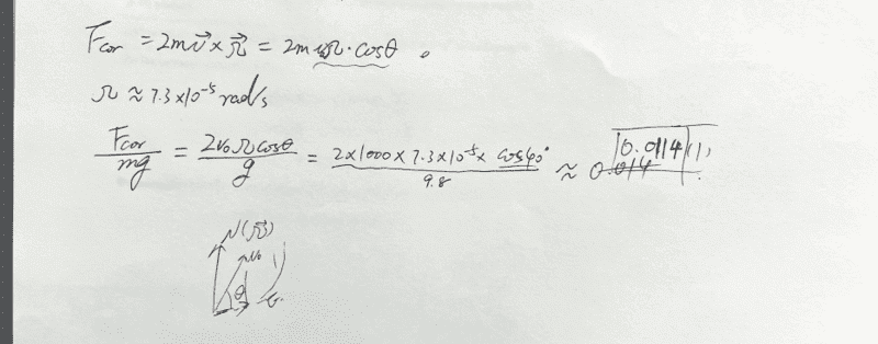

I am stuck at getting the right direction of the coriolis force.. I can get the force amplitude by formula tho...
Coriolis force, centrifugal force
So I don't understand "due north from a position at colatitude ##\theta## " , whether how I translate it...
I keep getting that direction should be radial...(toward Earth CM)
This is my work:
Thank you so much!

What is the direction of the vector ##\vec \Omega##? What directions are orthogonal to both that and due north?
