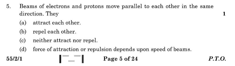

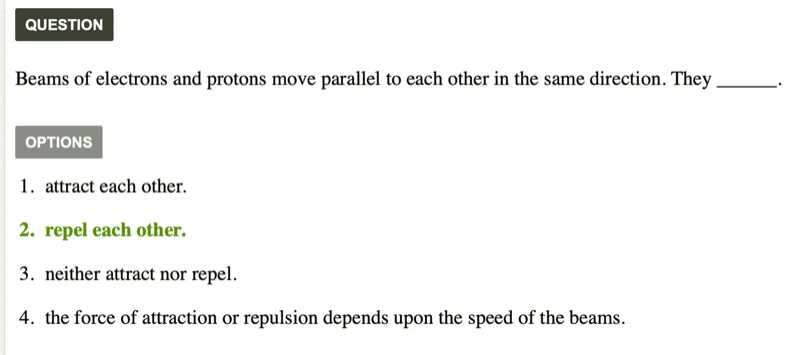

Beams of electrons and protons move parallel to each other in the same direction. They ______.
a. attract each other.
b. repel each other.
c. neither attract nor repel.
d. the force of attraction or repulsion depends upon the speed of the beams.
This is a previous-year-question of CBSE Board 2023.
The answer key marks (b) as the right option.
I want to know why we are ignoring Coulomb's force?

What happens if the speed of both beams is zero, or approximately zero?
This is a poorly worded question. Are they talking about one pair of beams one containing protons and the other electrons? Or one pair of beams each containing both protons and electrons? Or multiple pairs of beams one pair entirely of protons and another pair entirely of electrons?

Speed is frame dependent. Take the case where the speeds are equal and consider the frame where that speed is zero. Now we have two rows of protons and electrons at rest that repel each other?
I'd forgotten this puzzled me in the past: whether there is a magnetic field from a current must depend on the frame of reference. Turns out it takes SR to explain it.
Consider two parallel beams of electrons at the same velocity. The relative motion to the observer increases the electrostatic repulsion, and this exactly cancels the attraction created by the observed magnetic fields.
Full details at https://physics.stackexchange.com/q...forces-on-each-other-depending-on-frame-of-re.
So the answer to the question in this thread is a.

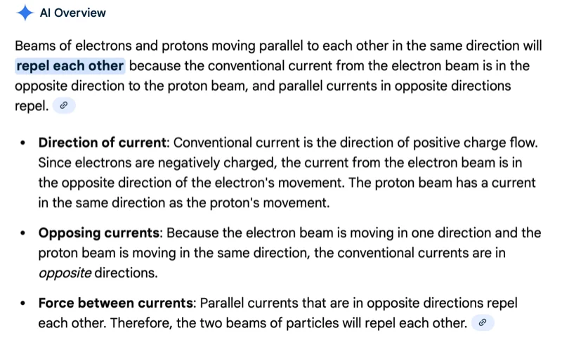

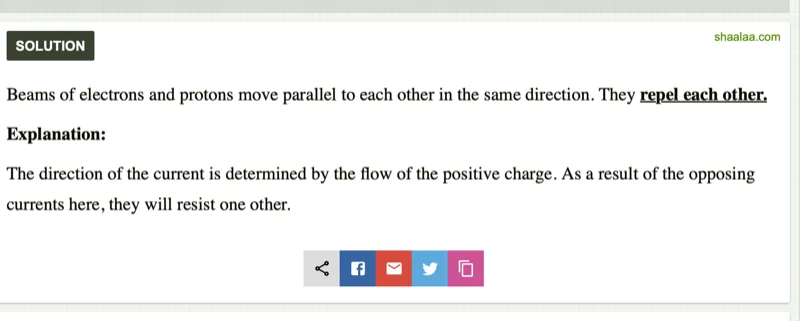

To muddy the waters some more, here is one of the many sites that feature this question
https://www.shaalaa.com/question-ba...ther-in-the-same-direction-they-_______356772
In it, the "correct" answer is as reported by the OP,
and farther down is the explanation of sorts

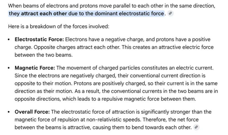

So I looked at the AI overview and I found concurrence that there be repulsion
Just to make sure, I "dove deeper" into AI and guess what?
Yay, there is attraction now !!!

From what I've seen, there are a lot of bad questions out there now. And a lot of wrong explanations. The common theme seems to be people who do not understanding physics changing a scenario and not understanding the impact of the changes. In this case, for example, neutral current-carrying wires have been replaced by beams of charged particles. And, whoever did that, as you yourself pointed out, completely forgot about Coulomb's law!
My advice is to keep your wits about you and trust yourself to some extent. A reliable textbook is unlikely to be wrong. But, these multiple choice question papers are littered with poorly phrased questions, wrong answers and wrong explanations.
Note also that @kuruman induced AI to give both the wrong answer and the right answer. There is a good lesson there as well about the limitations of LLM's. Again, keep your wits about you and double-check what you find online.

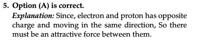

According to the marking scheme for this question paper (This is from 12th Physics CBSE Board 2023) the correct answer is option (b).
  • Sad
That answer would only be correct if the question meant that both beams in the pair were composed of protons or both beams were composed of electrons.

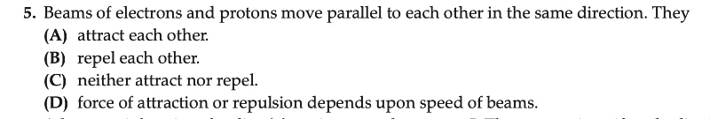

Please provide links or references. As I pointed out in post #10, there is at least one site that shows repulsion (option b) as the correct answer. However, I found this site, which appears official because it shows the pdf files with answers of the actual test, not reproductions or reinterpretations
https://www.oswaal360.com/pluginfile.php/10939/mod_folder/content/0/Latest Board Papers Files/CBSE Class 12/CBSE-12 physics Board Paper-2023.pdf
wherein the question in question is,
with the offered answer farther down
Moral: If it appears on the web, it's not automatically correct especially at points where artificial intelligence intersects natural stupidity.

You can find the question paper here and the marking scheme here. The concerned paper is 55/2/1.
I have included snippets for convenience.
The CBSE board has its ways of bending physics to its liking. /s
Again, the question is very poor because it can be interpreted multiple ways. The only way that it can be interpreted so that the given answer is correct is if it means that both beams are protons or both beams are electrons.
Thank you for providing the references.
And since the question mentions electrons and protons, both beams being of the same kind cannot be the case. So the answer is inconsistent with the question.

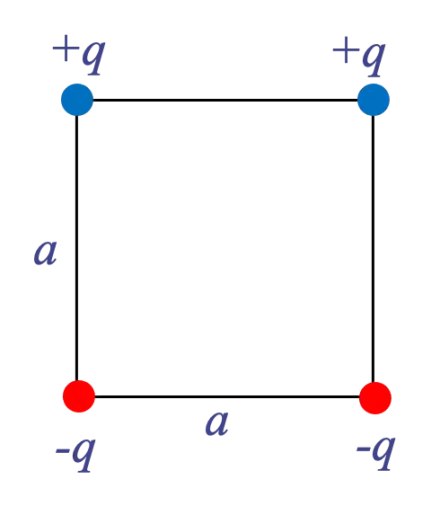

Let's say I have two beams, one with protons and one with electrons, traveling parallel to each other at the same speed. I'm looking at them from above. Do the beams converge or diverge?
As a layman I would say, they converge.
I agree, it would be odd if they diverged. To see this, consider the frame of reference moving with the beams. That is to say, the rest frame of the particles. In that frame, there is only the Coulomb attractive force.
Along these lines (and just for fun) I tried to imagine what will happen qualitatively in the very end. The two parallel beams sounded too complicated, so I considered four charged particles of equal mass held at the corners of a square. What will happen if they are released simultaneously? Classically, the conservation laws of mechanical energy (ignoring radiation by the accelerating particles), linear momentum and angular momentum hold.
The initial linear momentum of the CM is zero and remains zero. This means that the CM is at the center of the square at all times.
Each charge experiences a net force that produces a torque about the CM. Diagonally opposite charges experience force couples. The net effect is that the dipoles formed by diagonally opposite charges will rotate about the center of mass in opposite directions. This conserves angular momentum but not angular speed about the CM.
Finally, the initial mechanical energy of the system is in the form of the total electrostatic potential energy, $$U=-\frac{\sqrt{2}q^2}{4\pi\epsilon_0a}.$$ When the particles are released, they will spiral in towards the CM as the potential energy decreases (becomes more negative.) Mechanical energy conservation requires that the two dipoles increase their equal and opposite angular speeds about the CM.
So in the end I think this will have two counter-rotating dipoles at the center. Also interesting is a quantum mechanical description of the four-charge end result. I can imagine positronium-like atoms in the para or ortho spin state with high orbital quantum numbers.
What happens to two parallel linear distributions of many particles each is another story.
Yes. But if you have two straight parallel wires carrying current in opposite directions, they will repel. This is probably what the question's authors were getting at. Pedagogically it requires the student to understand that a beam of electrons moving one way is equivalent to a current flowing in the opposite direction plus that the magnetic force between these wires is repulsive. A purely pedagogical consideration: Two concepts in one question makes it impossible to determine which of the two concepts is misunderstood by a student who gets it wrong.
But as others have already pointed out, a beam of charge-carrying particles is not equivalent to a current-carrying wire, so that constitutes a conceptual error by the authors at the expense (or perhaps lucky benefit) of the student. Either way, it's typical of the crappy questions we see on lots of testing and assessment instruments. It's like they were authored by a committee. And you know the old joke that a donkey is a horse built by a committee.
