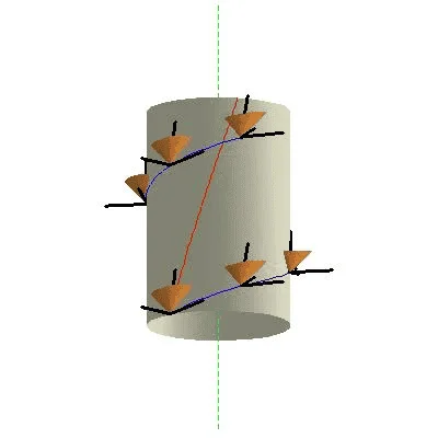

The hypersurface doesn't matter. You're only drawing a 1d line, not extending it into a plane. You can always draw a line segment perpendicular to one member of a congruence and extend it to a nearby one, then start again with a new perpendicular line.
For example, consider a concentric circle on the rotating disc. You an draw a line in the "world cylinder" thus defined that is everywhere perpendicular to the worldline of the point it's at - it forms a shallow helix in a (2+1)d Minkowski diagram. It doesn't close, which is a problem if you try to construct a plane out of it, but you don't need to form the plane to be able to make (spatial) arc-length measurements.

To me this topic of rotating disc is a bit of a headache.
Ibix said:
The diagram you posted in #19 explains how the local isotropy leads to a global anisotropy - if you Einstein synchronise successive pairs of clocks around the circle, you will define the blue helix and get back to your start point out of sync with the start clock by the proper time along a Langevin worldline connecting "levels" of the blue helix (the orange line).
The spacelike blue helix curve in #19 (defined by using Einstein synchronization) results to be orthogonal to the worldlines of the (subset) of Langevin congruence representing points/observers on the circumference at fixed radius on the rotating disc (I named ##S## this set). We can calculate its proper lenght by integrating along its path in flat spacetime. We can do the same along the subset (say ##C##) of the Langevin congruence's worldlines restricted to points on a diameter of the cirumference as seen in the interial rest frame of the center of the disc. The ratio between them is greather than ##\pi##. So far so good.
