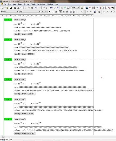

Basically I'm writing my MSc dissertation right now, and I've been doing a lot on primes
I've written all my code in MATLAB, but my supervisor told me today that MATLAB is crap for higher order arithmetic and the primes only go up to something like 10 digits long.
SO I'm kinda screwed right now, he suggests using Maple but I'm already so far through. Is there any way I can add something to MATLAB to make it store more primes? Or be able to factor an integer 100 digits long?

Unless you have a lot of compute power or time or "easy" numbers to factor I am guessing that 100 digit numbers are going to be a very very difficult challenge. 50 digit factors are still considered fairly impressive records.

Apart from the Symbolic Toolbox already mentioned, an add-on package is mentioned in this thread: https://www.physicsforums.com/showpost.php?p=3989820&postcount=3 ( http://www.mathworks.com/matlabcentral/fileexchange/22725-variable-precision-integer-arithmetic ).
An alternative produce to consider is Mathcad (it handles arbitrary precision arithmetic and has a Matlab interface and its programming is similar enough to Matlab to allow porting of many programs without too much effort). I've attached an image of part of a simple worksheet that factorizes the decades of ten (plus a small constant) and shows the times for each factorization ... some of them are quite lengthy.
Another package to consider is the non-commercial SMath, a Mathcad-like application that also does arbitrary precision arithmetic. I'm not sure whether it has a factor function.
