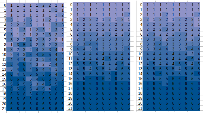

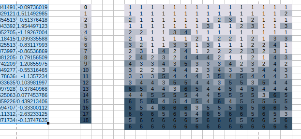

mfb said:
Quickly made in a spreadsheet with a width of 1:
The first one looks more chaotic than most other things I got, not sure why. Maybe a typo in the width.
That's very cool and exactly what I'm looking for!
Can you walk me through it again? (don't know how to do that in Excel OO-Calc) (Also, is the colour rendered formulaically, or added?)
I'm not sure what you mean by "width of 1". There's nine columns, so are each ... 1/9th?

mfb said:
Steps in LibreOffice:

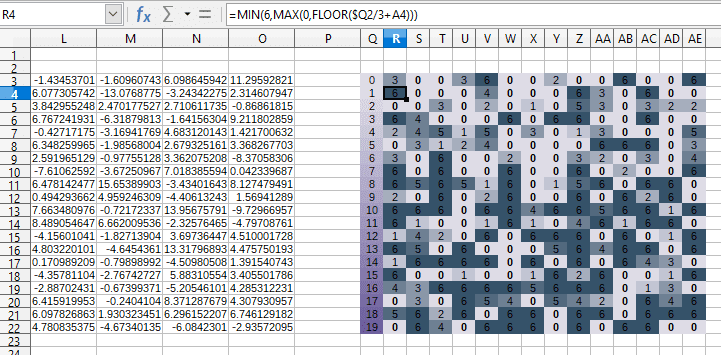

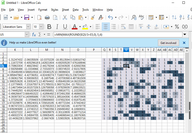

Sorry, I m totally not getting the expected results.
For one, there's no gradient. (Nor can I see anything in your instructions that I might have missed would create a gradient).
For two, they're mostly 1's. (Perhaps because the random numbers are often negative - which rounds to 1?)

If I'm understanding correctly, he's putting the numbers 0-20 in a column. Then, to make the unrandomised quilt he's taking the value from that column, dividing by 3, and rounding down. That gives him rows of numbers in the range 0-6, which he's using to set the colour.
To make the randomised quilt he's adding a random number before rounding down. Then he's just catching any numbers outside the range 0-6.
So cell Q1 needs to be zero.
Q2 needs to be =Q1+1
Copy/paste Q2 into Q3, Q4,..., Q21.
Set R1 to =min(6,max(0,floor($Q1/3+A3)))
Copy/paste R1 down to R21 and as wide as your quilt.

OK, well, I've done everything you said. Still no joy.
Quick test: replace all your random numbers with zero. Do you get the simple gradient?
I'd say you have the standard deviation of your Gaussian a bit high. Your random numbers are quite often 8 or 9. You just want them to be typically in the range ##\pm 1##, so that they occasionally kick a colour 4 into a colour 5. I'd suggest regenerating them with a standard deviation of 1.
