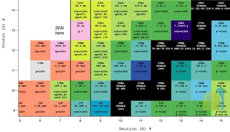

The discovery is so new that the radionuclide is not yet in the Chart of Nuclides. I expect there needs to be independent confirmation.
  • Agree
