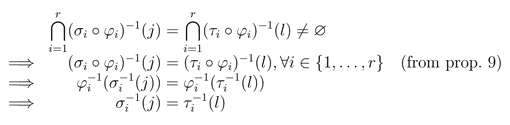

Using the align* environment I have the following output.
\begin{align*}
\bigcap_{i=1}^{r}(\sigma_i\circ\varphi_i)^{-1}(j)&=\bigcap_{i=1}^{r}(\tau_i\circ\varphi_i)^{-1}(l)\neq\emptyset\\
\Rightarrow(\sigma_i\circ\varphi_i)^{-1}(j)&=(\tau_i\circ\varphi_i)^{-1}(l),\forall i\in\{1,\ldots,r\}~~~(\text{from prop. 9})\\
\Rightarrow\varphi_i^{-1}(\sigma_i^{-1}(j))&=\varphi_i^{-1}(\tau_i^{-1}(l))\\
\Rightarrow\sigma_i^{-1}(j)&=\tau_i^{-1}(l)
\end{align*}
This looks ugly. How can I make it look better?

Is this any better?
Code:
\begin{array}{rr@{\; = \;}l}
&\bigcap_{i=1}^{r}(\sigma_i\circ\varphi_i)^{-1}(j)&\bigcap_{i=1}^{r}(\tau_i\circ\varphi_i)^{-1}(l)\neq\emptyset\\
\Longrightarrow&(\sigma_i\circ\varphi_i)^{-1}(j)&(\tau_i\circ\varphi_i)^{-1}(l),\forall i\in\{1,\ldots,r\}~~~(\text{from prop. 9})\\
\Longrightarrow&\varphi_i^{-1}(\sigma_i^{-1}(j))&\varphi_i^{-1}(\tau_i^{-1}(l))\\
\Longrightarrow&\sigma_i^{-1}(j)&\tau_i^{-1}(l)
\end{array}
It does not compile properly here, because Mathjax does not understand the @{\; = \;} specifier in the array description, and so the = signs get left out altogether. But it looks good in TeXShop.

I don't know why some compilers fail to process the @-expression in an array environment. It is listed in the LaTeX User's Guide as a standard part of the system (see here, for example). On my Mac, the TeXShop compiler renders that code as
(Click on that thumbnail to see what it really looks like.)

Hmm.. It'd be great if we could "center" the LHS and RHS. This "inverted-triangular" shape it making it look bad. Any solution?
Now I understand how the array environment works. Centering makes it look worse. I'll go with the same as you have in the quoted text. Thanks.
