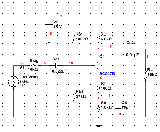

I have attached two different amplifiers with feedback, one of them is series-series amplifier and the second one is a shunt-shunt amplifier.
AC-Analysis:
Using the Hybrid-Pie transistor model
• Determine the amplifier parameters Rin, Ro , Mid-band gain A
• Determine the low cut-off (3-dB) frequency (Low-frequency Pole fL)
• Determine the High cut-off (3-dB) frequency (High-frequency Pole fH)
• Determine the Band Width (BW) and BW x Gain product.
ٍseries-series:
A = I_o / V_i
B = V_f / I_o
A_f = A / (1+BA)
R_if = R_i * (1+BA)
R_of = R_o * (1+BA)
shunt-shunt:
A = V_o / I_i
B = I_f / V_o
A_f = A / (1+BA)
R_if = R_i / (1+BA)
R_of = R_o / (1+BA)

  • Circuit schematic of a single-transistor amplifier with feedback: voltage source V1 with Rsig 10kΩ, Cc1 0.022µF, bias resistors Rb1 100kΩ and Rb2 27kΩ, RC 6.8kΩ, RF 100Ω, RE 1.8kΩ bypassed by CE 10µF, Cc2 0.01µF, load RL 10kΩ, and transistor Q1 BC547B on a 15 V supply.

i could only draw the ac circuit for the shunt-shunt amplifier with the feedback
i already know the formulas for the shunt-shunt:
A = V_o / I_i
B = I_f / V_o
A_f = A / (1+BA)
R_if = R_i / (1+BA)
R_of = R_o / (1+BA)
But i don't know how to find V_o, I_i, I_f?
