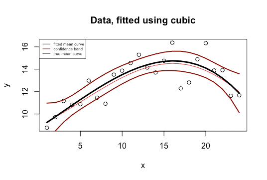

So let's say that there are several different treatments for being underweight. One way to deal with this is to make repeated measurements of each patient's weight across time. So I can fit a model to the panel data, regressing weight on treatment as an indicator variable, and then plot the different fitted mean trajectories along with their point wise confidence bands. Basically a plot of response vs time for all groups but accounting for the uncertainty of the paths as well. Also, say that scatterplot of suggests that curves might not linear so I have to do some sort of polynomial interpolation on the right hand side of the equation.
Moreover, say that I notice that some of the bands are convex for some treatment groups and some are not for others. Can I interpret this as some of the treatments have accelerating returns and some have diminishing returns?
I'm thinking that even if a confidence band for a particular trajectory is convex, I can imagine the true path being concave as a possible path within the band if the bands are particularly wide. Even if a convex shaped band were not wide, the true path may be concave for short intervals of time.

If I understand you correctly you are doing an OLS regression of weight (continuous variable) against time (continuous variable) and ##n-1## logical variables, being flags to indicate which treatment is being used, where there are ##n## treatments and one is chosen as the base. Let these variables be ##W_t^j## for weight at time ##t## for patient ##j##, and ##R_k^j## is true iff patient ##j## is receiving treatment ##k##. Let ##\vec R^j## be the vector with components ##R_1^j,...,R_{n-1}^j##, that specifies which treatment patient ##j## is receiving.
If the relationship of weight to time appears significantly non-linear, any confidence bands for ##E\left[W_t^j\ |\ \vec R^j=\vec r\right]## generated by basic OLS regression will be of little use.
A way to remedy this is to fit a reasonably nice non-linear function ##f_k## to the map
$$t\mapsto \hat W_{t,k}\triangleq E\left[W_t^j\ |\ \vec R^j=\vec r_k\right]$$
for each ##k\in\{0,...,n-1\}## where ##vec r_k## is the vector of flags for which only the ##k##th flag is True (this identifies Treatment ##k##), for ##k>0##, and ##\vec r_k=0## is the vector in which all flags are False (this identifies the Base treatment).
A common way to fit the functions ##f_k## is cubic splines.
We then regress ##W_t^j## against ##\vec R^j## and ##g(t,j)## where ##g(t,j)=f_{K_j}(t)## and ##K(j)## is the treatment being applied to patient ##j##, where 0 denotes the Base treatment.
If the splining process has succeeded, this regression will give reasonably linear-looking maps
$$f_k(t) \mapsto \hat W_{t,k}$$
and the confidence intervals should be meaningful.
EDIT: But having posted that (it took a while to write the latex), I agree with Dale's much more succinct response, which has come in while I was writing this.

So, from theory, I can determine if to include a curve or not. So say I fit a curve or splines in the model such that it is not linear. Can I just directly obtain the estimated variance covariance matrix of the model, ( vcov(model) in R), and then from that build up the confidence bands with loops across the time points, and do this for each of the treatment groups? That way I get to see the type of curvature that is manifested by the bands? So say there are 12 time points. From the variance covariance matrix, and the fitted estimates, I can get the CI for the response at time 1 for the base group, then I would do this again for all the other times, finally, I plot the CI's vertically at each time point.
Next, I do this for each group.
Is there a reason why the CI's constructed manually would be off?
I think from your method, I could determine which of the spline coefficients are significant or not, and get inference on whether there is any curvature or not. But would it tell me the direction of the curvature, if its accelerating or not? So if I fit a concave cubic, and it turns out to be statistically significant for say, group2(by doing group and time interaction), then that means that group 2 estimated response levels are decelerating?
But if everything is linearized, then how would I visualize the trajectories from the model?

Here is what I mean. This is an example of simulated data, and building of the confidence bands from scratch from the model estimates and the estimated variance covariance matrix for the model.

#fitting curve
x <- c(1:24)mu <- 10 + 5 * sin( x * pi / 24 )  - 2 * cos( (x-6)*4/24 )
# errors
set.seed(2010)
eee <- rnorm( length(mu) )
# data
y <- mu + eee
x.squared <- x^2
x.cubed <- x^3
fit <- lm( y ~ x + x.squared + x.cubed )
print( summary( fit ) )
# Look at the fitted model:
fitted.mean <- predict( fit )
# Plot
#preliminary plot
plot(x,y)
lines( x, mu, col="red" )
lines( x, fitted.mean, col="blue", lwd=2 )
title("Data, true mean curve (red), and fitted (blue) using cubic")
#estimated variance covariance matrix of model
vcov(fit)
#vector of regression parameter estimates
B=as.numeric(fit$coefficients)#function for getting the estimated response variable at any x
estimate=function(x){
  return(B[1]+B[2]*x+B[3]*x^2+B[4]*x^3   )
v=NULL#building vector of estimates to plot
for(i in 1:24){
  v=c(v,estimate(i))
summary(fit)n=24
p=4
qt(.975,n-p)#function for getting the confidence interval for response variable at any x
CI=function(x){
  k=c(1,x,x^2,x^3 )
  return( t(k)%*%B+qt(.975,n-p)*c(-1,1)*sqrt(t(k)%*%vcov(fit)%*%k))
}CI(5)
conf=NULL
#building matrix of CIs to plot
for(i in 1:24){
  conf=rbind(conf,CI(i))
conf[1,]#plotting it all together.
plot(x,y)
lines(x,v,lwd=3)
lines( x, conf[,1], col="darkred", lwd=2 )
lines( x, conf[,2], col="darkred", lwd=2 )
title("Data, fitted using cubic")
legend("topleft",c("fitted mean curve","confidence band","true mean curve"), col=c("black","darkred","red"),
       lty=1,cex=.5)
