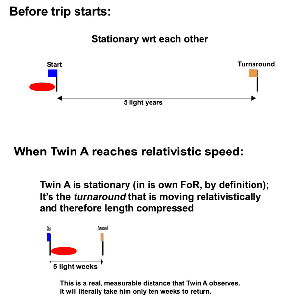

I'll chime in with a "me too" answer, in case other didn't do it for you.
  • Twin A has accelerated to near c (measured relative to his point of departure).
  • He observes that he is stationary (by definition) and everything else is rushing toward him, that includes his turnaround target, and everything in between.
  • Because everything in his path is moving relativistically, everything he sees is length compressed.
  • That includes the distance from his point of departure to his turnaround target.
  • From the moment he reaches near c, which might be on Day 1 - he measures his target to be - not 5 light years away but an easy 5 light weeks distant.
  • In other words, he doesn't have to travel 5 light years out and back - the trip is a very short distance for him - 5 light weeks.
  • Thus, when he arrives back home, he has - correctly - aged only 5 weeks.
TL;DR: by moving at a relativistic velocity, Twin A's actual measured journey is length compressed from 5 light years to 5 light weeks. And he correctly only ages 5 weeks during each 5 light week leg of his trip.
Diagrammatically:
Diagrammatically:

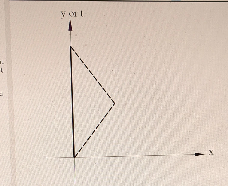

The whole of the twin paradox is therefore trivial: the twins followed different paths, the "distance" along those paths was different, and therefore they had different elapsed times.
The complexity is in demonstrating that "distance" through spacetime is a meaningful concept distinct from distance through space, that it corresponds to elapsed time on a clock, and dealing with the consequences of the differences between the "distance" through spacetime and distance through space. (Those differences are why I keep putting scare quotes around "distance" - it does have some different properties, which is what makes 4d spacetime different from a 4d space.) Conceptually, though, it's very little different from the idea that you can draw two paths from point A to point B on a piece of paper and the paths need not be the same length. All "why" and "what causes it" questions do turn out to have the same answer in both the space and spacetime cases. So what would you accept as an answer to what causes two different paths on a piece of paper to have different lengths?

It's not a paradox because their journeys were never symmetrical—one took the direct, "longest" route through time, while the other took a shorter shortcut by travelling through space.
However, the first postulate of SR says that there is no concept of absolute (inertial) motion through space. Neither twin is moving through space any more fundamentally than the other.
That is misleading, or even wrong. Things "move" through spacetime, that is - they have worldlines. And the "lenght" of these worldlines is proportional to proper time. Worldline of one of the twins is shorter (in terms of spacetime metric) then of the other. End of story.
All of which was already explained by Laue in 1911:
https://en.wikisource.org/wiki/Tran...the_Theory_of_Relativity_and_their_Refutation
Laue said:
Einstein's experiment, however, is represented by a curved worldline, which (in a worldpoint A) decomposes into a row of curves, and all of them will be re-united at a worldpoint B to a single line. Of all curves connecting the points A and B having time-like direction throughout, the straight connection has the longest proper time; that is the meaning of Einstein's consideration.
Hopefully we don't have to wait another 110+ years before everybody understands this.
This image may help. The brother on Earth follows the vertical line. The traveling brother moves out the x-axis, and then returns. On a map, he would have traveled further. But, in space time, s^2=t^2-x^2, so he has traveled a shorter space-time 'distance'.

I think I understand your question. The traveling twin A is NOT making a 10 lightyear trip at almost C. He is making a much shorter trip at almost C, so it takes him less time. Remember length contraction! Relative to twin A, he is at rest (except during turnaround) and everything else is moving near C. So the distance between earth and the star contracts to much less than the 5 lightyears that a person on earth measures. If you work out the math from the astronaut's point of view and again from earth's point of view, the final results agree, although they disagree about times and distances.
Yes. This is often omitted in descriptions of relativistic trips from A to B.
What twin A observes is that his destination is not so much a planet as a pancake seen face-on. And it's not 5 light years away, it's a mere few light months away. He travels there and arrives home again in less than a year, having hardly aged at all.
This is only part of the picture.
First, in order to apply length contraction to the Earth-star distance, as you are doing, we have to consider the traveling twin to be at rest, and the Earth and star as moving. That means that, on this view, it's not the twin, it's Earth and the star that are making a much shorter trip at almost ##c##, so it takes less time.
But this still doesn't solve all of the problem, because on this view, the elapsed time for Earth and the star is also much smaller than the elapsed time for the twin! (That's because, on this view, it's Earth and the star that are time dilated, relative to the twin.) So if we just take what's said above into account, we will predict--wrongly--that clocks on Earth will show less elapsed time when the traveling twin returns! So there must be another missing piece involved to explain why Earth clocks actually show more time (a lot more, if the traveling twin's speed relative to Earth is almost ##c##) when the traveling twin returns.
I strongly suggest reading the Insights article that's linked to in post #2 of this thread, and also the Usenet Physics FAQ article that is linked to in that article. In the latter article, the "Time Gap" section discusses the problem I described in the last paragraph.
Not on this view, he doesn't. On this view, he's at rest the whole time. See my post #26 just now.
He is free to interpret what he sees. He does know he's in a spaceship, so he is perfectly with his rights to look out the window and intuit that it is he who is racing toward a pancake-shaped planet that is a mere few light months away.
It's just another way to reconcile the disparity in travel times between the twins.
Not if he's going to say that the Earth-star distance is length contracted to a few light-months. That claim requires him to be using an inertial frame in which he is at rest and the Earth and star are moving at close to ##c##. In a frame in which he's the one moving and the Earth and star are at rest, the claim is simply false.
He might "intuit" this, but if his intuition leads him to the reasoning expressed in post #24, then his intuition is wrong. See above.
He doesn't know anything about relativity or length contraction. He simply knows he is in a moving spaceship (because he was there when it lifted off), and he does no calculations.
He simply empirically observes that his destination, seen through the window, is a mere few light months away (and flattened). That is how he can travel there (and back) without aging much from his naive, empirical point of view.
This POV is not intended to resolve every mystery for him (such as why the planet he's approaching is pancake-shaped), the point is simply that his trip - as experienced naively by him - from A to B, only last a few months because it is only a distance of a few light months.
It is just backing up what kochanskij said:
  • Skeptical
