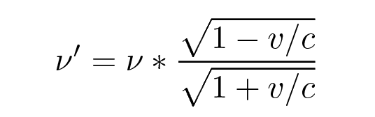

Suppose the twins have super telescopes and can see each other throughout
the trip. As long as they are traveling apart, the twins will see each other as
aging at 1/3 speed. As long as they are traveling towards each other,
the twins will see each other as aging at triple speed, thanks to the Doppler shift.
The difference is, the traveling twin will see the stay at home twin as aging at 1/3 speed for the 3 years to Alpha Centauri,
and at triple speed for the 3 year trip back to Earth for a total of 3* 1/3 + 3*3= 1 + 9= 10 years. The stay at home twin will see the travel age at 1/3 speed for 9 years, the 5 years it takes the traveler to get to Alpha Centauri,
plus the 4 years it takes the light to get back to earth. Since the total trip will take 10 years, the stay at home twin will see the
traveler age at triple speed during the one year he observes the traveler coming back to earth. The Earth observer sees the traveler
age at 1/3 speed for 9 years, and at triple speed for 1 year, for a total of 1/3*9 + 3*1 =3+3=6 years.
Both observers see each other aging at the same slow rate while moving apart, they see each other aging at the same fast rate while moving
together. The difference lies in one observer deliberately changes the relative motion of his rocket from moving away from Earth to
moving towards earth, and the other observer remaining passive, and not seeing the change until the light from the traveler reaches earth. If the Earth could be accelerated like a rocket ship, and the earthbound observer decided to change his frame so the rocket appeared to be moving towards him at 4/5 lightspeed
rather that away at 4/5 lightspeed, while the rocket remained in motion past Alpha Centauri, then it would have been the Earth twin who
appeared to age less.
Of course you could have some intermediate situation where BOTH observers decide to change their relative motion before they see the
other observer change his motion.
