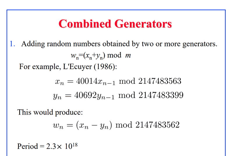

Slide titled Combined Generators: adding random numbers from two or more generators, w_n = (x_n + y_n) mod m, with L'Ecuyer (1986) example recurrences x_n = 40014 x_{n-1} mod 2147483563 and y_n = 40692 y_{n-1} mod 2147483399.

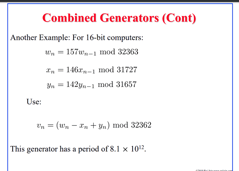

Slide titled Combined Generators (Cont), showing two linear congruential recurrences w_n = 157w_{n-1} mod 32363 and x_n = 146x_{n-1} mod 31727, a third y_n = 142y_{n-1} mod 31657, and v_n = (w_n - x_n + y_n) mod 32362.

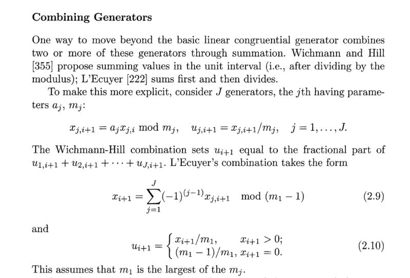

Textbook page titled Combining Generators, with text on summing outputs of several linear congruential generators and equations 2.9 and 2.10 for L'Ecuyer's combination.

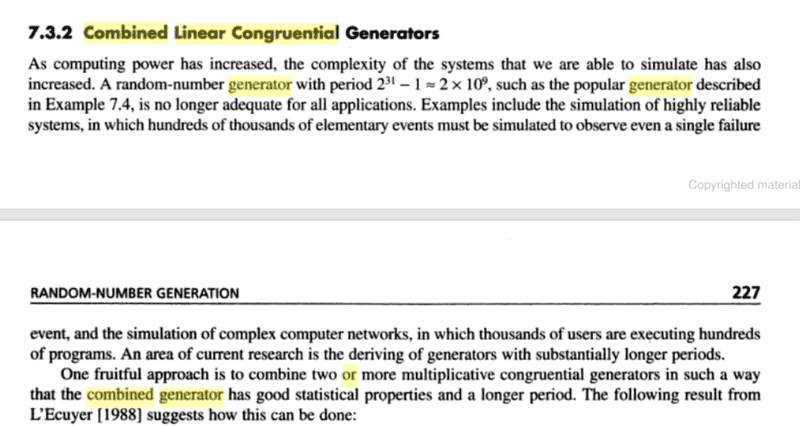

Textbook page excerpt, section 7.3.2 'Combined Linear Congruential Generators', with the words generator, Linear, Congruential and combined highlighted in yellow; body text discusses random-number generators with period 2^31 - 1 and simulation of complex systems, page 227 of Random-Number Generation.

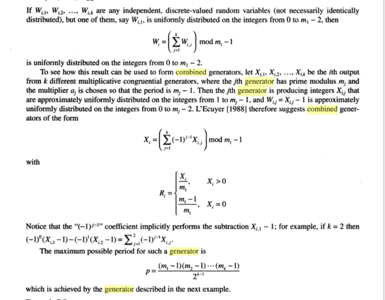

Printed textbook page on combined multiplicative congruential generators, with equations for W_i and X_i combining k generators, the R_i output formula, and the maximum period p = (m_1 - 1)(m_2 - 1)...(m_k - 1)/2^(k-1).

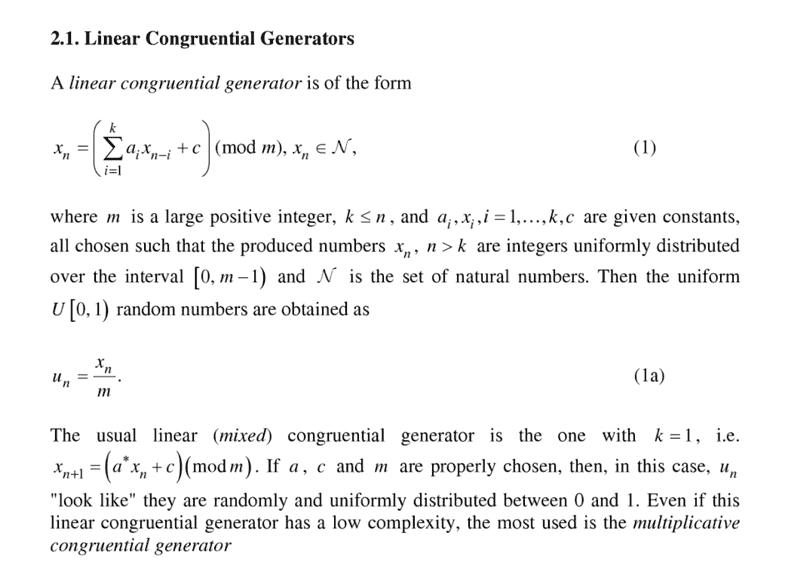

Printed textbook page under heading 2.1 Linear Congruential Generators, giving the recurrence x_n = (sum from i=1 to k of a_i x_{n-i} + c) mod m as equation (1), with u_n = x_n / m as equation (1a), and the mixed LCG with k = 1.
This tells LCG and Mixed LCG is same thing in usage.

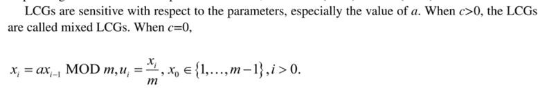

Typeset equations defining a linear congruential generator: x_i = a x_{i-1} MOD m, u_i = x_i / m, x_0 in {1,...,m-1}, i > 0, with text above saying LCGs are sensitive to parameters and that c>0 gives mixed LCGs and c=0 is the other case.

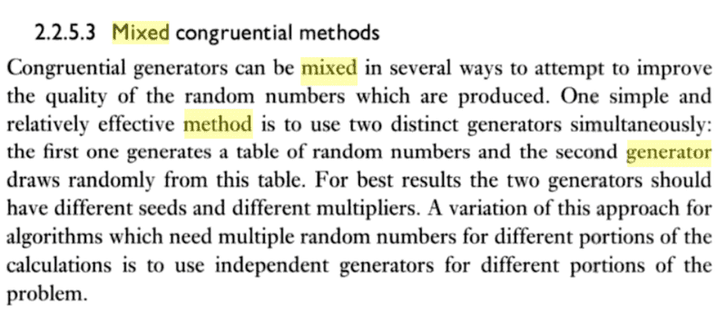

Printed textbook page, section 2.2.5.3 Mixed congruential methods, with the words mixed, method and generator highlighted in yellow. Text describes using two distinct generators together to improve random number quality.

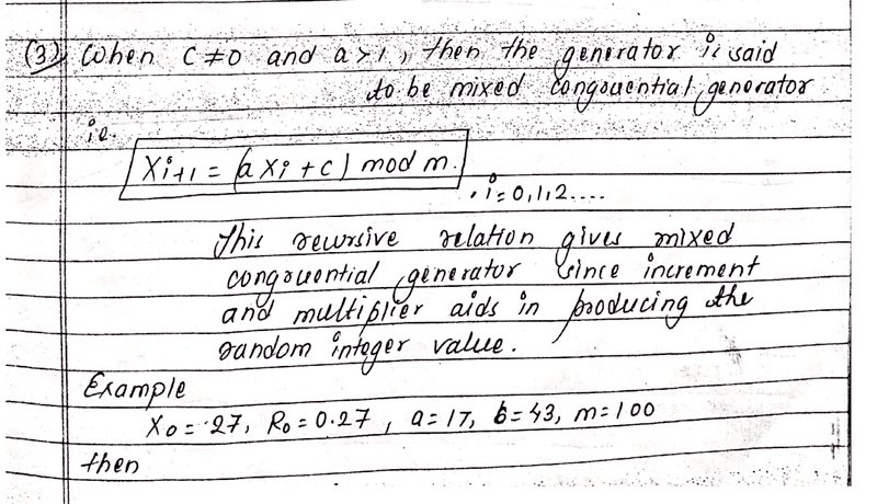

Handwritten notes: (3) When c ≠ 0 and a > 1, then the generator is said to be mixed congruential generator, i.e. X_{i+1} = (aX_i + c) mod m, i = 0,1,2,... followed by an example with X0 = 27, R0 = 0.27, a = 17, b = 43, m = 100.

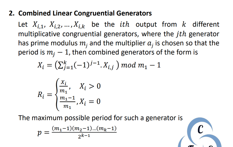

Text from lecture notes defining combined linear congruential generators: the combined output X_i equals the sum of (-1)^(j-1) times X_{i,j} mod m_1 - 1, with R_i defined piecewise and maximum period p = (m_1-1)(m_2-1)...(m_k-1)/2^(k-1).

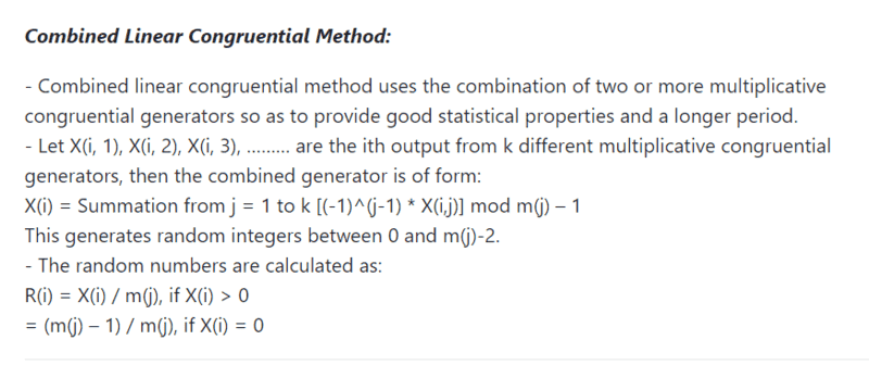

Text excerpt titled Combined Linear Congruential Method: defines the combined generator as X(i) = sum from j=1 to k of [(-1)^(j-1) * X(i,j)] mod m(j) - 1, and gives R(i) = X(i)/m(j) if X(i) > 0, else (m(j) - 1)/m(j) if X(i) = 0.

  • A linear congruential generator (LCG) has the form ## x_{n+1} = (a x_n +c) \bmod m ##.
  • A mixed congruential generator is an LCG with ## c \ne 0 ## (edit: presumably because it has a 'mix' of a multiplicative and constant term).
  • A multiplicative congruential generator (aka Lehmer RNG) is an LCC with ## c = 0 ## (edit because it only has a multiplicative term).
  • A "Combined Linear Congruential Generator" is simply a combination of two or more LCGs: one example is the Wichmann Hill generator I see mentioned in one of your references; again wikipedia has more on these: https://en.wikipedia.org/wiki/Combined_linear_congruential_generator
