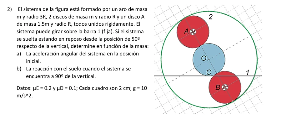

Good afternoon,I am an aerospace engineering student and I have some problems with an exercise in classical mechanics from a university exam so I need some help solving it.
Forces and momentum equations for Newton

Can you translate it into English please? Thanks.
Also, you need to show your best efforts to work the problem before we can offer tutorial help. Can you show us your work so far?
OCR of the screen.
2)
The system in the figure consists of a ring of mass m and radius 3R, two disks of mass m and radius R, and a disk A of mass 1.5m and radius R, all rigidly connected. The system can rotate about the fixed bar 1. If the system is released from rest at a position of 50° with respect to the vertical, determine, as a function of mass:
a) The angular acceleration of the system in the initial position.
b) The reaction force with the ground when the system is at 90° from the vertical.
Given: ρi = 0.2 and ρ0 = 0.1; Each square is 2 cm; g = 10 m/s².

I think aro means ring.
Angular acceleration is a vector defined for a rigid body, not a system of rigid bodies. As a whole, it's a great problem — practically impossible to understand.
Antonio18 said:
a) La aceleracién angular del sistema en la posición inicial.
Antonio18 said:
... , todos unidos rígidamente.
todos unidos rígidamente. = all united rigidly.
Baluncore said:
... , all rigidly connected.
It is a single rigid system of bodies, rotating about a single fixed axis.

Good morning! I tried my best to do the exercise, but the biggest issue is that the disk slides. Therefore, I believe it is necessary to solve it using energy equations. Thank you everyone for helping me, I really appreciate it.
