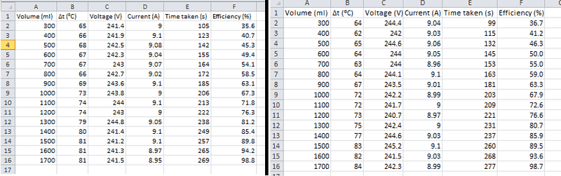

Here's the two that I have atm.
Just a side question, when talking about the greatest uncertainty, what points do you have to explore?
Okay, that looks quite odd. I would not expect the efficiency to increase like that. Do you have a sketch of the experiment? Where and how exactly where those values recorded, especially the temperature? What was the initial water temperature?
For each volume, you have two measurements - you can calculate the difference between those two and then compute the uncertainty based of this (using the approach from post #11). The average over 16 sets should give a reasonable estimate for the statistical uncertainty.

Do I need the initial temperature to draw out the raw results? Could the fluctuations in the temperature on different days affected the results I got in the change in temp?

Was it increasing slower or faster than what you expect?
I would not have expected differences that large, and the high efficiency values for the largest volumes surprise me.
