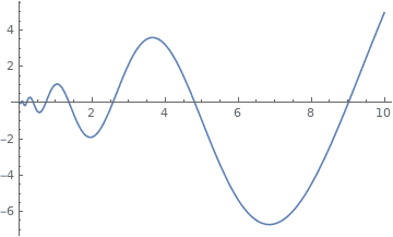

In a similar spirit, is it possible to assign a value to the integral of a function like this: ##f(x)=x*sin(x)##

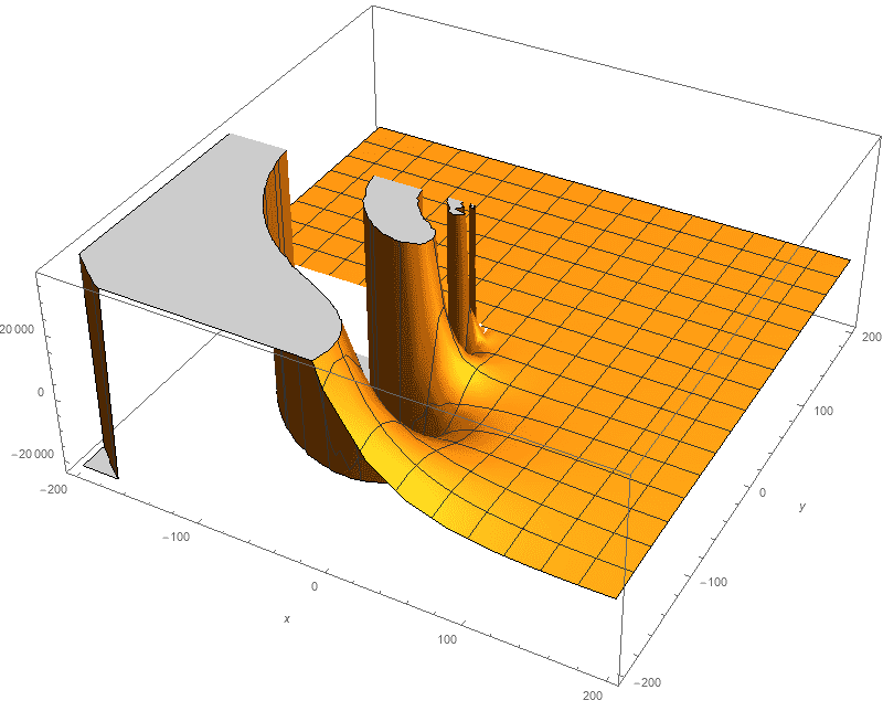

##g(x)=Re(x^{1+5i})##

Perhaps "meaningful" is not the best term here. In the case of divergent sums, Hardy uses words like "reasonable" and "natural". So speaking very loosely, a procedure for which one can claim that it is the summation of a divergent series in some justifiable sense*, and which yields the correct answer for convergent series, and behaves like a conventional sum as much as possible.
So my question was, is there an analogous notion for integration that would extend the idea of a convergent integral and help to define the integral of a divergent, oscillating function?

If anything works for this kind of function at all, then its probably the residue theorem. But you need to turn it into a holomorphic function first (g(x) is not one).
I needed to look up the residue theorem, which I have done and got some very basic understanding.
I'm also trying to understand the properties of ##f(z)=z^{(a+ib)}##. For example, with a+ib = 1 + 5i there is a discontinuity along the negative real axis. Is this the reason that we say ##f(z)## is not holomorphic? Can we select a contour that avoids the break, such that it will help with the g(x) in my OP?
And BTW, is the discontinuity along the negative real axis caused by the argument (angle) of z going from ##\pi## to ##-\pi##?
