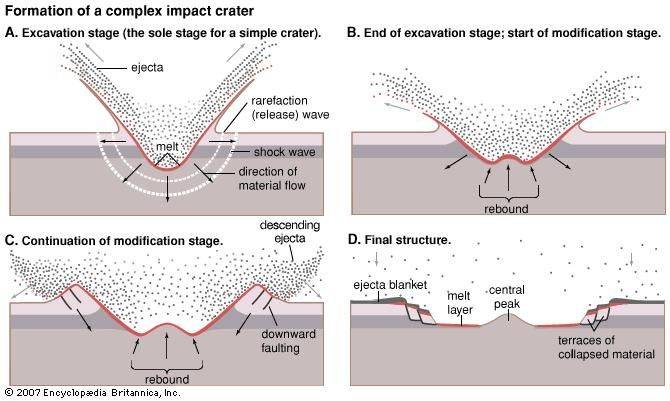

If you've ever looked into why craters are always circular, even when the meteorites come in at a really oblique angle, it's basically that. The kinetic energy scales much faster than momentum.
When it impacts some depth into the asteroid before blowing up like a nuke, you're going to have a lot of ejecta.
Indeed. I knew they did, never quite got the rationale why.
Due to its larger mass, that ejecta can then carry much more momentum away, than the spacecraft ever came in with.
