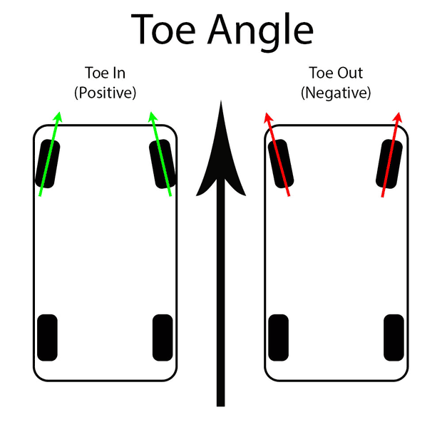

Help Adjusting for Toe
It seems that "most" stock sedans do not have adjustable caster, camber and turning angle, provisions are only provided to adjust toe only. I'm trying to find a way to DIY this at home, if this is possible, and had some questions on the theory behind it.
For my car, the stated toe specification for the front is "Front toe-in 0 +/- 2 mm (0+/-0.08 in)", from the service information from the manufacturer.

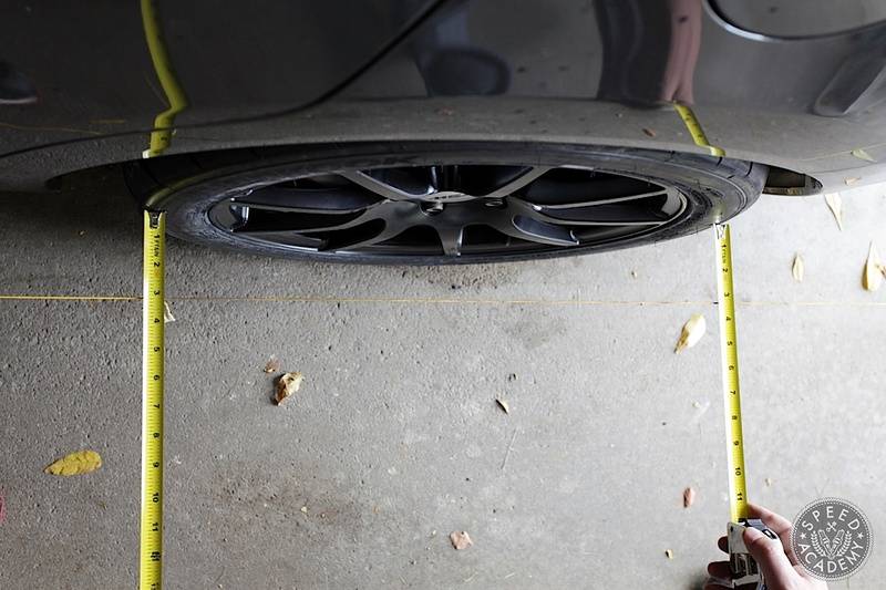

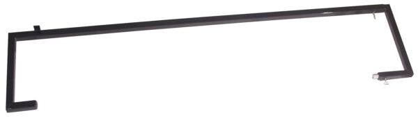

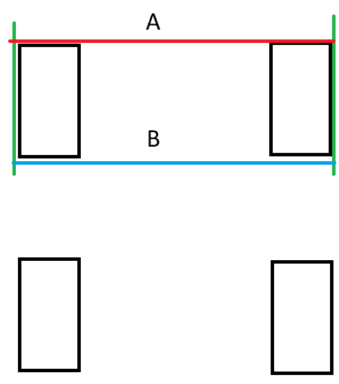

I see that there are toe plates, that you can purchase to attempt to DIY an alignment.

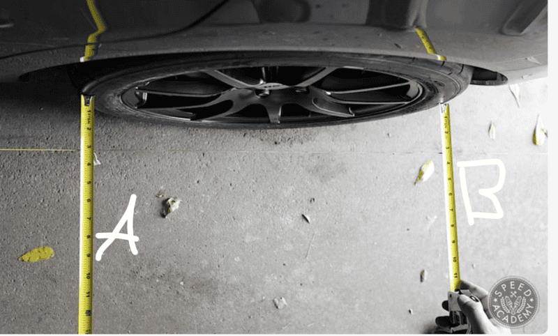

The basic theory in using this tool is that you place the plate up against the wheel, and take two measurements on either side.
I then subtract the length of line A vs the length of line B. I believe this term is called "Total Toe"?
If( A - B > 0 ){
Toe Out
If( A - B < 0 ){
Toe In
if( A - B = 0 ){
Neutral Toe
This is pretty simple and straight forward.

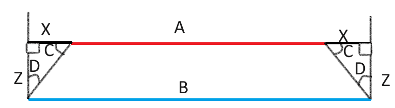

However is the specified toe "Front toe-in 0 +/- 2 mm (0+/-0.08 in)" the "Total Toe" or the toe for each tire? If this is the toe for each tire, I don't see how to make this adjustment.

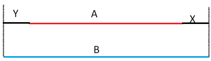

I'm not sure that I could just "assume" equal toe of each tire before adjustment. What I mean by this is that the difference between line segment lengths A and B are split evenly on either side of the line segment. In this rough sketch, I labeled both sides "X", indicating that I'm intending them to be the same length. Where abs(A - B)/2 = X
When in reality, I don't see why the difference has to be necessarily equal to each other and I can have this situation, where abs(A - B) gives me some variable Z that is equal to X + Y, and X =/= Y
If I could "assume" that the difference is split on either side evenly (which I doubt), I could see how I could do some simple trigonometry to find various angles. Given that the diameter of the tire, Z, is known and specified by the manufacturer of the tire.

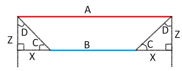

In the toe in situation, which angle is the "toe of the tire" C or D?
And in the toe out case, which angle is the "toe of the tire" C or D? Exaggerated to allow myself easier time drawing the picture, but you get the point.

First, I hate toe measured as a distance. It is very confusing as it is an angle. If you can find the spec as an angle value it is much clearer, otherwise convert it.
The "toe" is actually a measure of the "total toe" between two wheels on the same axle as being the difference between the centerlines of the tires measured at the rear edge of the tires minus the one measured at the front edge of the tires. So the toe for each tire requesting a total toe ##±2## mm on a ##645## mm tire diameter would be:
$$\sin^{-1}\left(\frac{±1}{645}\right) = ±0.09°$$

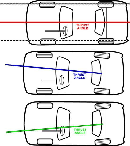

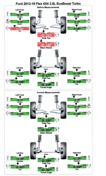

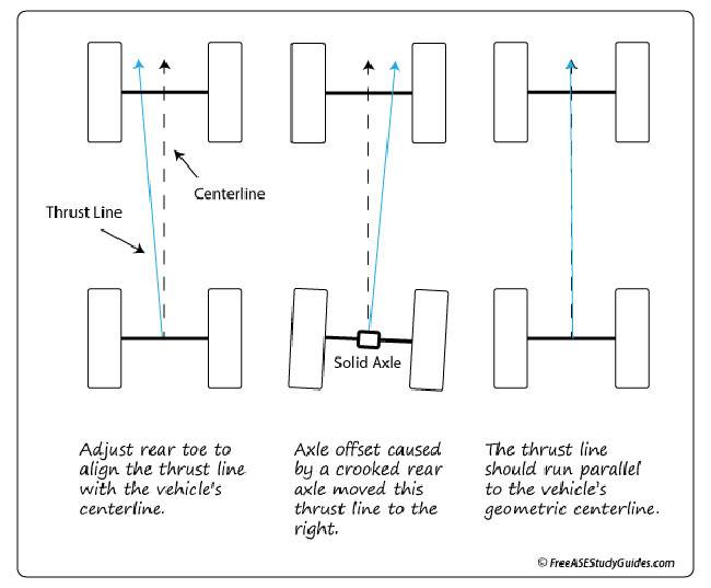

Setting the toe always begins with the rear axle. The rear toe will determine the thrust angle. The thrust angle is the angle between the car centerline and the thrust line.
Whether the rear toe is adjustable or not, the thrust angle will most likely not be 0°. You have to set your front toe according to that thrust angle otherwise, you will end up with what is called steer ahead, or how much you have to steer your front wheels to drive in a straight line.
Always D. It is the angle with respect to the centerline for the rear and should be with respect to the thrust line for the front. The value measured is always toe-in, thus toe-out values are always negative.

I do not see how having the car up in the air would change the lengths of line length A and B.
Not only toe will change, but also the camber and wheel track will change too. A and B will most likely be different and the setting will not be done at the correct ride height.

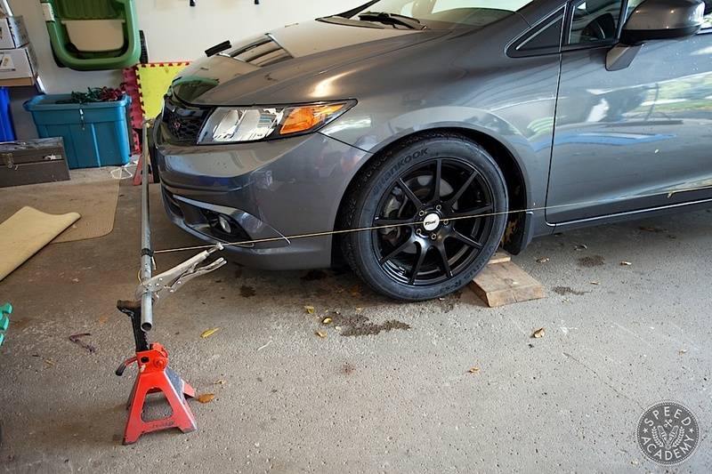

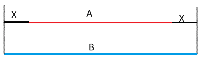

The way I have done it in the past was by using two reference lines, one on each side of the car. I've seen two wood beams mounted on cans but I simply used two strings set at the axle height.
You can easily set those reference lines parallel by measuring the same distance at the front & rear ends of the car. It may not be parallel to the vehicle centerline though, but it is easy to find the angle between your reference lines and your centerline (The line going through the middle point of your front & rear tracks).
Then you can measure the distance from these reference lines to the rim edges of each wheel. With these measurements, you can find the "toe" for each wheel with respect to your reference lines. You can correct these angles to find the actual toe angles with respect to your centerline. You also now know the angle of your thrust line.
This is a lot of manual labor and needs some intensive computations (An Excel sheet seems appropriate to do the calculations) but it basically costs nothing in hi-tech tooling.

However, this whole idea of a thrust angle, is a new idea to me, but you explained it well, and makes me question a few things with regards to front toe. It's good to learn. Sounds like rear toe needs to be adjusted first, otherwise, you cannot measure front toe.

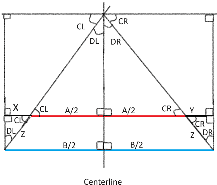

Making a corrections to my previous picture
  • Putting the Variable Z where it's supposed to be as the diameter of the tire
  • Labeling DL, CL, CR, and DR, for "C Left", "C Right" etc.
Let's take the rear toe in case.
  • I measure and observe the length of line segment A.
  • I measure and observe the length of line segment B.
  • I know the diameter of the tire Z, it's specified by the manufacturer
  • I know that in order to alignment the rear toe, the length of line segment B should larger the length the length of line segment A.
After reading through your explanation a few times and looking at the rough sketch, I still seem a bit confused. For a total toe of +/- 2 mm on a 645 mm tire diameter, why would you calculate the toe of each tire as:
It seems like this would assume that the specified toe of +/- 2 mm would be split between each tire evenly, meaning X would be equal to Y in my picture. If this assumption is accurate, than the calculation above would seem to be correct. Can this assumption be made though, and if so why? Is it just the ideal case for the toe to be split evenly? To me it would make sense to do this, but I'm not sure if it can just be assumed that this is the case? I can measure A and B, but won't be able to know if the difference between A and B is split evenly or not.
Sorry if I'm being a pain, I just want to make sure I have a true understanding of this. The technicians performing the alignment, most likely don't know the math behind it, and they don't need, they just need to get the angles in the green for the customer. But as a result, the math is a bit hard to understand.
If the toe is not even on both sides, the axle will steer. Setting up toe to a wheel introduces a lateral force on the tire. If both sides have equal and opposite forces, the vehicle goes in a straight line; if not it steers.
Imagine having the requirement of 0° toe (A = B) but one wheel has 10° toe-in and the other 10° toe-out. You have both wheels steered 10° in one direction and you will have to turn them back 10° with your steering wheel to drive the vehicle in a straight line. This causes two problems:

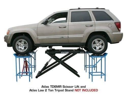

Following is a setup to do an alignment with stands and turntables. It requires lifting the vehicle 3 feet high but you could have lower stands, just enough to clear the ground:
How difficult it is depends on how fussy you are.

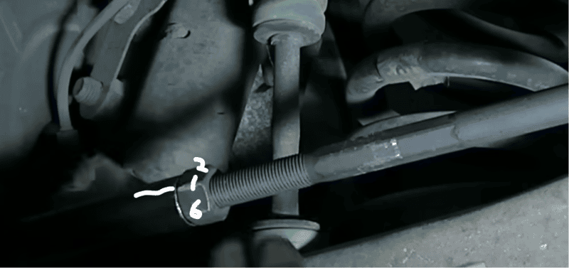

Hey thanks! So I understand now that after the alignment is performed, the toe angle on each tire should be the same. This allows the vehicle to travel in a straight line. I think I understand the math now, and the angle. I understand this. However, is it safe to assume that my car current (before an alignment), that the toe on each tire is the same. Assuming that I hadn't gotten into an accident, or replaced any suspension components. I don't know if the rate of wear in ball joints, ride height lowering with age/time/wear, etc. would be the same for the left and right tires? This seems like a reasonable assumption to make. I just want to make sure that this indeed the assumption that is being made, and if it is a valid one? If this is the case, then I see how adjusting toe can work, easily. If this is not the case, I'm a bit confused on how you can DIY this.
If this is indeed the case, if I take for example the front toe, with front steering. Toe is adjusted via outer tie rods. So I could mark the outer tie rod nut in some way with a paint marker corresponding to a point on the nut that rotates with the inner tie rod, and put numbers on the points of the nut. Something like this.
As I rotate the nut, I can keep track of how many revolutions I do of the inner tie rod. What I do to one side, I should do to the other as well, because we want the same toe on each side.
1) Take measurement with toe plates, see if within the specification
2) Lift up the vehicle
3) brake loose the nut on the inner tie, while making sure to hold the inner tie rod to prevent it from rotating; do this to both sides.
4) Move the nut up the inner tie rod a few threads to allow for rotation of the inner tie rod to occur; do this to both sides
5) Rotate the inner tie rod and the nut will move with it. Keep track of how many many revolutions (including any partial of a revolution) you do by referencing the line you made on the outer tie rod and the numbers you wrote on the nut; apply the same number of rotations (including any partial of a revolution) to the other side
6) Retighten the nut to ensure no additional rotation
7) Put car back on ground
8) bounce on the suspension a few times
9) Repeat steps 1-8 as needed until within specification

When I measure A and B in the front, I need B to be larger than A by no more than approximately 2.5 tick marks on a typical measuring tape with a resolution of 1/32 of an inch.
When I measure A and B in the rear, I need B to be larger than A by no more than approximately 5.5 tick marks on a typical measuring tape with a resolution of 1/32 of an inch.
Looking at how small the displacement is of 1/32 at a tape measure in real life, I think even the thickness of the toe plate would need to be taken into consideration, as it might be thicker than 1/32 of an inch, and would be good to take the measurement on the inside of the toe plate, so the thickness of the toe plate doesn't throw the measurement off.

I seem to have a good understanding now. The only way it seems that this can be done via DIY is what people have mentioned with reference lines, blocks of wood, etc.. The rear of the vehicle, toe is adjusted with respect to the centerline of the axle. I would need two lines parallel to this centerline, or account for the angle difference. Than take two measurements from these parallel lines to the rim.
I'm not really sure what are the use of toe plates, except to check for total toe. But sense we don't know the toe of each tire. Doesn't seem to useful, other than to check to see if the total toe is off and you need an alignment. But even if the total toe is correct, you could still need an alignment, because the toe for each tire may not be equal. Is there a more useful DIY tool to check the toe of an individual tire, other trying to create your own reference lines and taking measurements from them?
A similar process would be required for the front, except instead of the centerline, my measurements would be with regards to the thrust angle line. In my case for the front, I would want the two measurements to be within 1 mm of each other for each wheel. Not only that I would want the same difference for the other tie on the front axle. Can this be accurately done via DIY? It would seem that even variation in the thickness of what I'm using for reference lines to the rim (if that is what I was measuring to), a block of wood, or metal plate, or a piece of string, could throw off this measurement. 1 mm is roughly the thickness of 10 sheets of paper or a dime. I could always use cheap harbor freight micrometer, and use string up against the rim. Just not sure how accurate I can be on the order of magnitude of 1 mm. Or I guess technically even smaller, 1/100 of an inch or about 2.5 sheets of paper thick.
If with a micrometer I measure 0.01 inches for the front of the tire, and 0.04 for the rear of the tire. I see that I'm within specification of slightly less than 0.04 inch difference. I would then adjust toe on the other side so that I can the same measurements to produce the same toe angle.
The spec is 0mm for the front. Ideally, A should be equal to B. But you are allowed to go from -2mm to 2mm, thus A or B can be the longer measurement.
Just to make sure I'm understanding here. I could in theory use toe plates and align the front pretty easy to ensure that have zero toe. The two measurements, A and B would just need to be equal. I could get this with a typical non-specialty tape measure from the hardware store that is accurate to within 1/32 of an inch. Or could get highly accurate tape measures that are a bit more expensive that have 1/50, 1/64, or even 1/100 of an inch graduation marks.
But, if I'm understanding correctly, while I could get zero toe with a high accuracy for the front axle, I will not be able to confirm if that zero toe is indeed really zero along the thrust angle axis, or some other unknown axis. Therefore it wouldn't really be accurate.

Would below work to get back to the previous alignment after replacing part? I don't see why not.
1) Using toe plates, take your two measurements, A1 and B1 of front tires.
2) Replace outer tie rod on LH side.
3) Lower car back onto ground and take two measurements using toe plates, A2 and B2.
4) Adjust outer tie rod on LH side.
5) Repeat steps 3 and 4 until A2 = A1 and B2 = B1.
Seems pretty simple to me and straight forward. This would get you within 1/32 of an inch using basic tape measures, and could get even more accurate using specialty ones that more "tic marks".
If you replace a tie rod, it is necessarily because it has excessive play or is damaged.
  • Play: Measurements are impossible to take;
  • Damaged: Alignment is most likely wrong.
Thus A1 & B1 should be wrong every time.
But even assuming alignment is good and you only are changing your tie rod because you don't like the color(!) or something, all you have to do is measure the distance between the outer tie rod pivot point and the inner tie rod pivot point (or maybe just the boot end on a steering rack) and reinstall with the same measurement. I doubt you would do much better than that with your toe plates; it would only be for double-checking purposes.

Here's an article titled DIY Wheel Alignment - It’s Easier Than You Think! It is written with week-end racers in mind, because going for a professional alignment for every little change you want to make to your setup, between every race, would be crazy. On page 2 there is an explanation about the "string" method, similar to what I did. You are really overthinking this.
I can see how you can DIY an alignment, if the specified rear toe is 0. You can then easily do both the rear and front toe using the string method mentioned above. For the string method, the string is a line parallel to the centerline, and with zero rear toe, thrust line = centerline. So the string method can be used.
But in the case for this car the ideal rear toe is 2 mm

YoshiMoshi said:
So if I'm understanding this correctly the thrust angle is about 0.174151373 degrees.
You don't understand correctly: the ideal thrust angle is always zero, i.e parallel to the centerline (actually right on it).
First, you can set your rear toe to zero if that is what you wish, it is within the specs (between 0 mm & 2 mm on each wheel).
Second, if you take the measurements near the outside of the tires (assume you install your toe plates) it is still a ±1 mm difference allowed, i.e. you aim for 1 mm but it could be anything between 0 & 2 mm. It is not more difficult than measuring it from the inside between the tires where you aim at ±2 mm (on a, maybe, 1500 mm length) instead of ±1 mm (on a, maybe, 75 mm length).
Third, I'm not sure why you think having the rear toe at zero makes it easier, but here's how you can do it:
  • You set two strings on each side with both string ends at equal distances (on the pipes in the picture above);
  • You move the strings such that the centers of the wheels/axles are the same distance from the strings on both sides (the rear and front will most likely be different). Now both strings are parallel with the centerline of the axles;
  • Note that your axles may not be perfectly perpendicular to that centerline. Even if the wheel center-to-center distance on each side is the same, both axles will be parallel to each other but not necessarily perpendicular to the centerline. Unless the car is badly damaged, this is unimportant;
  • You set the toe at the rear with respect to the strings (i.e the centerline), such that the thrust line will necessarily be on the centerline;
  • Then you set the front toe the same way to have the front axle going in the same direction.
That's it. Your alignment is done. Your four wheels will all point in the same direction (imagine zero toe everywhere to visualize it better).
I think maybe I misunderstood this part? I was understanding this as the front toe is adjusted with respect to the thrust angle/line. If the rear toe is other than zero, the thrust line is not equal to the centerline (string), and you use the thrust line (not the string) as the reference line. If the rear toe is zero, thrust line is equal to the centerline (string), and you can use the string to make toe adjustments to the front and rear axles.
YoshiMoshi said:
if rear toe is zero, thrust line = centerline
I'm not sure what you don't understand about the thrust line but the proper statement would be: if the left rear toe angle is equal and opposite to the right rear toe angle, with respect to the centerline, thrust line = centerline.
For example (I'll use large numbers for clarity) see these values with respect to the centerline:
  • left: 0° toe-in; right: 0° toe-in -> thrust line = centerline
  • left: 5° toe-in; right: 5° toe-in -> thrust line = centerline
  • left: 7° toe-in; right: 3° toe-in -> thrust line direction is 2° pointing right compare to centerline
  • left: 10° toe-in; right: 0° toe-in -> thrust line direction is 5° pointing right compare to centerline
  • left: 5° toe-in; right: 5° toe-out -> thrust line direction is 5° pointing right compare to centerline
Except for the first and last examples, they all have a 5° toe-in with respect to the thrust line. The first and last examples both have 0° toe with respect to the thrust line. By definition, the left side angle must be equal to the right side when measured from the thrust line. The axle follows the direction of the thrust line.
If you can adjust the rear toe, great, you set it up to correspond to the centerline. But if you cannot - assuming the thrust angle is within specs (i.e. no damage) - it is better to adjust your front toe along the thrust line rather than the centerline because this is the path your rear axle will follow in a straight line.
