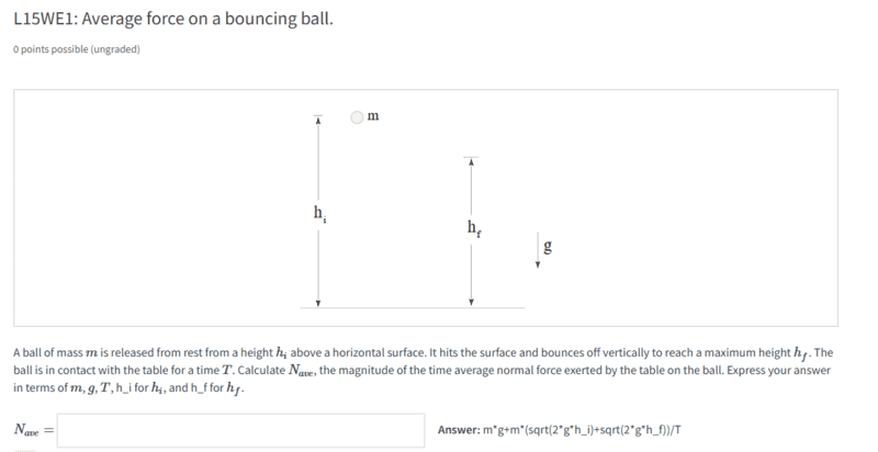

The statement is below.
Impulse is the time integral of force which is equal to the product of the average force with the change in time
What have mistakes/wrong assumption have I made in solving this question?
Diagram of a ball dropped from height h_i onto a table, rebounding to height h_f, with g pointing downward; below it is the prompt asking for N_ave in terms of m, g, T, h_i and h_f, and the answer field shows m*g+m*(sqrt(2*g*h_i)+sqrt(2*g*h_f))/T.
I tried to solve the problem this way
Handwritten-style derivation of average force: F_avg(t2 - t1) equals the integral from t1 to t2 of (N - mg) dt, then F_avg T equals N t2 - mg t2 minus (N t1 - mg t1), then (t2 - t1)N - (t2 - t1)mg, and finally F_avg T = TN - Tmg.
N.B. I assume that the j hat direction is up.
  • Diagram of a ball dropped from height h_i above a table, bouncing back to a lower height h_f, with a downward arrow labeled g; the problem text below asks for average normal force N_ave in terms of m, g, T, h_i and h_f, with a filled-in answer field.

First off you should put parentheses where they belong. So the starting equation should be
$$F_{\text{avg}}(t_2-t_1)=\int_{t_1}^{t_2}(N-mg)dt.$$ Missing parentheses is not a serious mistake. A more serious mistake is in the next line. Note that in the integrand ##mg## is constant, but the normal force ##N## is not and cannot be taken out of the integral, unless you meant to write ##N_{\text{avg}}## and not ##N##. Also, you need to figure out how to use the information that the ball starts at ##h_i## and bounces back up to ##h_{\!f}##. How do you think you could do that?

It is better to start from the definition of the average force $$F_{\text{avg}}=\frac{\int_{t_1}^{t_2}(N-mg)dt}{\int_{t_1}^{t_2}dt}=\frac{\int_{t_1}^{t_2}Ndt}{\int_{t_1}^{t_2}dt}-\frac{\int_{t_1}^{t_2}mg~dt}{\int_{t_1}^{t_2}dt}=N_{\text{avg}}-mg.$$ You don't need the time interval ##T##.

It did not. Your expression has ##N## not ##N_{\text{avg}}##. The two are not the same. You did not take an average, I did and showed you how it's done. So how will you proceed to find ##N_{\text{avg}}##?

There is a slight ambiguity in the question. It should specify that the time average is to be over the duration of the contact, not of the whole process.
Since it starts and ends with the ball stationary, the time average over the whole process is mg. That gives a way to find the average over the contact period, other than the more obvious way.

You have not attempted to use the heights information.
So I think to attempt to use the heights information I could use the kinematic formulae. However, I'm not sure how to relate the initial and finial heights to the force average. That's the issue.
It seems to me that you have missed the point entirely. You have no information about the force profile during the collision, so there is no point integrating the force at all.
What do the initial and final heights tell you in terms of physical quantities?

I think you are forgetting about the "other half" of the Impulse\Momentum definition.
Let me say the words that others dare not speak...
Impulse = change of momentum​

PeroK said:
Hint. Assume ##h_f =0##. How would you solve the problem then?
Ah. Thinking.
Ah. Thinking.
Hi @String theory guy. Since you are still working on this, and ‘tis the season of goodwill (for some), here is another hint.
Using ##h_i##, can you work out the velocity of the ball immediately before the bounce (i.e. immediately before initial contact of the ball and the surface)?
Using ##h_f##, can you work out the velocity of the ball immediately after the bounce (i.e. immediately after loss of contact between the ball and the surface)?
Can you now use this information? (if you can’t, re-read the posts).

It did say that the ball is in contact with the table for time T and T is supposed to be in the expression you come up with. As indicated by others we just need to calculate ##\frac {\Delta p}{\Delta t} ## with the denominator being T.

Ideally "someone" should be yourself! I think there are enough hints above for you to write an expression for the change in momentum ##\Delta p##. Then simply divide by contact time ##\Delta t##.

Equation F_avg = Δp / T, where F_avg is the average force, Δp is the change in momentum and T is the time interval.
Equation F_avg T = Δp, where F_avg is average force, T is time interval and Δp is change in momentum.
Equation in LaTeX-style typesetting: (N_avg - mg) T = m (v_f - v_i), relating average normal force and gravity to impulse and change in momentum.
  • Equation: F_avg Δt = Δp = m v_f − m v_i, relating average force times time interval to change in momentum.
haruspex said:
Ok, if I guess correctly how you are defining ##v_f, v_i##. But those are not allowed in the answer. So how to get rid of them?
Thanks, I see how they got their result now.
