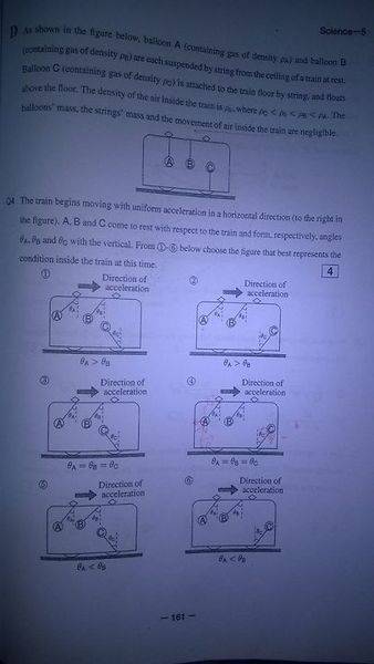

As show in the figure below, balloon A (containing gas of density ##ρ_A##) and balloon B (containing gas of density ##ρ_B##) are each suspended by string from the ceiling of a train at rest. Balloon C (containing gas of density ##ρ_C## is attached to the train floor by string, and floats above the floor. The density of the air is ##ρ_o##, where ##ρ_C<ρ_o<ρ_B<ρ_A##. The balloon's mass, the string's mass at the movement of air inside the train are negligible.
The train begins moving with uniform acceleration in a horzizontal direction (to the right in the figure). A, B, S come to rest with respect to the train and form, respectively, angles ##\theta_A;\theta_B;\theta_C## with the vertical. Choose the best represents the condition inside the train at this time.
F=-ma
$$tan \theta_A=\frac{g\rho_A V-g\rho_oV}{V\rho_Aa}$$
$$tan \theta_B=\frac{g\rho_B V-g\rho_oV}{V\rho_Ba}$$
Because ##\dfrac{\rho_A-\rho_o}{\rho _A}>\dfrac{\rho_B-\rho_o}{\rho _B}##
and I choose 1. But the answer is 4. Where is my wrong?

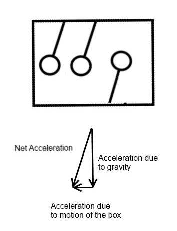

I think for most people it seems hard to believe that the helium balloon (or whatever gas it is using) would move in the direction that it does under acceleration of the vehicle. And probably the reason it is so counterintuitive is that everything we have seen that moves under acceleration of a vehicle moves in the opposite direction - including the direction our body tends to move, or something sitting loosely on the dashboard or on the floor.
I had wondered about this previously and had the opportunity to perform an experiment one time with a helium balloon in my car. It had a small weight attached to the string and I set it beside me as I was driving. It almost seemed a bit comical when the balloon leaned into the direction of the turn or leaned backward under braking and forward under acceleration - almost as if it was bracing itself for the normal movement that it was expecting.
An apple falls from a tree because it displaces the air that is less dense. Under acceleration, the air in the vehicle moves in the opposite direction of the acceleration because it displaces the less dense helium.

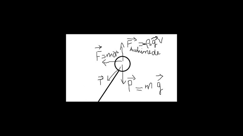

yes because ##\vec{P}+\vec{F}+\vec {F_a}## isn't equal ##\vec{T}##
Can you define ##\vec{P}##, ##\vec{F}##, ##\vec{F_a}## and ##\vec{T}## so that we know what physical inequality you are asserting? None of those variable names have been mentioned in the thread up to this point.

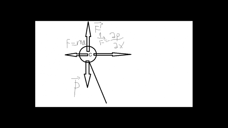

So Balloon C can't be equilibrium
As I read that drawing...
##\vec{T}## is the tension in the string pulling down and left.
##\vec{F}## is the leftward pseudo-force resulting from the use of the accelerating frame.
##\vec{F_a}## is the upward?! force arising from the pressure gradient in the air
##\vec{P}## is the downward force from gravity.
Which direction is the pressure gradient in the air?
Oh, I don't notice that pressure gradient in the air. But how 3 angels equal?

Ok, now I find the gradien of air
$$ [p (x)- p (x + dx)] S = ma = a \rho_0 dx$$
So ## \Delta p = -a \rho_0 \Delta x \Rightarrow \frac{\Delta p}{\Delta x}=-a\rho_0=const##
So 3 balloon are effected by equal force
The force by gradien of C balloon is larger than the force F=ma of its

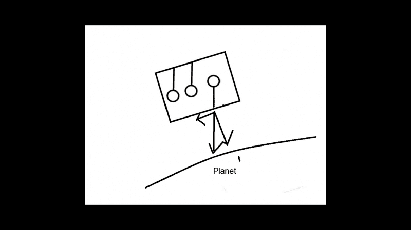

SO I have the figure
Define your variables before you put them into formulas.
Explain what physical principle motivates the formulas that you write down.
A verbal description would make it much easier to decipher the chicken scratchings above.

Because English isn't my national language that showing my idea in science language is very difficult. But I can understand your idea. And I tried showing my idea
Following your 10#
#13. Firstly I find the gradien pressure force effect to 3 balloon And prove that C balloon doesn't move.
Secondly I show that g' (is virtual gravity acceleration) is dependent with ##\dfrac{\rho_0}{\rho_i}## (i=A,B,C) so the 3 angles can't equal.
But I don't inderstand why angle A is equal angle B.

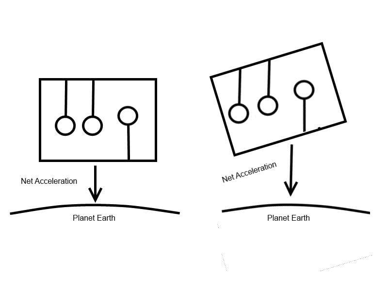

Have you considered what happens if (instead of accelerating the container) you simply rotate the container so that the net acceleration (just due to gravity) points in a different direction...
But the train moves horizontally with acceleration ##\vec{a}## and 3 balloon is effected by gravity and Achimede force
YEs, I understand what you say
It mean?

Gravity and the horizontal acceleration add together (vector add) to make a net acceleration.
The "Archimedes force" (buoyancy force) always acts in the opposite direction to the net acceleration.
One confusion that I see in #13 may be the idea that g' is a force. It is an acceleration, not a force. The density of the object being accelerated is irrelevant.
You seem resistant to the notion that we can lump ordinary gravity and the pseudo-force resulting from the acceleration of the car into a single force and call it gravity. So let us discard that approach. Instead, we will adopt an inertial frame of reference in which the car is accelerating rightward.
