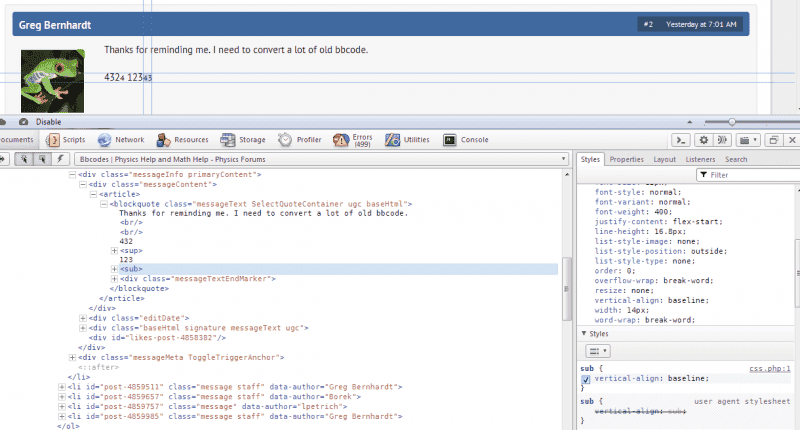

I've tried "sup" (superscript) and "sub" (subscript), and they make the text smaller but not raised or lowered:
x2 x2 x2

4324 12343
I did some testing it's completely bizarre. The source code look fine. I even tried different fonts and they all won't work. Perhaps there is some styling that is keeping everything in line.
I think
Code:
vertical-align: baseline;
is a culprit.
Seems like a problem with the CSS code for HTML tags <sup> and <sub>, which is what "sup" and "sub" get turned into. I tried both tags in a HTML sandbox site, and they worked properly.

Borek said:
is a culprit.
That makes some sense, but I don't see that being used for the message text styling. Do you see it?

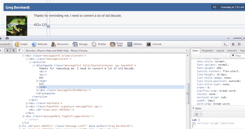

Greg Bernhardt said:
Do you see it?
In Opera Dragonfly it is listed as style of these characters, if I understand the situation correctly it is taken from the css.php file. Switching it (locally) off makes the subscript to drop below the baseline, see these two screenshots:
Strange that the sub and sup have properties. They must be inheriting them somehow. Anyway, I've explicitly defined them and they work. Nice job @Borek ! I'll make editor buttons for them later today.
