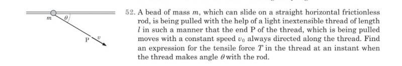

Pic attached below for reference
A bead of mass m, which can slide on a straight horizontal frictionless rod is being pulled by an ideal string of length ##l## such that the end P moved with velocity ##v_{0}## always directed along the thread.
Find an expression for the tensile force T in the thread at an instant when the thread makes an angle ##θ## with the rod.
##vcosθ## = ##v_{0}##
Along the vertical:
##mg## + ##Tsinθ## = ##N##
Along the horizontal:
##Tsinθ## = ##ma##
I know That the velocity of each particle of the thread along the thread must be ##v_{0}## since the thread is inextensible.
Now let's say the bead moves with some velocity ##v##
For the particle attached to the bead to move with a velocity ##v_{0}## along the thread:
##v##cos##θ##= ##v_{0}##
Is this inference right?
Though I'm not sure about the interplay of forces,
Along the vertical:
##Tsinθ## = ##ma##
And this is where I'm also confused.
If the string is taut, then there must be some force exerted by the string on the bead. If there is a force, then it must accelerate. But if it accelerates, then velocity of the thread can't be ##v_{0}## throughout. I seem to be add odds with myself.
Beyond this I'm completely blank. I absolutely don't know how to proceed. There's not a single approach that comes to mind.
Any Help is deeply appreciated.

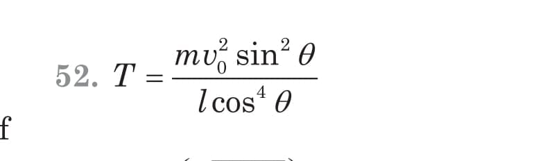

This is the answer given in the book:
There is a strong clue in the presence of ##l## in the answer. What equation can you write involving that?

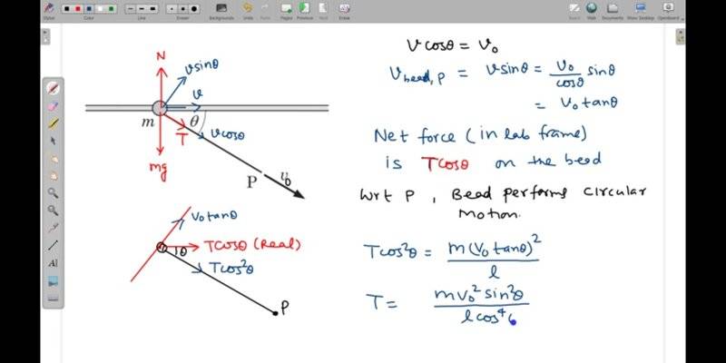

I finally solved the problem, so huge thanks to everyone in this thread. I just have one last query.
I came across a different approach to this question and I do understand that it should have been brought up earlier but I would deeply appreciate it if someone can clarify one point.
So the question is solved in the frame of P where the bead undergoes circular motion which is very confusing to me. The bead is constrained to move along the rod, so how can you assume it will undergo circular motion?

That's a completely different solution. That's the shortcut for getting ##v\cos \theta = v_0##.
P is accelerating, so I wouldn't be confident of that solution. I must admit I don't see how you can transform forces from an inertial frame to an accelerating frame in that way.
My solution is more straightforward - and, dare I say, more reliable. It's a real issue that you can't do it "my" way after all the hints and tips, because there was nothing conceptually challenging or tricky that way.
I'd be concerned that you are so far out of your depth, that even when look at the full solution, you don't understand it. It seems you were looking at both the clever book solution and my approach, but you can't ultimately do problems of this difficulty yourself?

No, You're mistaken. I vaguely remembered a similar problem (not the same problem) and just had in mind that the solution involved some complex frame manipulation and put it off. It's literally been months since that. Since I came across this question, i thought I would look up it and fortunately there was a solution for this problem though I wasn't aware of that at the time I made this post.
I deeply appreciate your answer since it is actually more straightforward and overall a better one in my opinion.
But since I made this post I thought I might as well clear up the confusion in the complex method just for the sake of knowing what it was.
When you change to an accelerating reference frame, you have to add a fictictious force to everything. Where is that done here? I don't understand why ##T\cos^2 \theta## works. Not without further analysis.
Here is the analysis. If we use my method, we see that the acceleration of ##P## is perpendicular to the string. I think you need this fact for the clever solution to work. When we add the fictitious force, that is perpendicular to the line between ##P## and ##m## and does not affect the centripetal acceleration.
You'd need to ask whoever came up with the clever solution whether they saw that - or whether they just got lucky.
The real net force on ##m## is ##T\cos \theta## along the line of the wire, hence ##T \cos^2 \theta## in the direction of P.; plus a component of ##T\cos \theta \sin \theta## perpendicular to the line between ##m## and ##P## - which again doesn't affect the centripetal acceleration.
From that, we know that ##T \cos^2 \theta## provides the centripetal acceleration in the frame of ##P## and the result follows.
Thanks for that. Also, if different criteria were specified for ##P##, then that approach would work. You would just equate the two expressions for the velocity of ##P##. No need for tricky accelerating reference frames.
