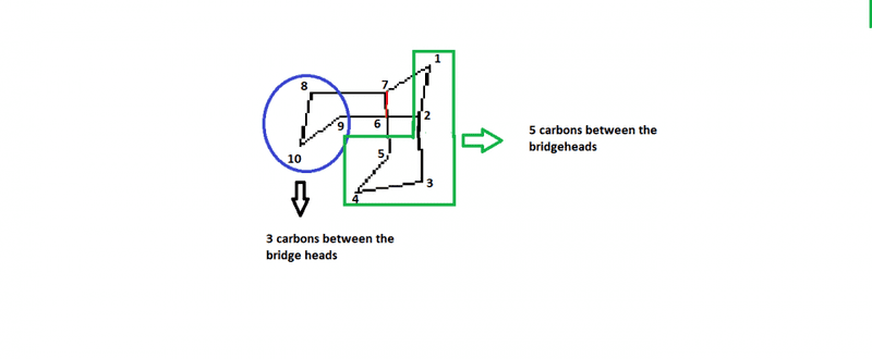

Name the following molecule by the IUPAC system of nomenclature.
There are some rules.
To name bicyclic alkanes, you follow these three steps:
1- Count the total number of carbons in the entire molecule. This is the parent name (eg. ten carbons in the system would be decane)
2-Count the number of carbons between the bridgeheads, then place in brackets in descending order. (eg. [2,2,1])
3-Place the word bicyclo at the beginning of the name.
[/B]

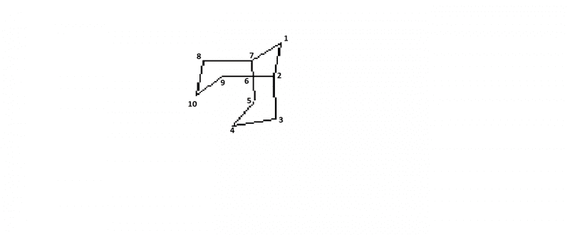

I numbered the given structure as follows
And I considered the red line to be bridge
And I named it as Bicyclo [5,3]Decane
But it is wrong . Answer is Bicyclo[3,3,1]nonane
There is no carbon 6. To draw this molecules to scale you can't avoid an accidental crossing of the lines on the picture. Bonds go like 2-9 and 5-7 using your numbering scheme.
You counted the atoms incorrectly. There is no atom where you wrote the number 6. The figure is not well drawn, so I can understand the confusion, but look at it as two cyclohexane molecules stuck together.
I did not understand.
There is no atom 6, there are no bonds 6-9, 6-7, 6-2 and 6-5. When you have something that is 3d, and you try to draw it on a flat surface of paper (which is always kind of projection), sometimes lines have to cross - but it doesn't mean they touch in the real molecule.
Where are bridgeheads in this case?
2 and 7.
I am confused. How to identify bridge heads?
They are the atoms that are part of the two rings.
