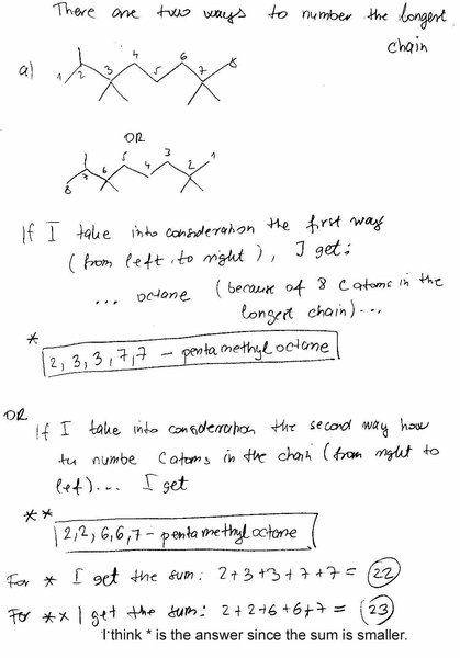

Name the following compound according to the IUPAC rules:
Skeletal structural formula labelled a), a branched alkane with a central chain of carbons carrying geminal methyl pairs on two carbons and a methyl branch at the upper left.
Handwritten notes numbering the longest carbon chain of a branched alkane two ways, left to right and right to left, with the resulting locant sums 22 and 23 compared.
Comment on my attempt, please.

CroSinus said:
Name the following compound according to the IUPAC rules:View attachment 228511
You select the end from which the more substituted carbon comes first. So which end is it?
Also, you don't need to do the sum for aliphatic compounds, that's only for cyclic compounds.
Strange rules. Would not be better if I took into consideration all substituents? In other words shouldn't I pay attention to the sum of all substituents?
Well, strange rules!
Thank you for helping me.
Cro
Actually, your doubt prompted me to do a bit of a search on it, and I'm astounded too.
https://chem.libretexts.org/LibreTexts/Athabasca_University/Chemistry_350:_Organic_Chemistry_I/Chapter_4:_Organic_Compounds:_Cycloalkanes_and_their_Stereochemistry/4.1_Naming_Cycloalkanes
http://www.chem.ucalgary.ca/courses/351/WebContent/orgnom/main/dontsum.html
Here, we have 2 articles, both from trusted sites, Chemistry LibreTexts and University of Calgary.
The first says that 'summing locants' is valid, while the other says that there is no such thing anywhere in the IUPAC nomenclature (even if we've been taught so elsewhere!) and also provides a valid justification for it.
Logically speaking, it makes sense that the higher priority substituent should get the lower number, and that should be it; which questions the validity of the 'lowest sum rule' altogether! The UCalgary standpoint appeals to me more.This needs attention from another expert. Discuss this anomaly with your professor
