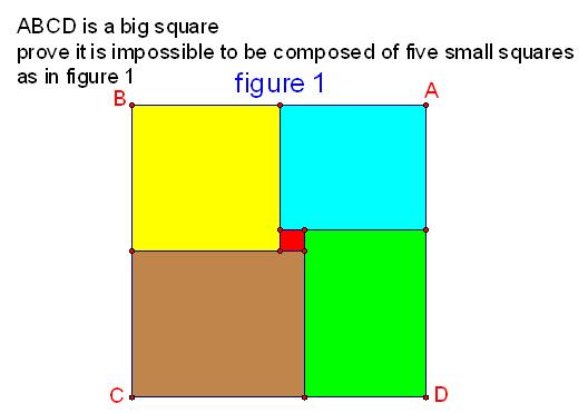

Big Square composed of Small Squares ?
Albert1
1,221
  • Diagram with corners labelled A, B, C and D, showing a near-square rectangle split into five squares: yellow top-left, cyan top-right, small red square in the centre, brown bottom-left and green bottom-right. Caption reads: ABCD is a big square; prove it is impossible to be composed of five small squares as in figure 1.
Hello, Albert!
Prove that it is impossible for a square to be composed
of five smaller square as shown.
Code:
         a       b
    a |     |         | b
      |     |   Q     |
      |    P*---*-----*
      *-----*---*R    |
      |     S   |     |
      |         |     | c
    d |         |     |
           d       c
The four outer squares have sides $a,b,c,d$ as shown.
The inner square is $PQRS$.We find that: .$\begin{Bmatrix}PQ \:=\:b-c \\ SR \:=\:d-a \end{Bmatrix} \quad \begin{Bmatrix}QR \:=\:c-d \\ PS \:=\:a-b \end{Bmatrix}$Since $PQ = SR\!:\:b-c \:=\:d-a \quad\Rightarrow\quad a+b-c-d \:=\:0\;\;[1]$
Since $PS =QR\!:\:a-b \:=\:c-d \quad\Rightarrow\quad a-b-c+d \:=\:0\;\;[2]$Add [1] and [2]: .$2a-2c\:=\:0 \quad\Rightarrow\quad a \:=\:c$
Subtract [1] and [2]: .$2b-2d \:=\:0 \quad\Rightarrow\quad b \:=\:d$Hence, the large square is divided into four congruent squares.
The inner square has zero area.
Still a square! (Tongueout)
The inner square has zero area. (Tongueout)
soroban :well done !
